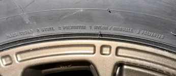

Can you take a photo of the ply & sidewall info off the tire?
For instance from my stock tires:
