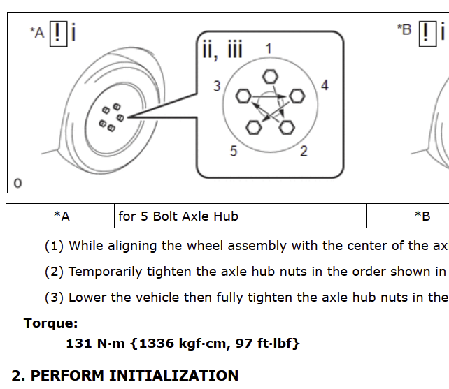

These being 14x1.5mm it is safe to assume lug nut torque spec is the same as 22-up Tundra 97ft/lbs
Where as other Toyota (ie 5th Gen 4R, 3rd Taco, GR Corolla)12x1.5mm is 76ft/lbs

Torque spec according to TIS is 97 ft-lb

Can you point me to where the 14x1.5mm bolt spec is documented? Can't find it anywhere in the manuals I have for the 2024 LC.
It isn't in the manual, but its a well known spec for the Tundra/Sequoia and the wheel lock/lug nut part numbers are the same between both platforms, so logically, the thread size and pitch has to be identical.
