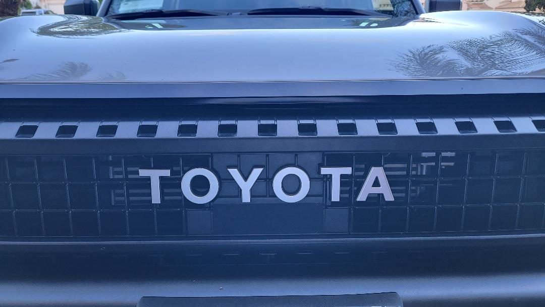

Question for everyone... IN the front grille I would like the chrome like(plastic) emblem "TOYOTA" Black. I called a Toyota dealer in San Diego, CA, and they told me that they do not have a black overlay for the front grille emblem TOYOTA.
I thought about going to Home Depot and buy a can of spray pain with a black mate spray paint.
.. Any suggestions?

Personally I like the Chrome Toyota lettering on the front grill, I'm on the verge of removing this Iforcemax badge though, Heat gun and dental floss all I need? how about the left over goo how can I remove that?
