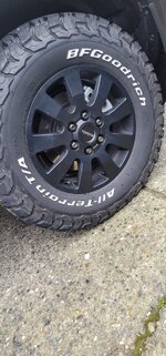

Indeed, Icon wheels look very nice in some designs. However, 18” OEM FE wheels are β€œhandsome” on their own characters and work β€œperfectly” with brake / clearance, especially, with 1” wheel spacers
I posted this photo in my mods, but bring up here directly (so you don’t look for it around) again to β€œprove” my point
β€œIcon wheel” people, please don’t throw rocks on me 😜
They look great with the tundra caps also!

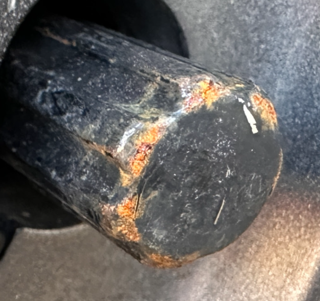

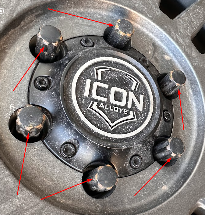

So, I purchased a set of #IconAlloys wheels immediately after I got my new LC back in July. I also purchase a set of black lug nuts from them. I installed the wheels and have rotateted them exactly one time in the 6 months I've owned them. I noticed the other day that each of the lug nuts is already showing significant amounts of rust.

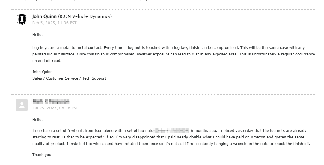

I reached out to Icon and got the response below:
Thank you Captain Obvious for telling me that lug nuts and keys are metal to metal and that weather exposure can lead to rust. So, I guess they expect me to put these lug nuts on a shelf in a climate controlled box? I don't know how I'm supposed to use this product without immediately compromising the integrity.
I bought a set of lug nuts off of Amazon for my LX570 that I had for 4+ years through many tire rotations, brake jobs, etc. that had less than half the rust showing on these so I was very disappointed. Am I expecting too much to not have the lug nuts I bought from "higher end" Icon Alloys rusting to this degree within 6 months? FYI, I had Icon wheels on my LX as well that had issues with the finish delaminating within a year of purchasing and when I complained I got a similar non-answer. I really thought long and hard about whether to buy Icon wheels again after my last experience but I thought "Hey, they are really popular so maybe my experience was just a fluke". I also understand that Icon is probably just sourcing the lug nuts from another vendor and not directly responsible for the manufacturing but they do label them as "Icon Alloys Lug Nuts". I would have hoped that they'd stand behind the products they sell, whether they manufacture them or not. This is giving me nervous thoughts about the wheels and how long they will continue to look good.
Does anyone know if lug nuts exist that are dark (black, gray, charcoal, etc.) but NOT painted?
Honestly, checking the weight specs on Ikons I figured the quality was
likely not high.
Sorry for your experience, but thanks for sharing. You’ve saved some people some pain.

Not sure about your lug nut question, but you can get sockets with plastic inserts, that don’t damage the lug nut finish. There are also lug nut caps you could put over silver lug nuts…this is more work though and it’s easy to lose the caps.

** Update. The black chrome Amazon specials that cost $23 for a set of 24 have held up extremely well (compared to the crappy Icon lug nuts) after 5 months and 2 tire rotations. If you are interested, here's a link.
FYI, the Amazon "part fitter" tool says they don't fit but they work fine.

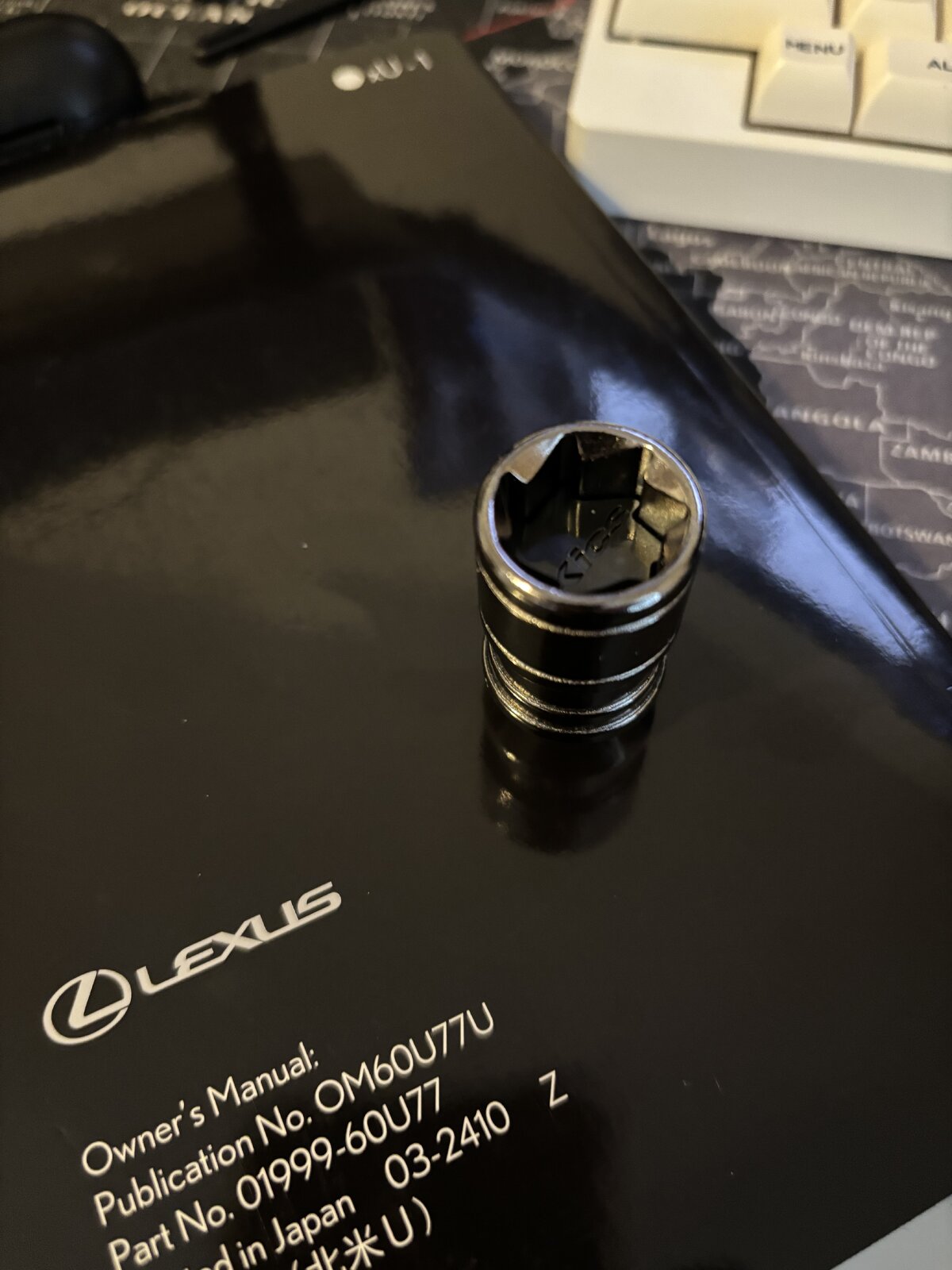

btw I went with project kics monolith lug nuts, haven’t installed them yet but every time I’ve used project kics they’ve been great View attachment 26475
Where did you purchase your Project Kics lug nuts? Any special specs other than M14x1.5?
I got them from RHDJapan.com - no special specs beyond size and color, they are open ended so you may want to purchase the plastic caps as well
