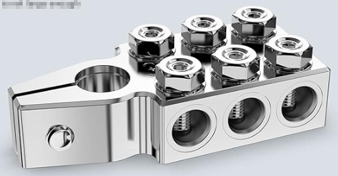

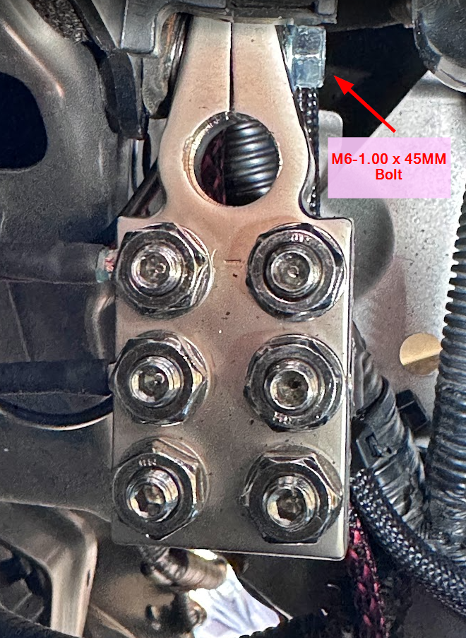

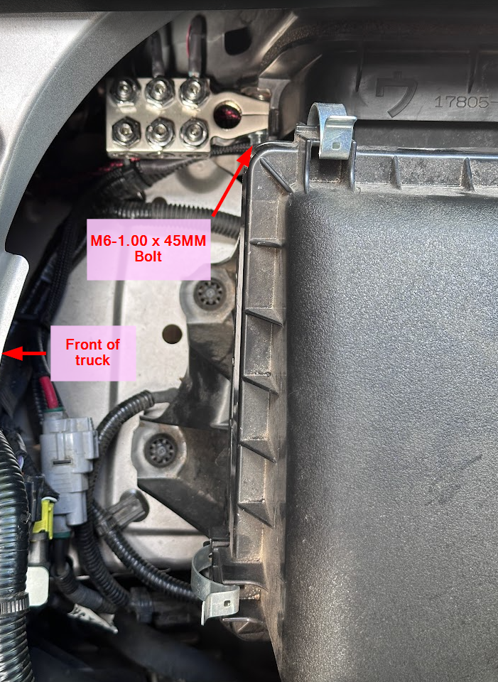

Installed an unorthodox ground/negative distribution block. Didn't want to get one of those standard power distribution blocks from Amazon that was like 6" long and require 2 bolts to hold in place. So, got this battery terminal clamp from Amazon instead that had 6 posts on top and 6 ports on the side for larger gauge wires:
Installed it by using a M6-1.00 x 45MM bolt to replace the OEM bolt that was holding the front, bottom "leg" of the air box. The bolt provides the electrical connection to the chassis and no need for a seperate wire from the chassis to the block.
Will probably not use it for any "high powered" but it works fine for my LED light bars and onboard air compressor.

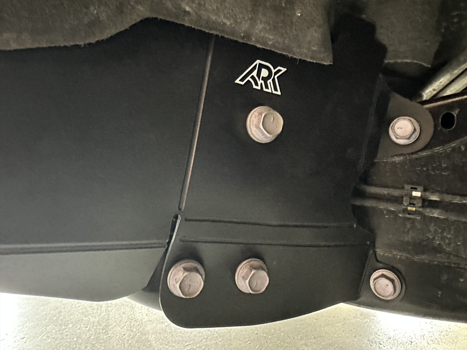

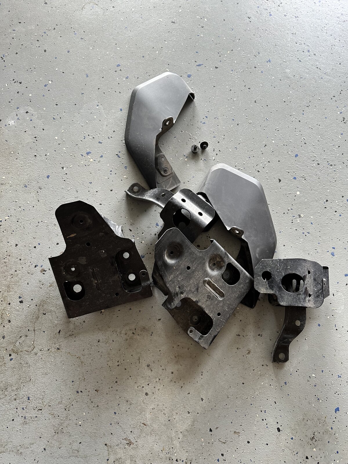

I took a bunch of parts off then added the Ark crash bracket delete to add a bit of extra room. Only down side is I can’t use the OE mud flaps so I ordered the Ark micro flares.

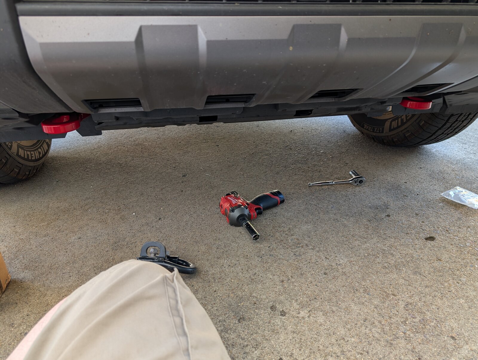

Added some red Victory 4x4 red recovery points to the LC today replacing the stock ones. I saw some other folks posting about this version and/or red ones and always want to add some to my Tacoma (maybe someday) but found the LC setup was easy and took all of like 10 minutes.
On a side note, I found another post mentioning ladders and saw this specific half-ladder: 2024 - 25 Toyota Land Cruiser/Prado 250 Rear Half Ladder | NashFabCo and was curious if anyone bought and installed it? The main reason why I'm interesting in it that the company also makes a dual-jerrycan holder that can be installed on it and that honestly is the main purpose I'm looking for it. There a few times that I go out to semi-remote spots and having a jerrycan of gas just gives me a bit of piece of mind so that the honest reason I'm leaning towards it. I'm not a fan of the rotopax/window mounts that I know a couple other companies make that connect to their roof racks (I have the OEM LC roof rack) which is why leaning towards this solution unless anyone done anything else potentially? Thanks!
