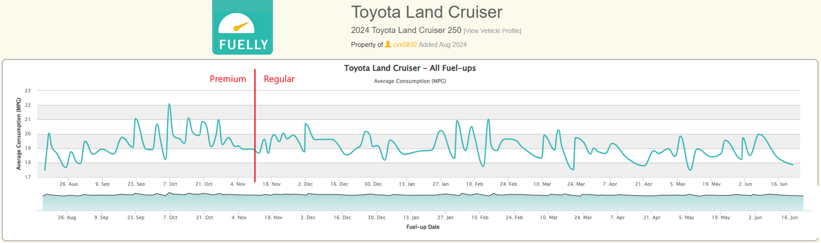

My data so far on this long term experiment
