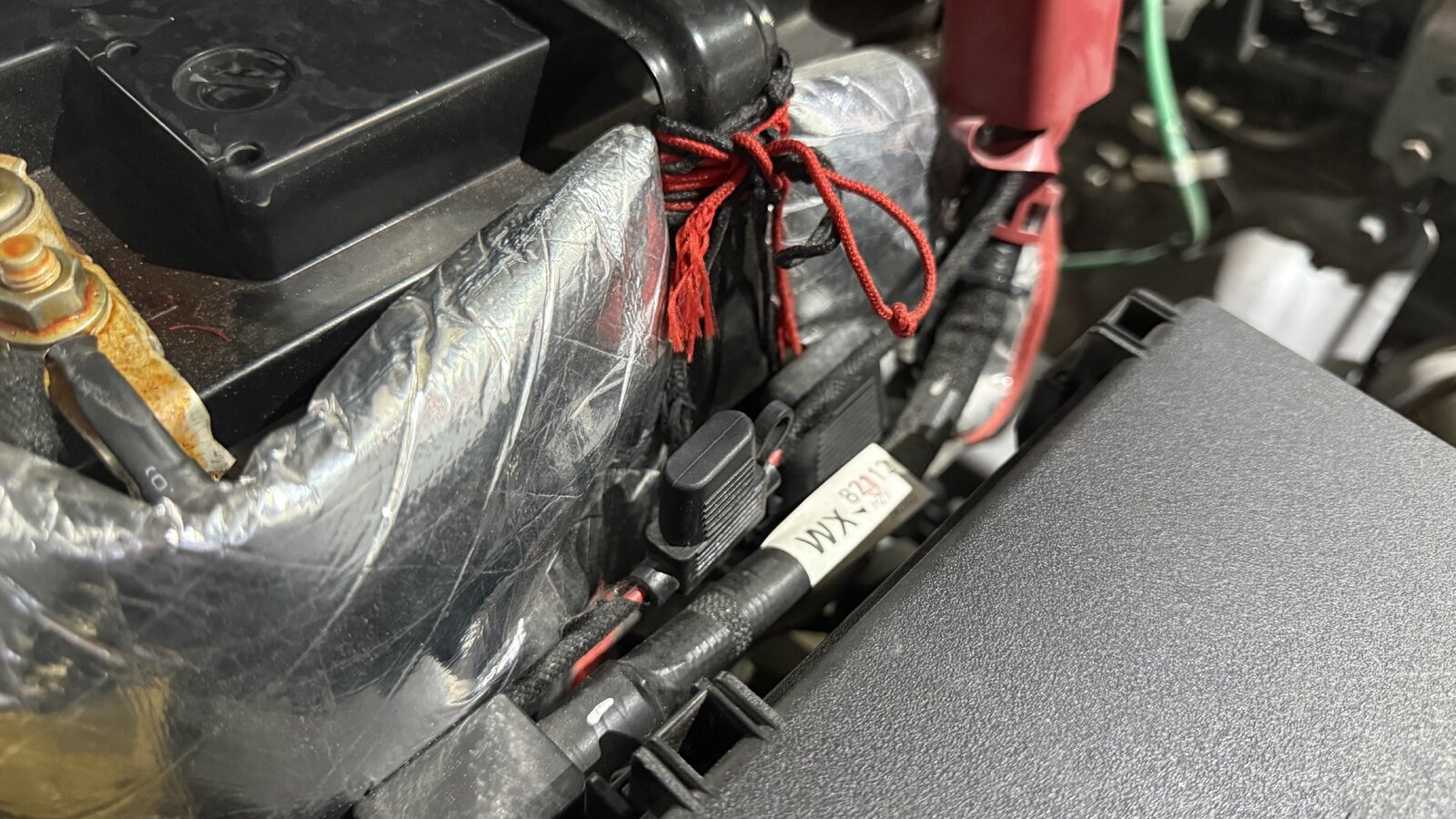

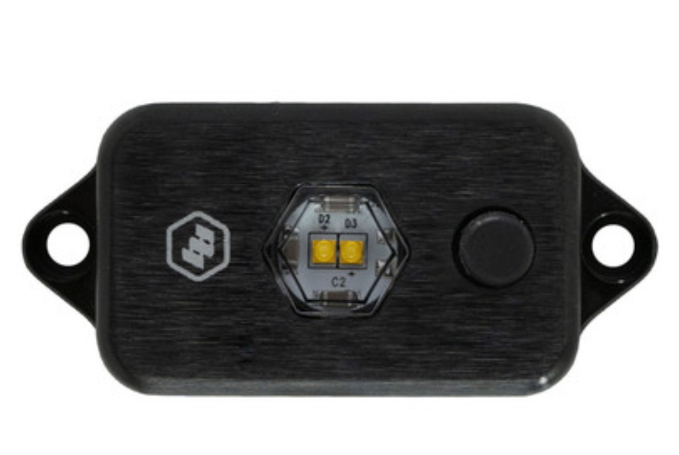

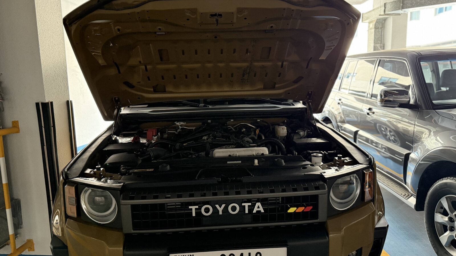

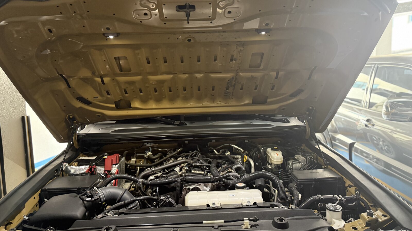

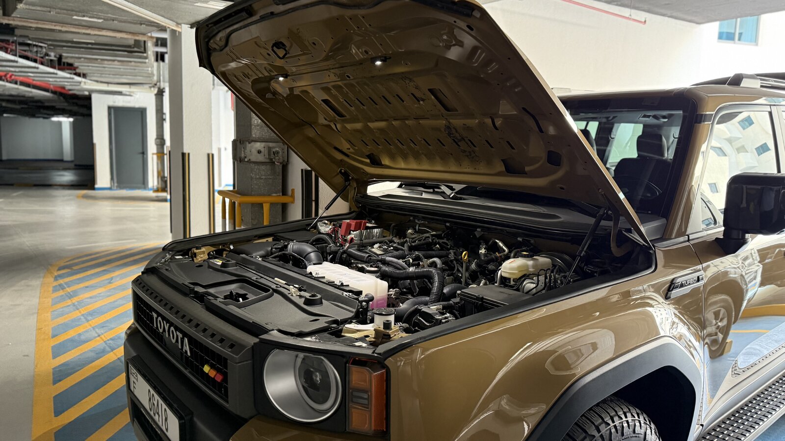

Installed the Baja Dome Lights under the hood for the engine bay. Simple Fix. One hour at most. Connecting the wires from the hood slots to the Main Battery with a built-in fuse. I didn't want to use a double-sided tape since it would get too hot because of the turbo engine dissipating heat. So, use a 2mm bolt to drill and bolt the lowest part of the hood. And its like daylight when switched on.

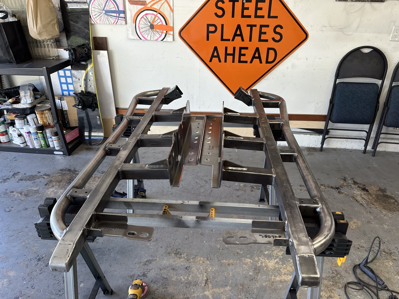

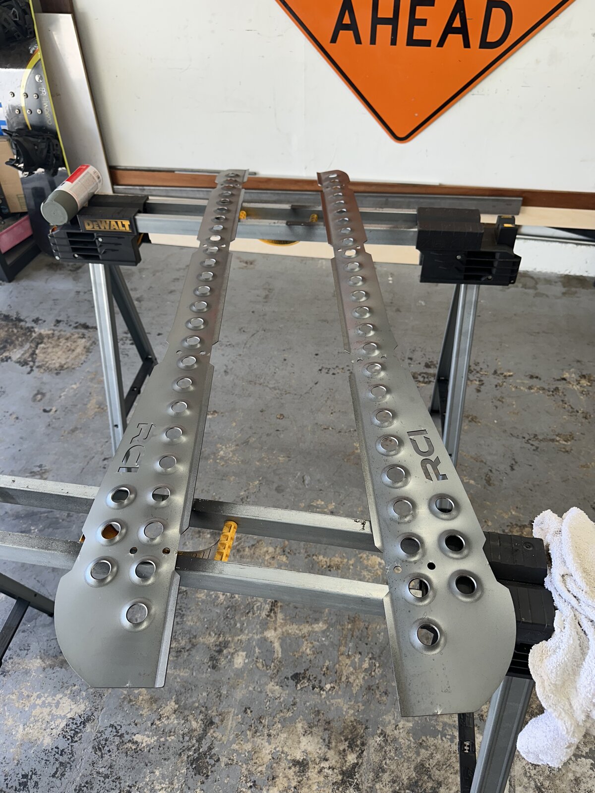

Started prep and priming my RCI sliders. Cleaned up a bit of the welds while I was at it. View attachment 41476View attachment 41477

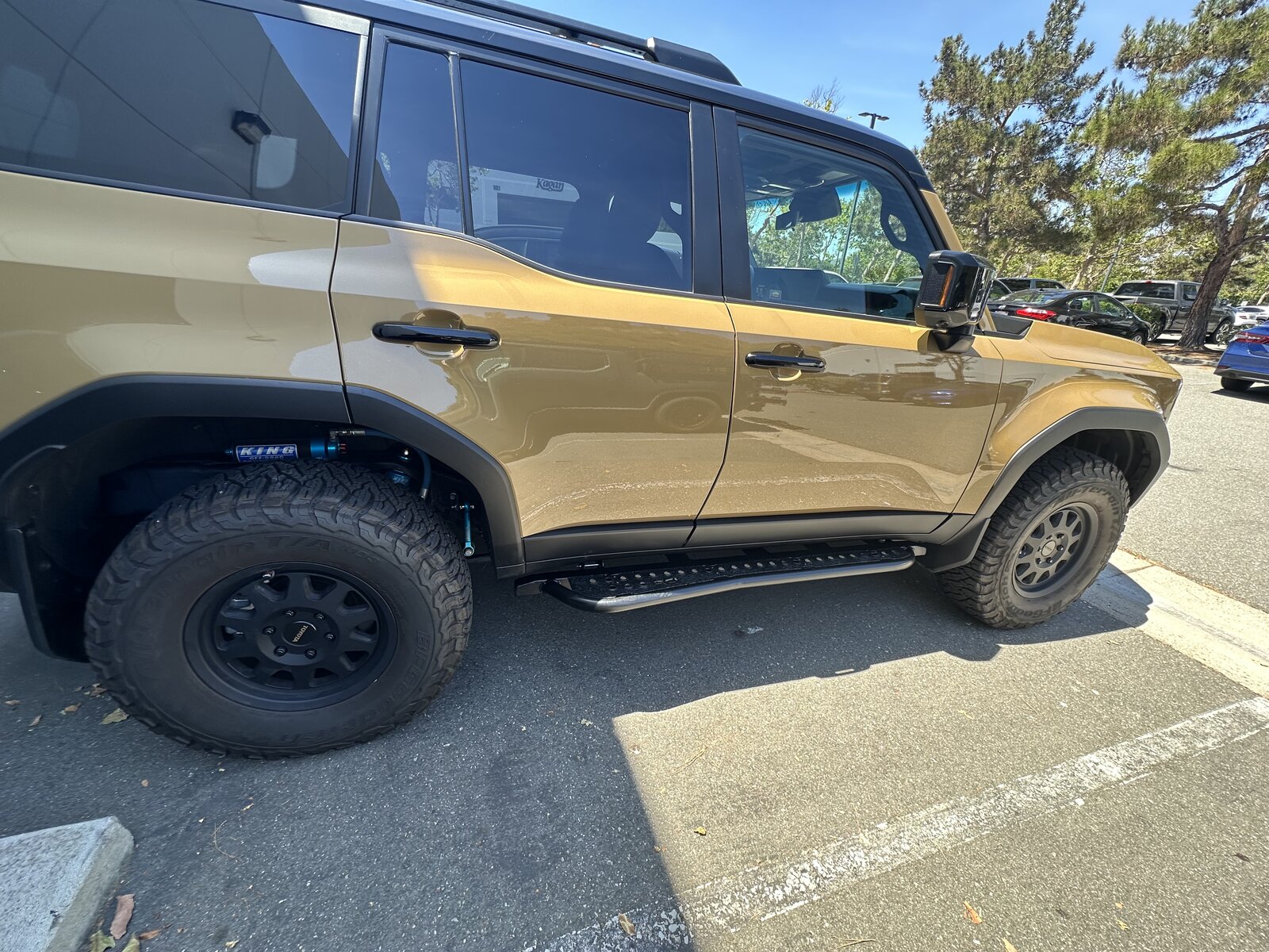

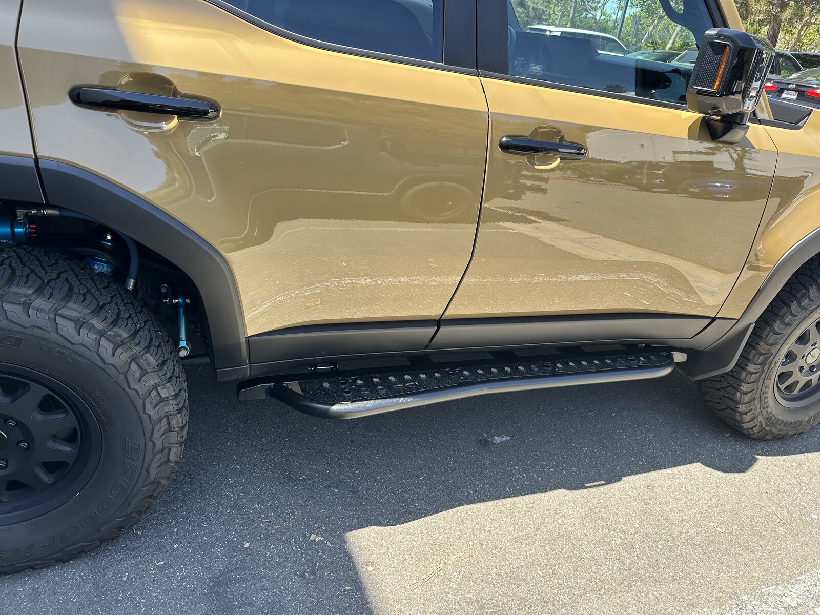

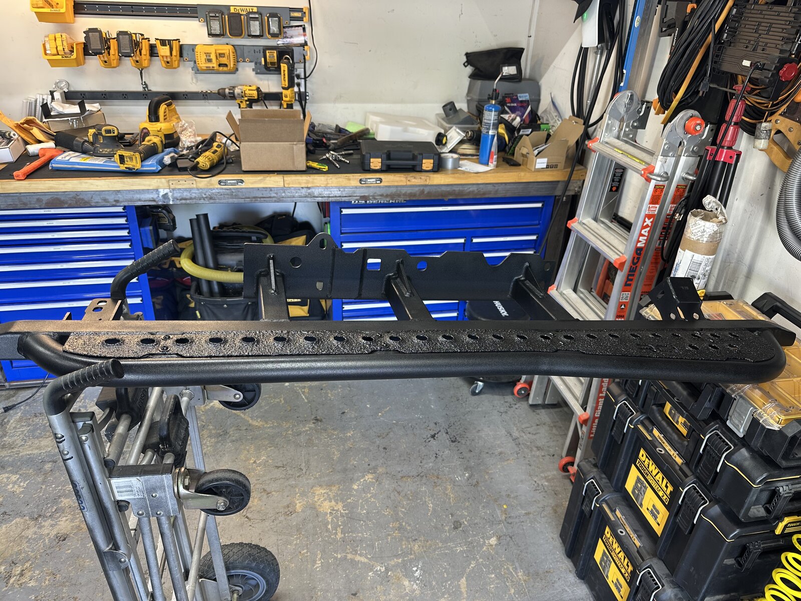

Got everything all painted and installed yesterday. I ordered the bare metal versions and I’m glad I did. The welds in a few areas were a bit much so I took those down. I’m also not a fan of repairing powder coat so I opted to paint them with Truck bed liner. I sprayed the bars and rolled to top plate to give it more slip resistance. I’m happy with the turnout.
Disregard my chaotic work bench, I have a few projects going on simultaneously.

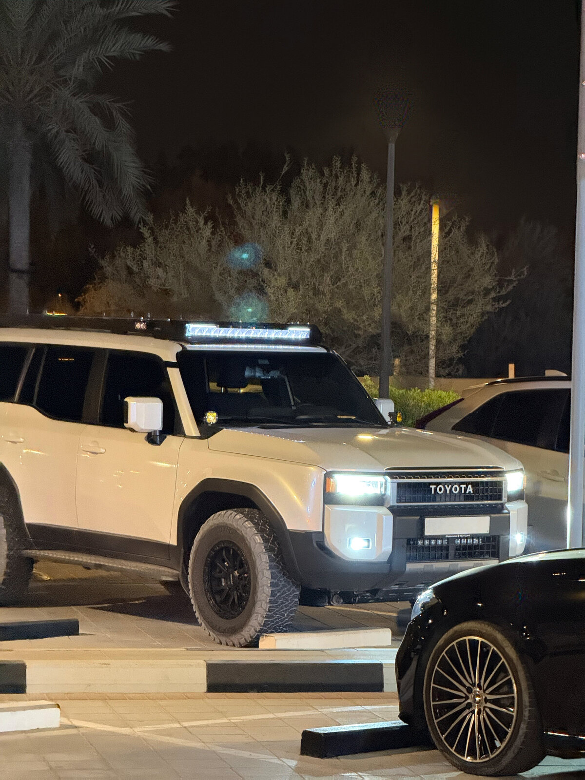

Added more light. installed a 40" Stedi ST2K Curved on the roof rack. This bar is aimed to light up the mid-long range scene and fits perfectly. little to no glare on the hood, in fact i get more glare from my pods thats aimed outwards than i do from the bar up top. I have attached a quick video of it in a residential area - but will be taking on the desert tomorrow night and will share some more shots then.

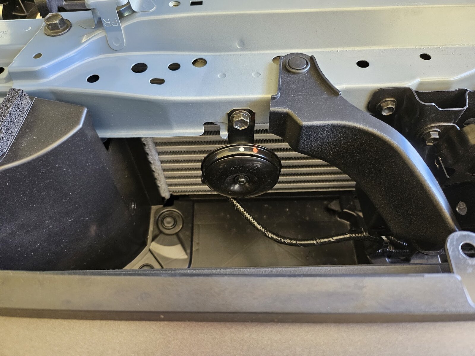

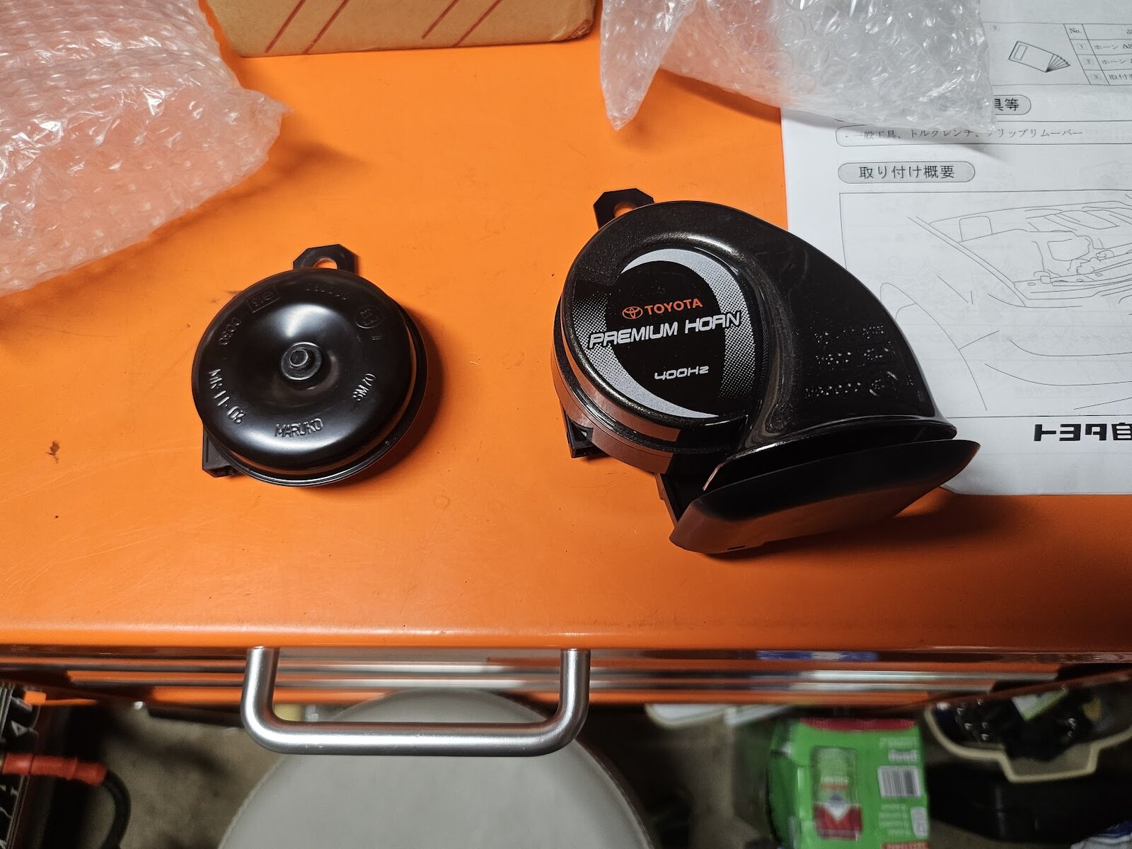

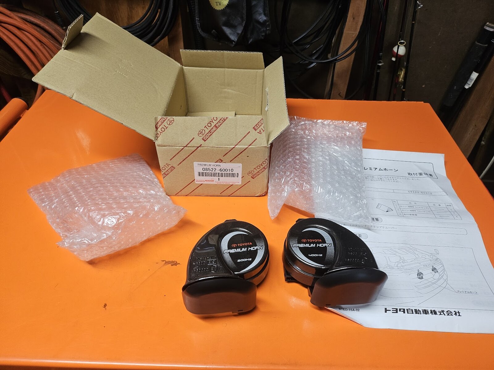

Installed my Premium horns (Toyota 08522-60010) today. Ordered on July4 from Japan, received them today, July 10. Total cost was $77.75 delivered on EBay. The install took about 15 minutes, only needing a 12mm socket. Sounds great, just what I wanted to hear. Pics below of old and new horns.
