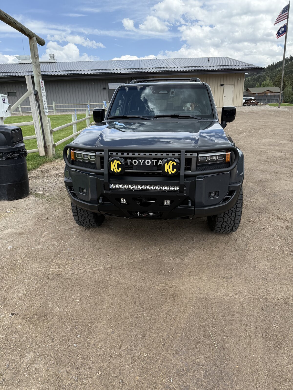

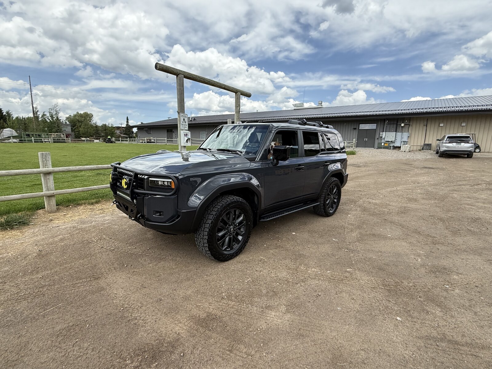

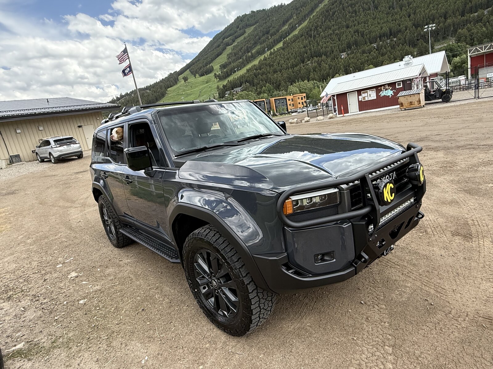

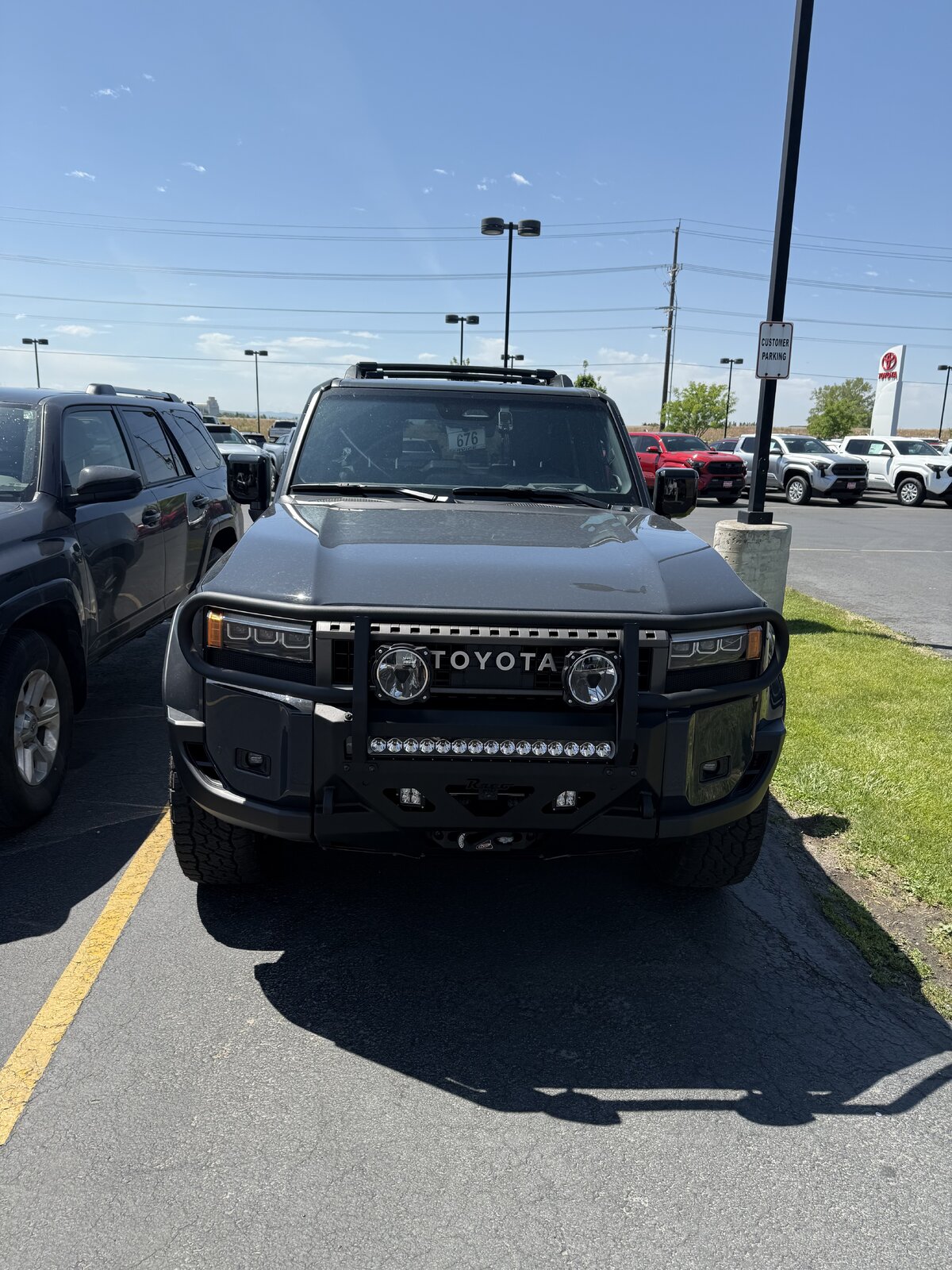

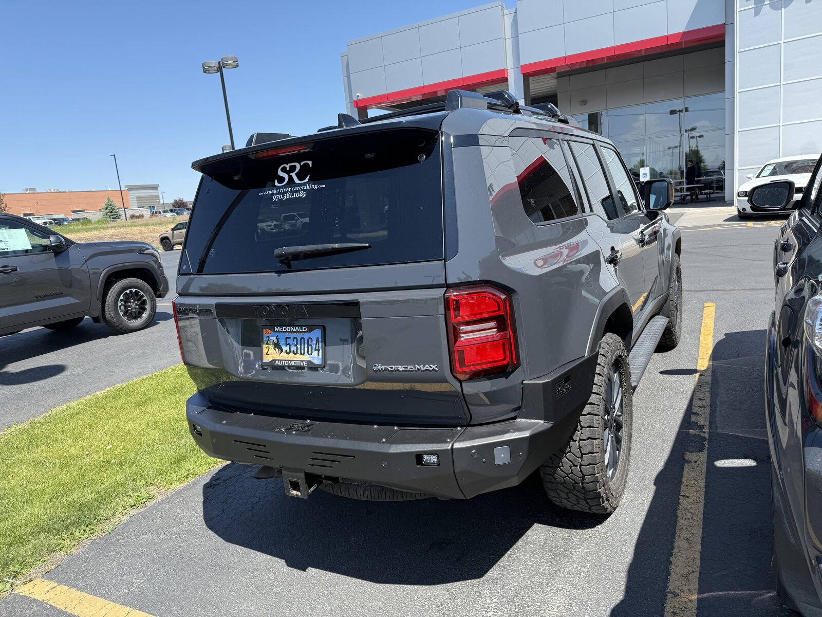

Added a few items. Rago front and rear bumper, 35 inch Falkien tires, Wescott pre collar lift, KC, Rigid lights up front, Wren Winch, and a few other toys.
