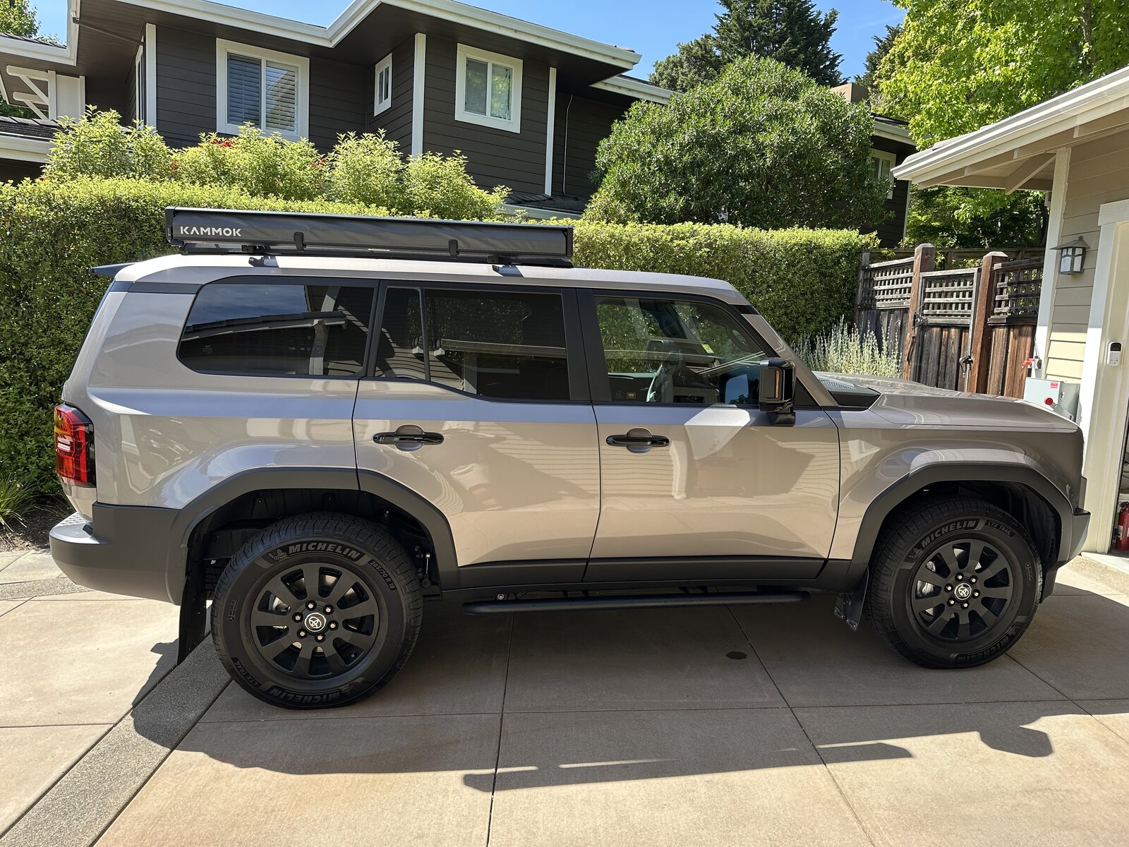

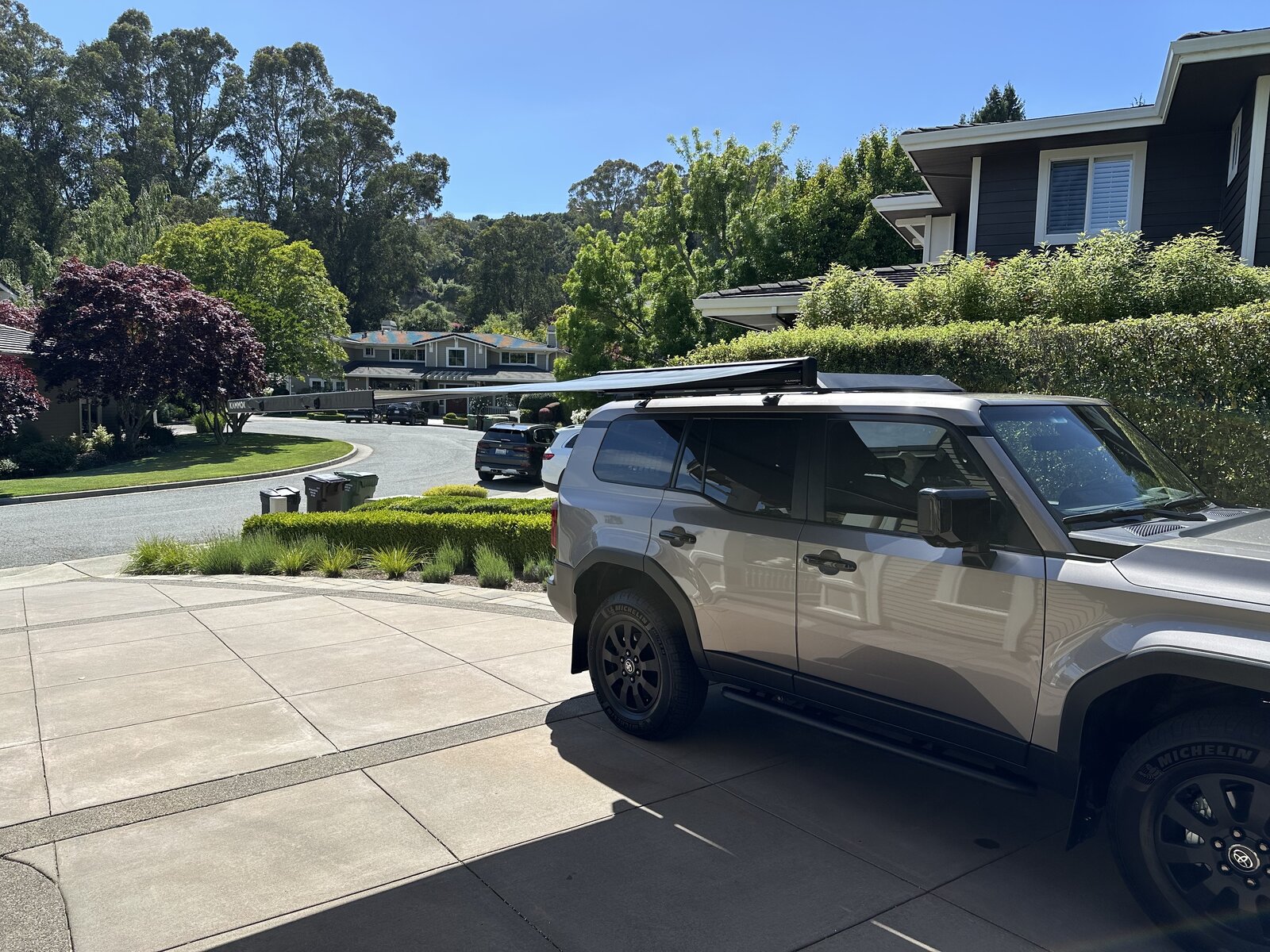

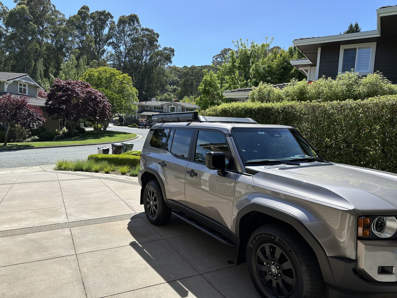

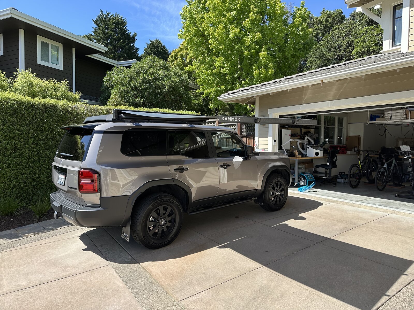

Added Kammok awning…side mount to keep it lower profile and not scrape in low parking garages. View attachment 36849View attachment 36850View attachment 36851View attachment 36852
We have the same one, the 7 footer. Super easy to deploy, and bit tricky sometimes to get back in. All in all, a great awning!!

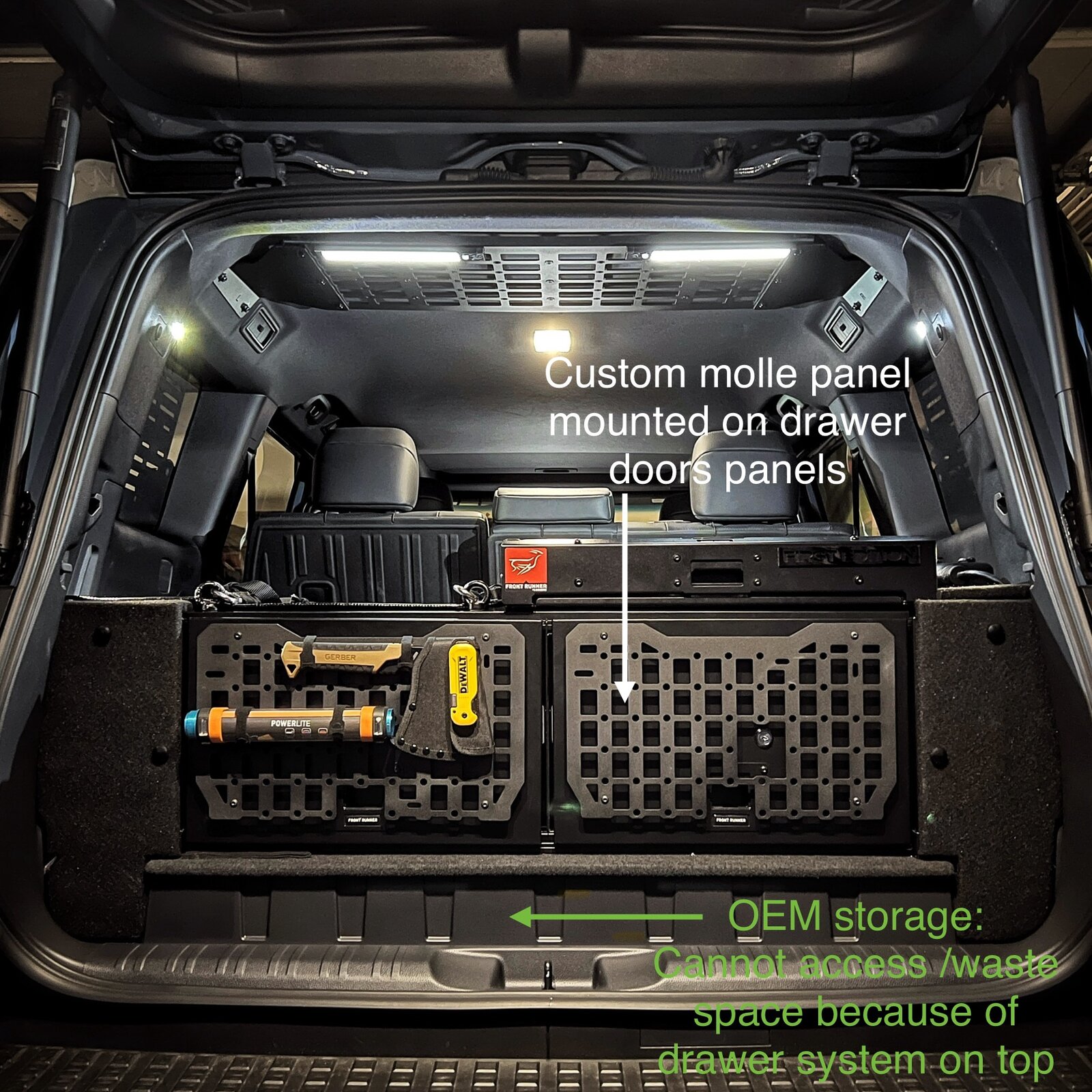

Car camping this weekend with a possible rain showers. I already bought passenger window mesh cover covers. However, with the overnight rain that is forecasted. I’ll have to wake up, close the windows and go back to sleep. So here is my prototype of the rear window mesh cover. View attachment 36816
Splendid work, can I ask you what what are those lights you used?
For other extremely output off-road lights, I spent thousands dollars for them ( you can see from my other posts)
However, these very-cheap lights serve very well for their purposes
Lights 2 side walls (dual white / amber):
At the ceiling molle panel, I want to have movable/ magnetic light bars which I can move around my LC , under the hood, or around camp site. Also, they are usb chargeable. I had 3 pairs of those laying around
Have fun with little project if you plan to do it

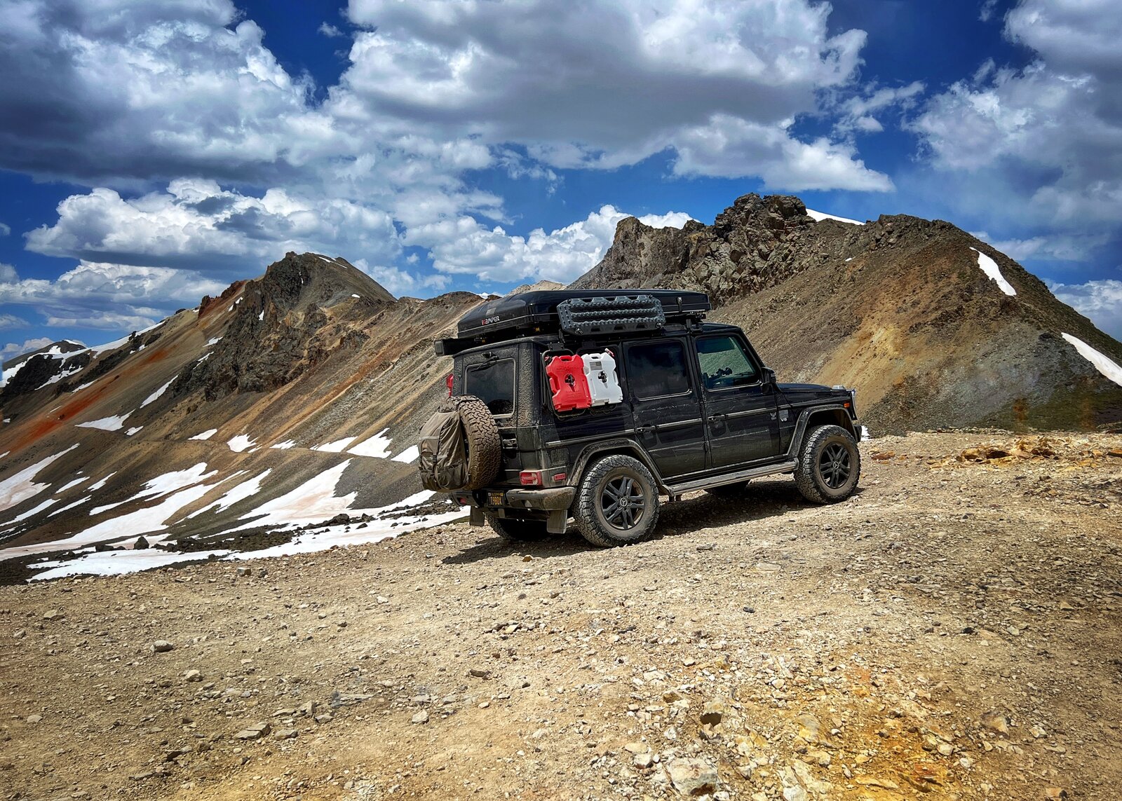

Similar setup as my G
This “recovery board” plate is used for all 3 options above. It can be dropped in and take off quickly with QD plate (my DIY QD + bracket)
How did you like your G? Is it a viable and reliable option instead of the LC?
I own both G and LC. I love them both and they are my “never- resale” toys.
G is number 1 (very viable, reliable, monster and stand-out from the crowds), but my LCFE (with over $25K upgrades ) is right behind called number 2 ;)
To me both are special and always give me smiles when “riding” them 😜 😜.
Speak out from the owner (not keyboard warriors) of both flat forms. With $100k budget, I studied and passed all GX550, X5-6, Defender, Bronco Raptor, Grenadier for LCFE. It’s my story and my taste ;)
Love 💕 my LC!
Love 💕 my LC!
