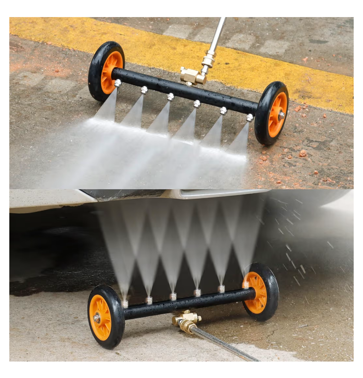

Its a game changer with the power washer, just makes life soo easy now.
Yes. I do the same thing with power washer (water and foam)and also use this after off-road trip to clean muds under the truck

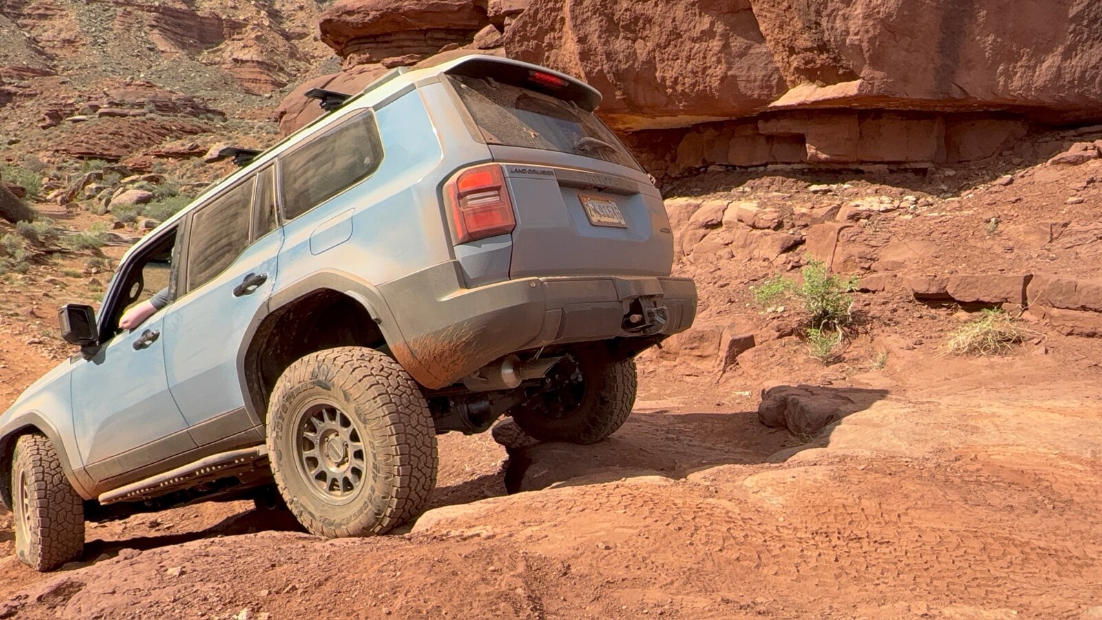

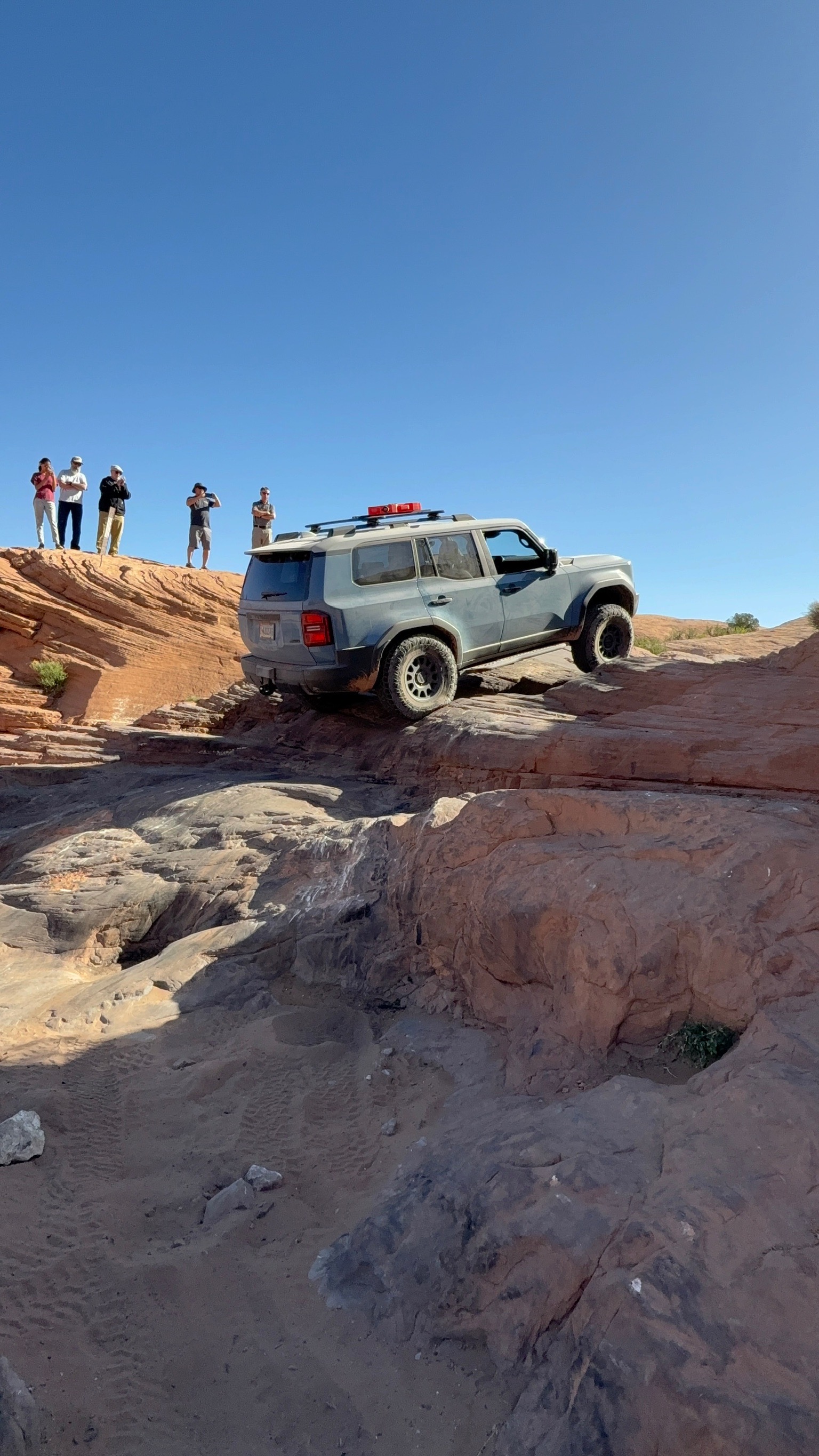

Any chance you could show a pic of the hitch slider installed on your LC? Would it actually provide any protection to the truck?

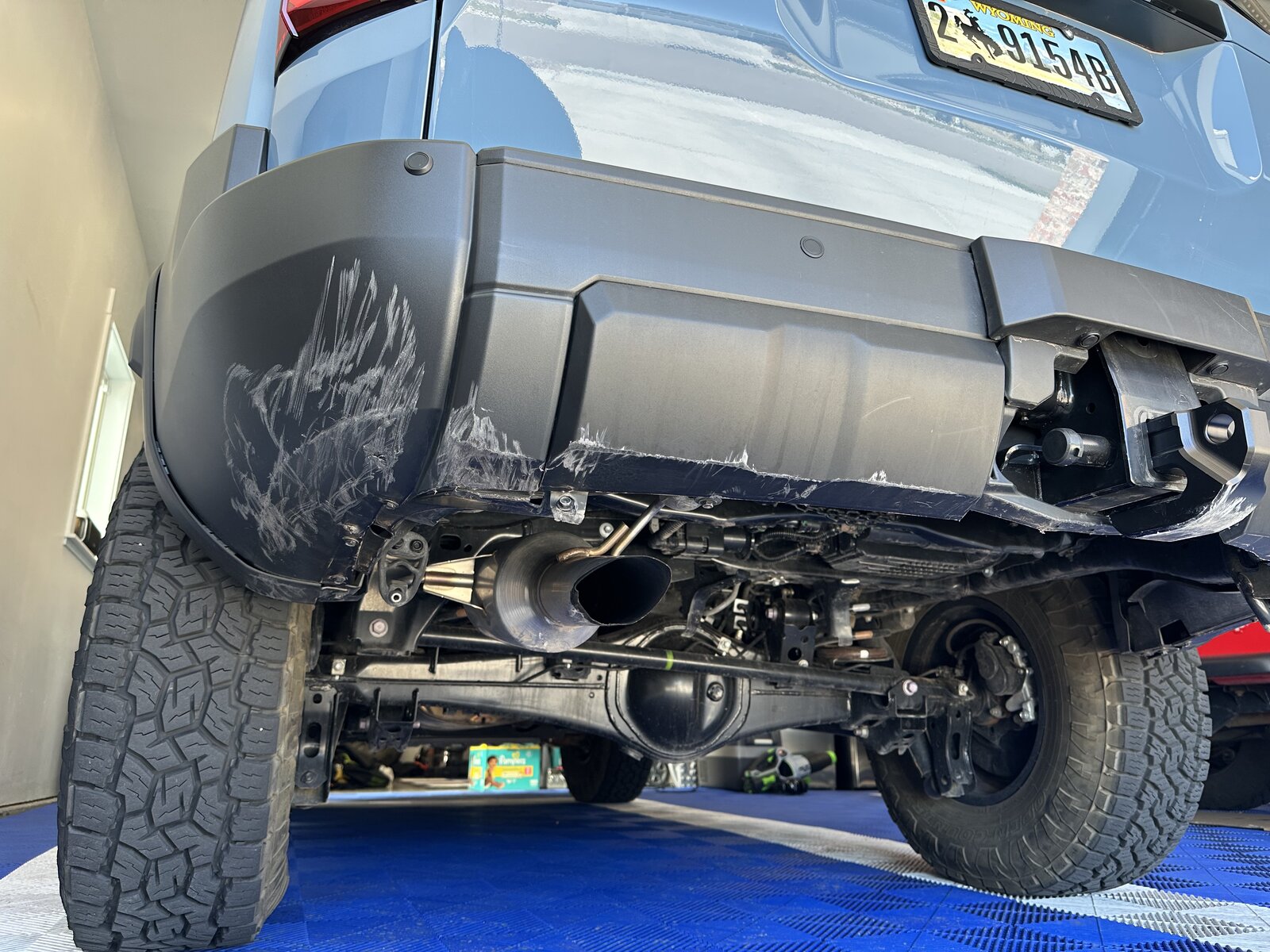

I bought one before a week in Moab. It definitely saved a few bumper hits. The hitch is up higher than the sides of the bumper so this hangs down slightly lower and obviously out farther so catch before other things. Exhaust tip and recovery point took some hits too. I was running 6/7 rated trails so still did damage but that was expected!
I bought one before a week in Moab. It definitely saved a few bumper hits. The hitch is up higher than the sides of the bumper so this hangs down slightly lower and obviously out farther so catch before other things. Exhaust tip and recovery point took some hits too. I was running 6/7 rated trails so still did damage but that was expected! View attachment 37148View attachment 37149View attachment 37150
Pretty cool! Need skid plates, man
Looks like you want to destroy the bumper so have reasons to replace by steel one ;)

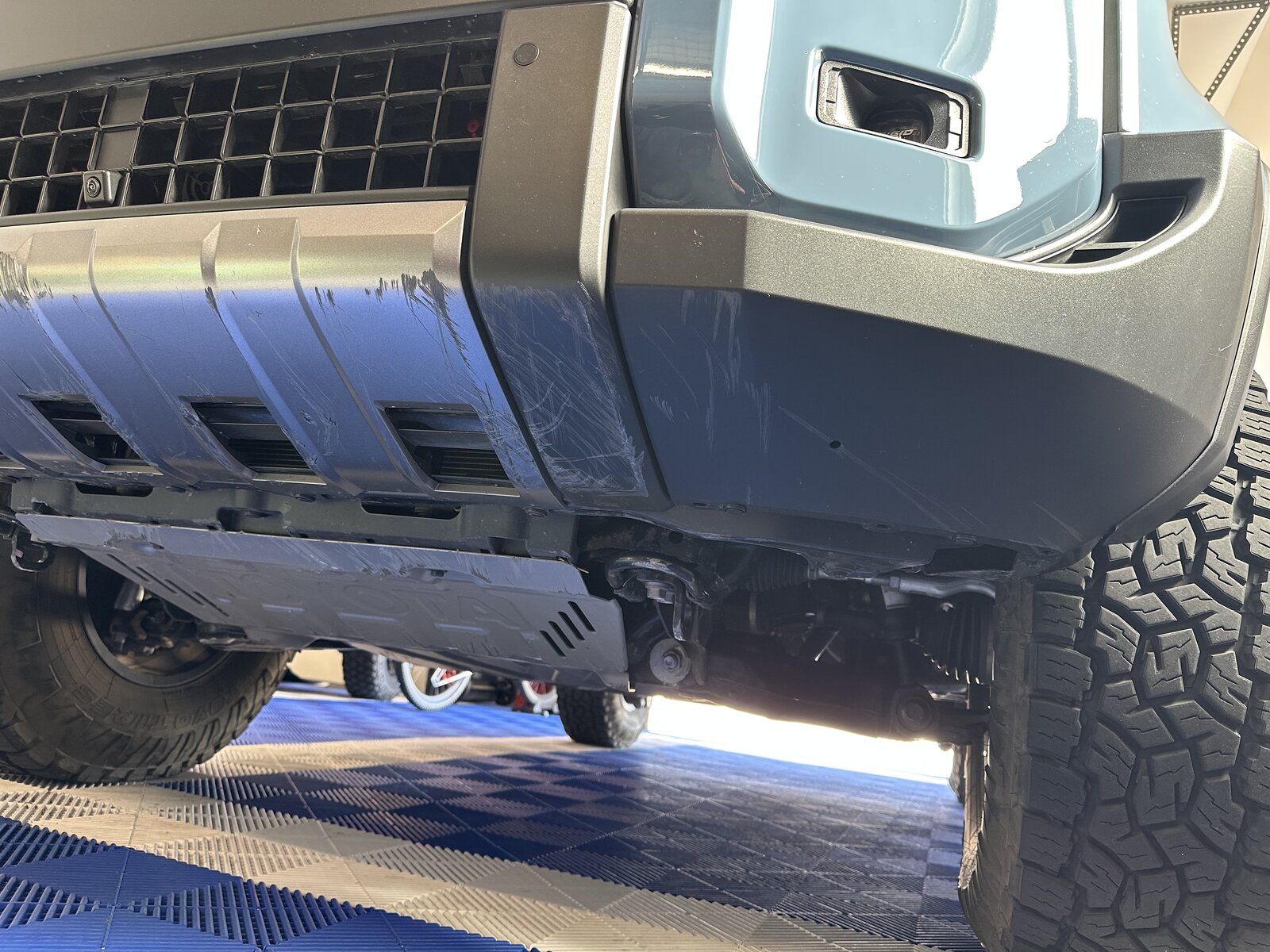

Just waiting for one I like. The plastic is easy enough to replace if I ever want to make it look nice again. I have full skid plates and sliders. It drags the belly a bit but that’s what skids are for. Waiting for front bumper too. Approach angle is actually not terrible.

Love the shots. I’m guessing you ended up needing to disconnect the sway bar?
It always helps. I disconnect it for any offroading. It’ll automatically connect if you go fast anyway. I’m on 35s and just a spacer lift. These are much more capable than most people probably realize. I didn’t stop to take many pictures but climbed all over.

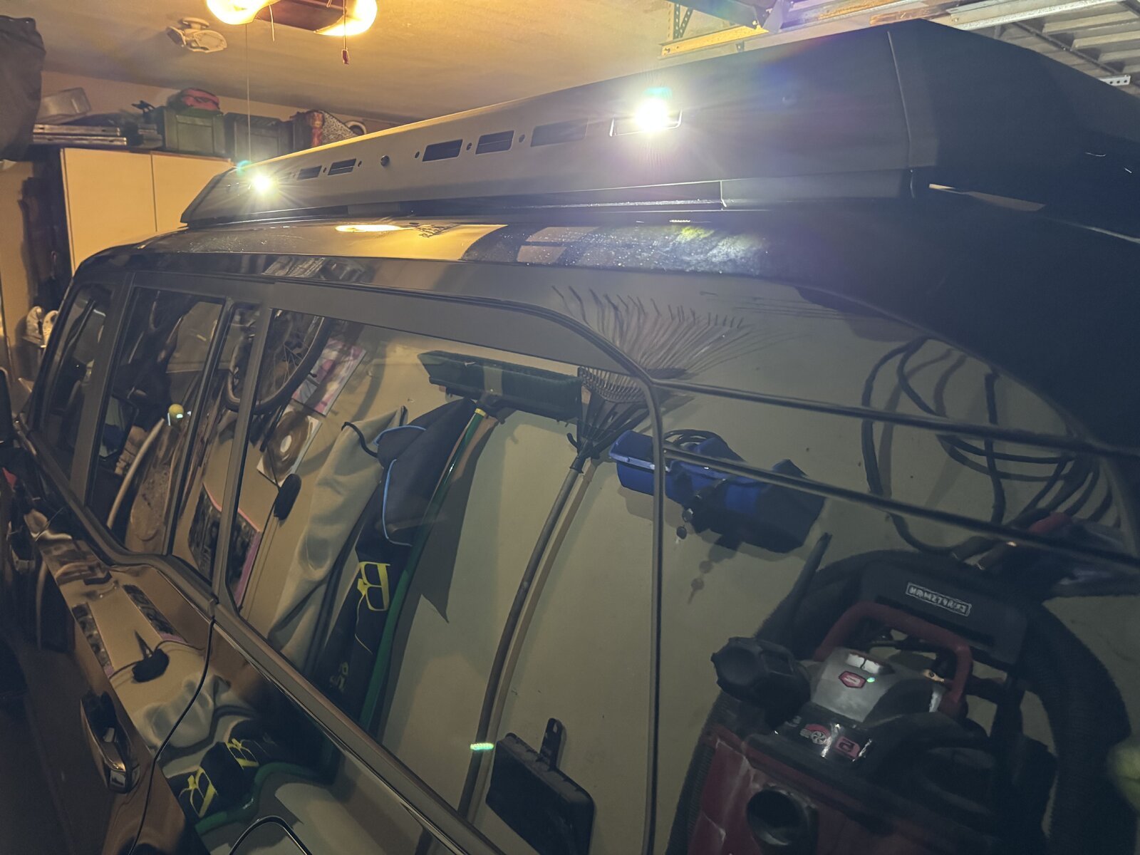

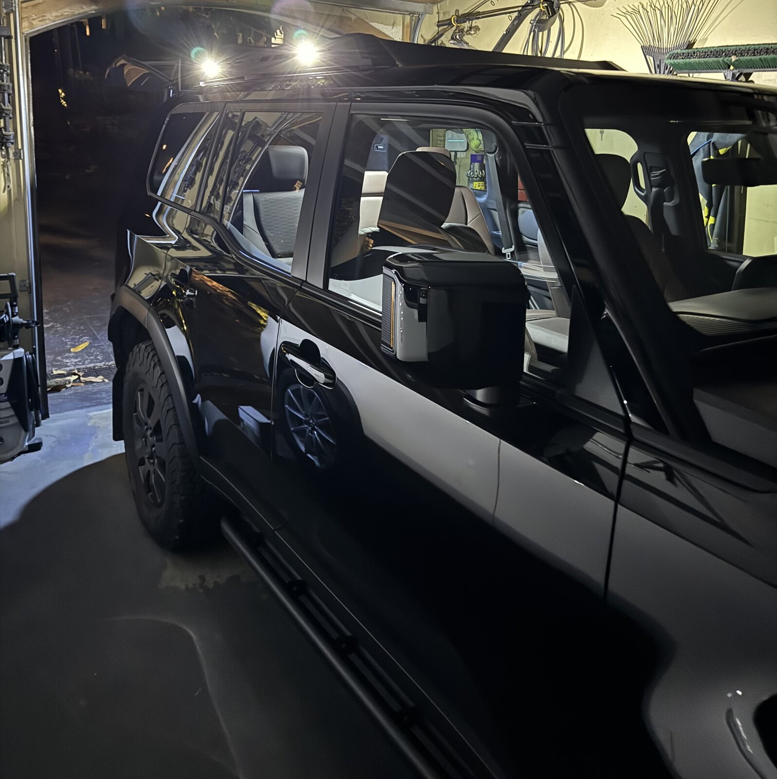

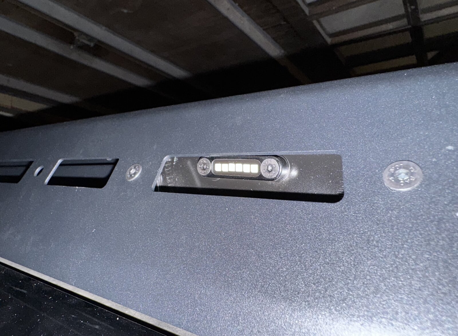

Roof rack hidden camp/work lights!!
Created some custom mounts hidden behind the cut outs on the sides of the OEM roof rack to mount some Dune Gear, micro LEDs. Ran the wiring around the rack and through the groove near the rear door. From there will plug into a relay and power off the main starter battery. Plan to wire these in to a CH4x4 OEM style switch on the dash in one of the blank areas. Will post more photos when complete.
View attachment 37282View attachment 37283View attachment 37284
This is awesome! This is exactly the low profile look I’m trying to get. S/O to PurelyAbrasive even helped me out as well. How many lunes are these lights? Mind providing a link to it?
