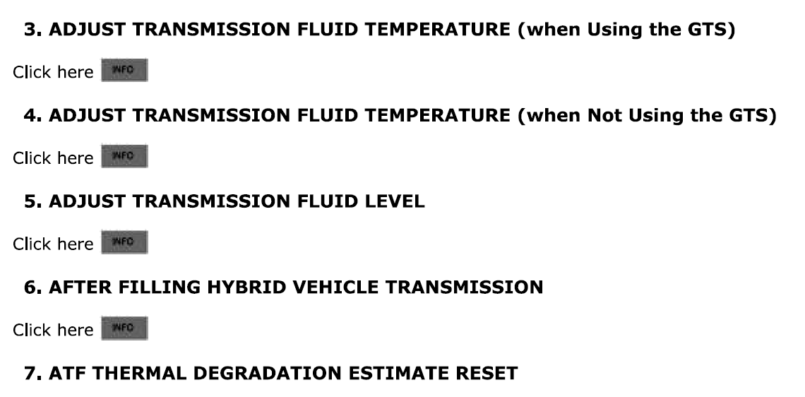

Has anyone done a transmission fluid change? I've seen the PDF posted on this site (attached), but as you can see towards the bottom that there are more pages that relate to temp and level. Does anyone have this? Thanks.

Looks like we got some interest. If anyone can pull up those missing guides, I'll make a guide by the weekend. Trying not to pay the TIS day fee if I can!

Circling back. Thank you to @EOD Guy - I appreciate the PDF you posted. It has the supplemental sections popped open which is needed to do this properly. Tip: If you're archiving these transmission docs, make sure you grab the more detailed one, which I also attached.
The process itself is described very well in the document. As good or even better than Mercedes' WIS in terms of details, and hammers out any ambiguity in the descriptions. So I'll keep this limited to things I learned and experienced outside of the provided document.
