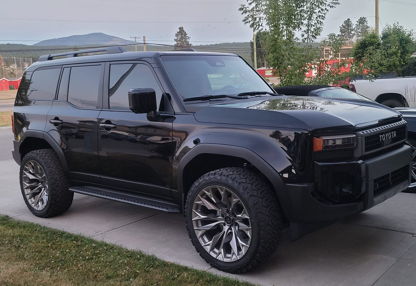

Just saw this on FB:
“Picked this one up- premium package, falken wild peak at4w 275/60/20. Very pleased.”
Those tires on these wheels look pretty nice.

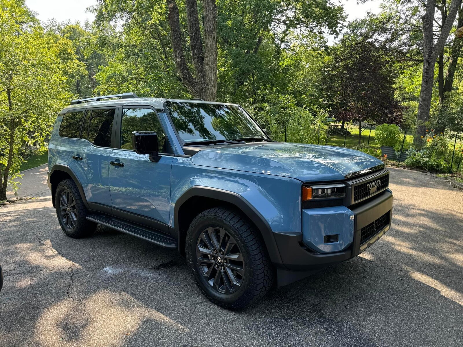

Went with Nokian Outpost nAT in 275/60 r20. Great so far, 1-2 mpg hit. Wish the wheels were lighter!
