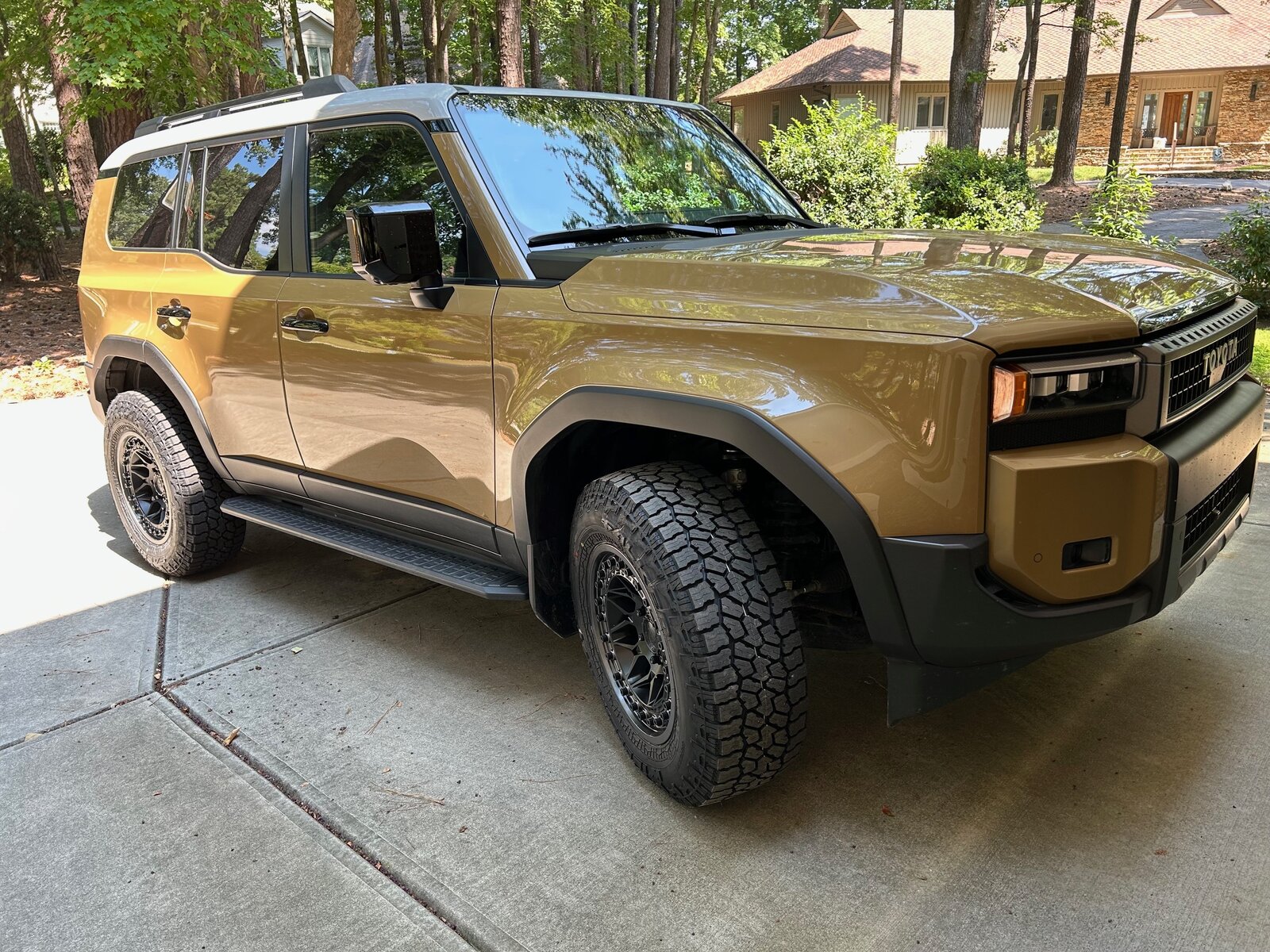

I just replaced my stock 20" Toyota wheels with 18" Black Rhino Alpha rims and Falken Wildpeak A/T4W tires. I really like the upgraded look. Here are particulars and pictures. Ordered through Discount Tire.
Tires - FALKEN WILDPEAK A/T4W 265 /70 R18 116T SL BSW
Rims - BLACK RHINO, Alpha, 18 X9 6-139.70 0 BKMTGL
Tire pressure monitors (Iโ€™m keeping my Toyota tires and rims, would like to sell) โ€“ Dill TPMS Sensor, DIL DIL 7007HP 71 315 Clamp-in 6YR/72K
No rub or other probs since about same fit as OEM.

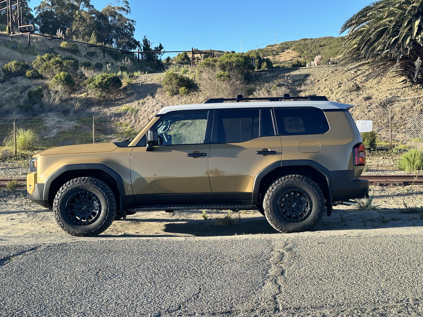

Looks like this is mostly looking at stock 18โ€ options. For anyone looking at 17โ€ options I found no fitment issues with my Method 305 17x8.5 +25mm offset wrapped in 285/70r17 KO3s. They are 32.7โ€ in diameter. Iโ€™m tempted to try going up a size to 285/75r17 that are just under 34โ€, Iโ€™ve seen some cars use these on stock suspension.
