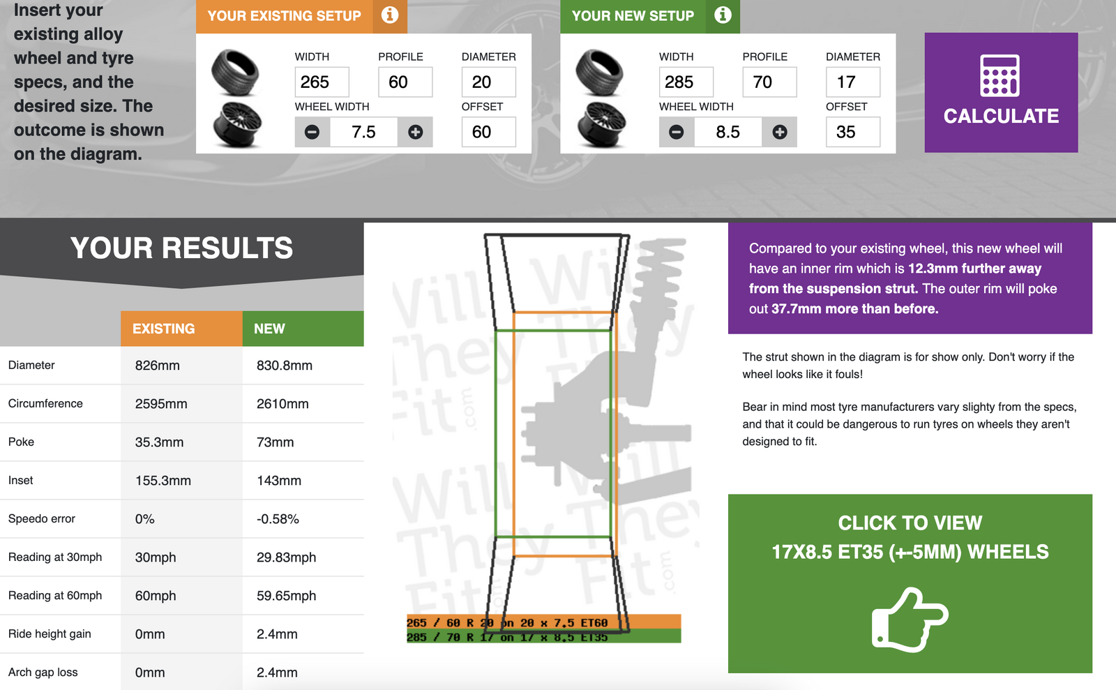

Not as wide as you think. The rims are 25 cm wider, so they’ll only push out about 1.5” wider than the stock tires. With the wider tire, I’ll need the extra offset to clear the inside of the fender and steering components. I think +35 or + 40 are just about perfect for 285s. I’ll post pics when I put the new boots on the truck.

The pic below shows calculations to determine how the offset and rim width change the overall position of the wheel relative to the suspension (for a 285/70R17 +35 on 8.5" width rim). The additional poke is 37.7 mm (or 1.48") when compared to the stock 20" wheel. So, the new tire will still be under the fender. The only thing that changes if I go to the 285/75R17 is the overall diameter of the wheel.

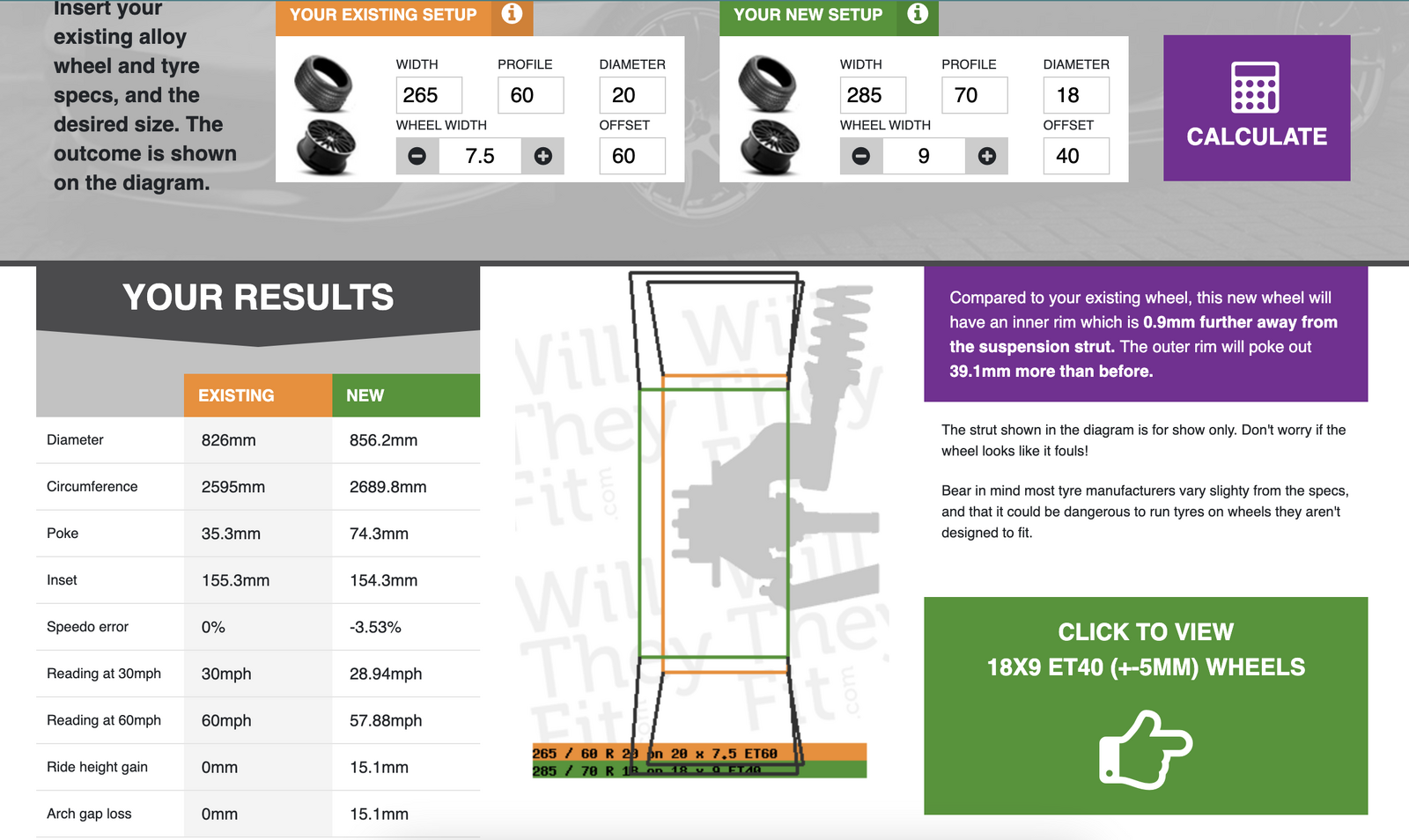

If I would've chosen the Method 708 (+40 offset, 9" wide rim), the actual poke would be 39.1 mm which is more than I'd see with the +35 offset/8.5" rim on the 703s. The calculated values are shown in the second picture.
Here is a link to the offset calculator and wheel comparison: Alloy Wheel & Tyre Fitment Calculator. Offset, Tyre Stretch and Speedo Error | Will They Fit
Here is the formula to calculate the difference in Poke (width of wheel in inches, offset in mm):
(width of new wheel - width of old wheel)/2*25.4 + (offset of old wheel - offset of new wheel)=change in poke
For the 703:
(8.5-7.5)/2*25.4 + (60-35) = +37.7 mm (1.48") additional poke
For the 708:
(9.0-7.5)/2*25.4 + (60-40) = +39.05 mm (1.54") additional poke

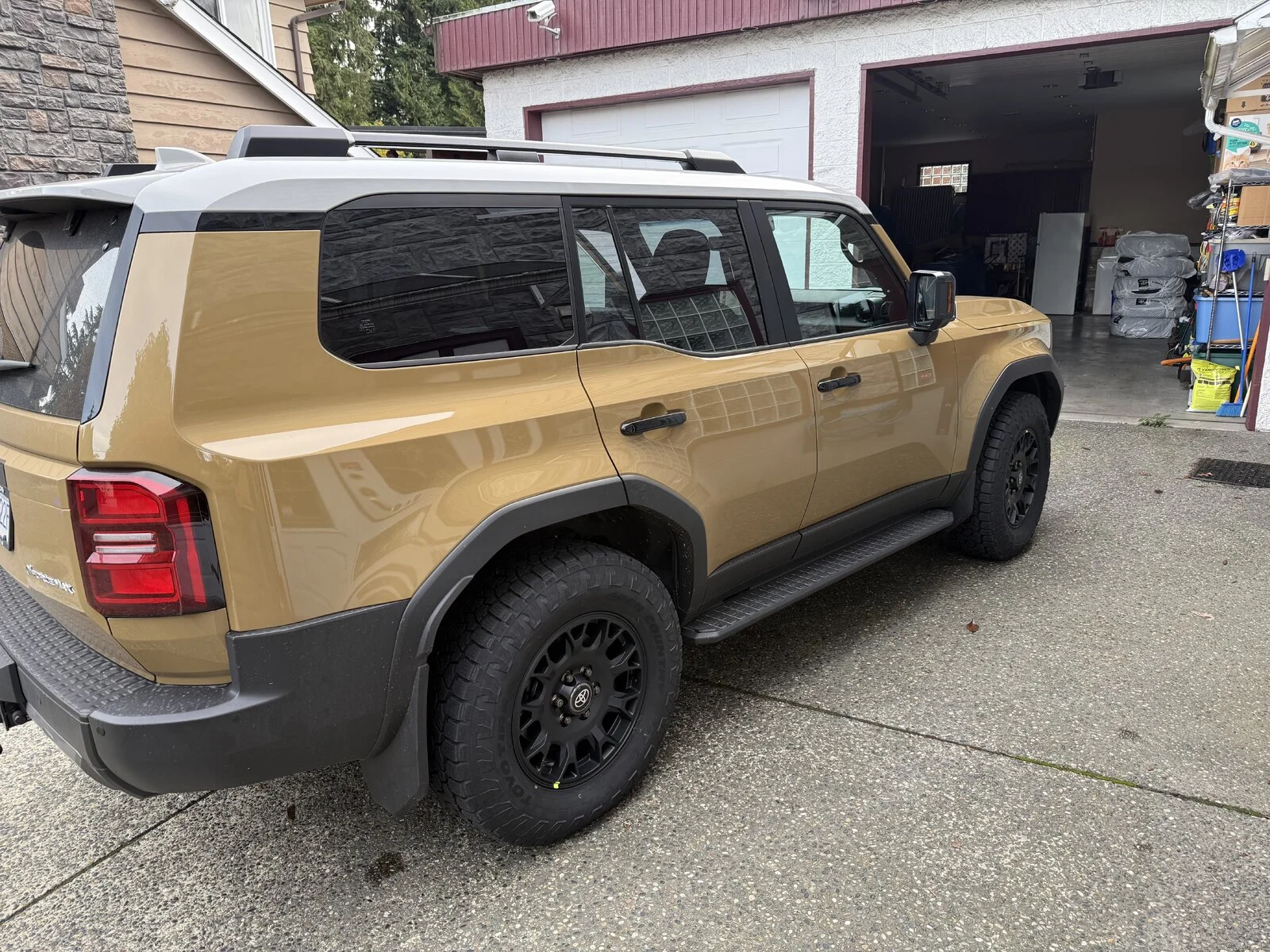

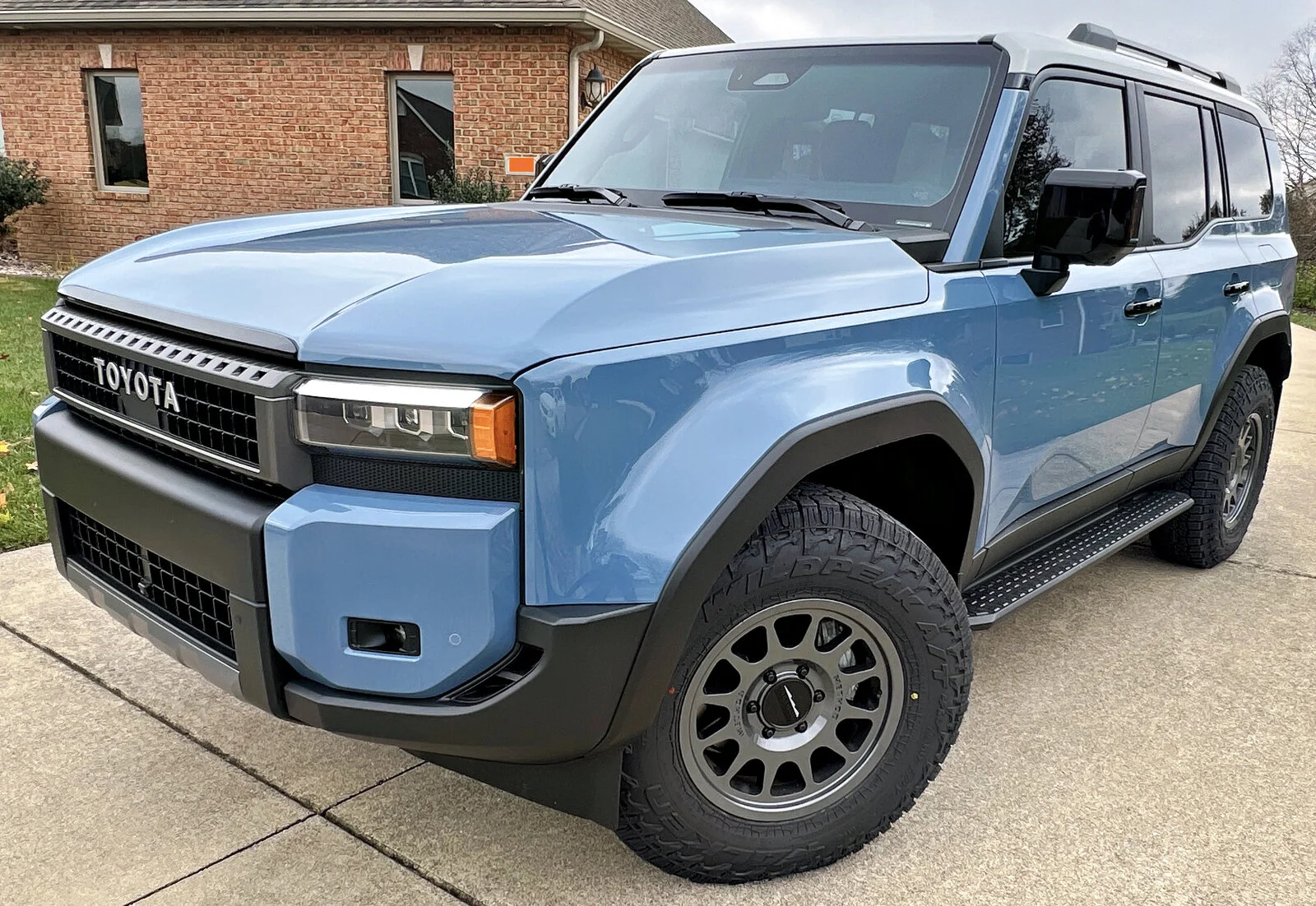

I ended up going with Falken WildPeak AT4W LT255/80R17 on Method 703s. Click the link for a really detailed post and pics. The tires are a true 33", but actually lifted me up more than expected. I'm guessing that the stiffer sidewall and higher pressure (39 psi) I'm running on the AT4W are the reasons for the additional clearance (I got about 3/4" instead of the expected 1/4"). The spare fits nicely underneath, with plenty of extra room. I'd bet that a 34" will just barely squeeze into the space. I'm very pleased with the new wheel/tire combo on my LC.
