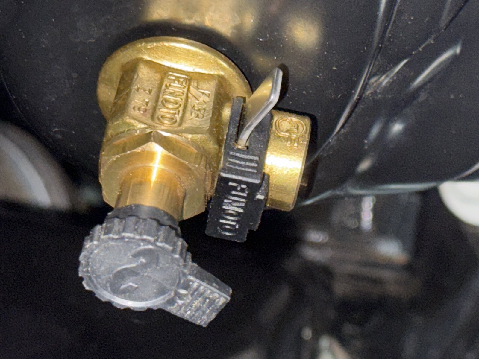

Ordered, haven't shipped yet, as soon as they do and get them installed will let you know my thoughts and about the oil drain plug, I do have the fumoto valve in mine.
Thank you! I’m considering Victory and C4 skids.
Which Fumoto valve did you install?
This is the one I used, luckily it was same one that was on my Tundra, removed it and put it on the LC

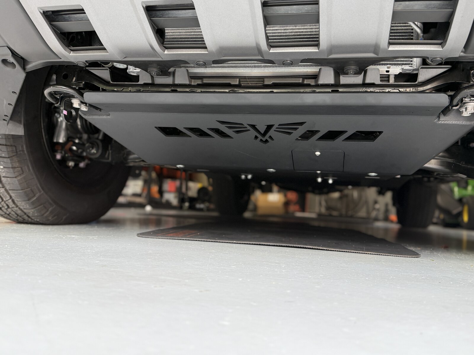

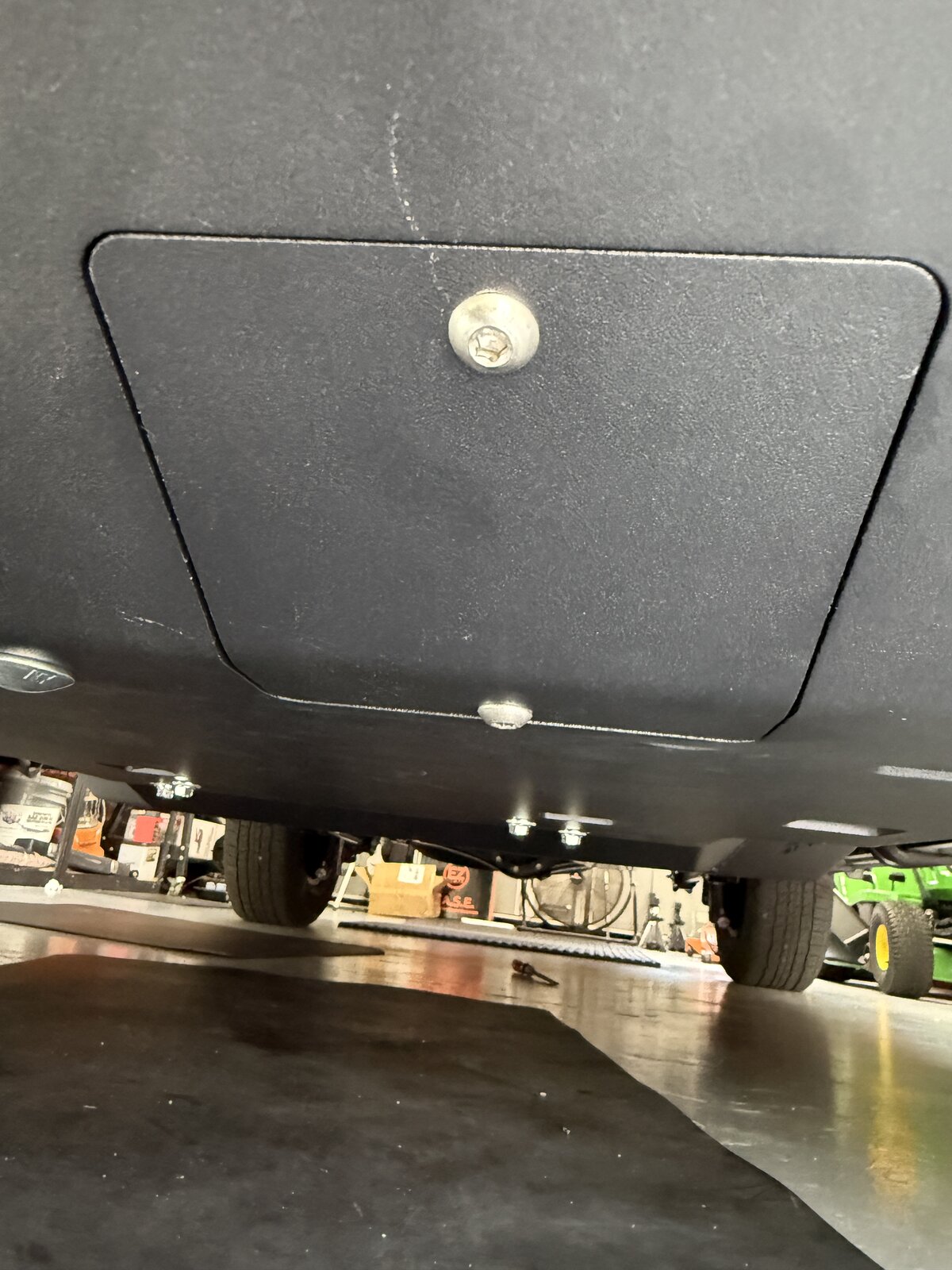

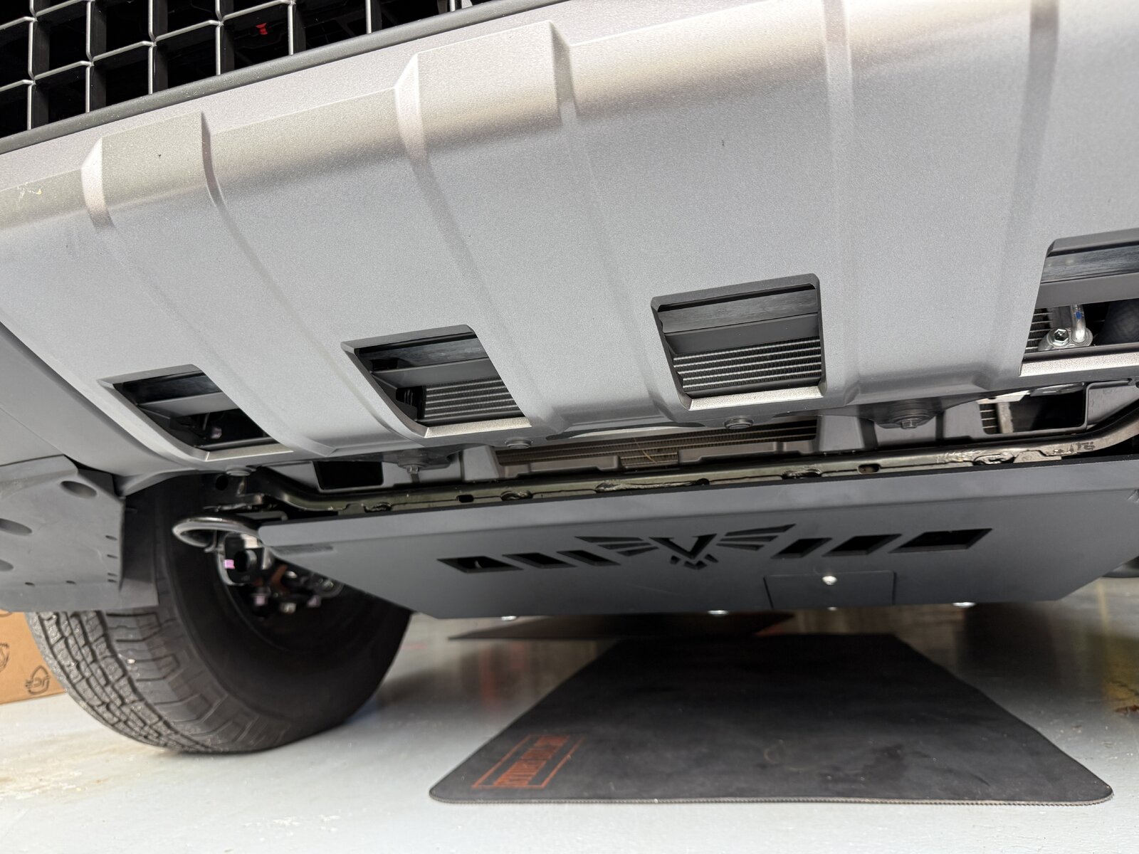

I just finished installing the Victory 4x4 engine/tranny skid plates, some observations I made during and after installations, some are minor, but a couple are big to me, and one would have stopped me from purchasing.
1. The oil filter panel, should have either been rivnutted or the nuts welded on, there is a chance you will need to get a wrench on the nut, which maybe impossible if it starts turning, or if you drop the nut or nuts, and you don't have a magnet around, your going to have to drop the skid plate.
2. Getting to the oil drain plug (no way are you getting your hand thru the square hole) if dropped, plus the mess it will make on the skid plate, you can reach thru the side, luckily I have fumoto valve on it, so it won't be as messy to change the oil, but getting to the safety clip and pulling the lever over to open, will have to go thru the side of the skid plate.
3. No install instructions for it, only video from Tacoma.

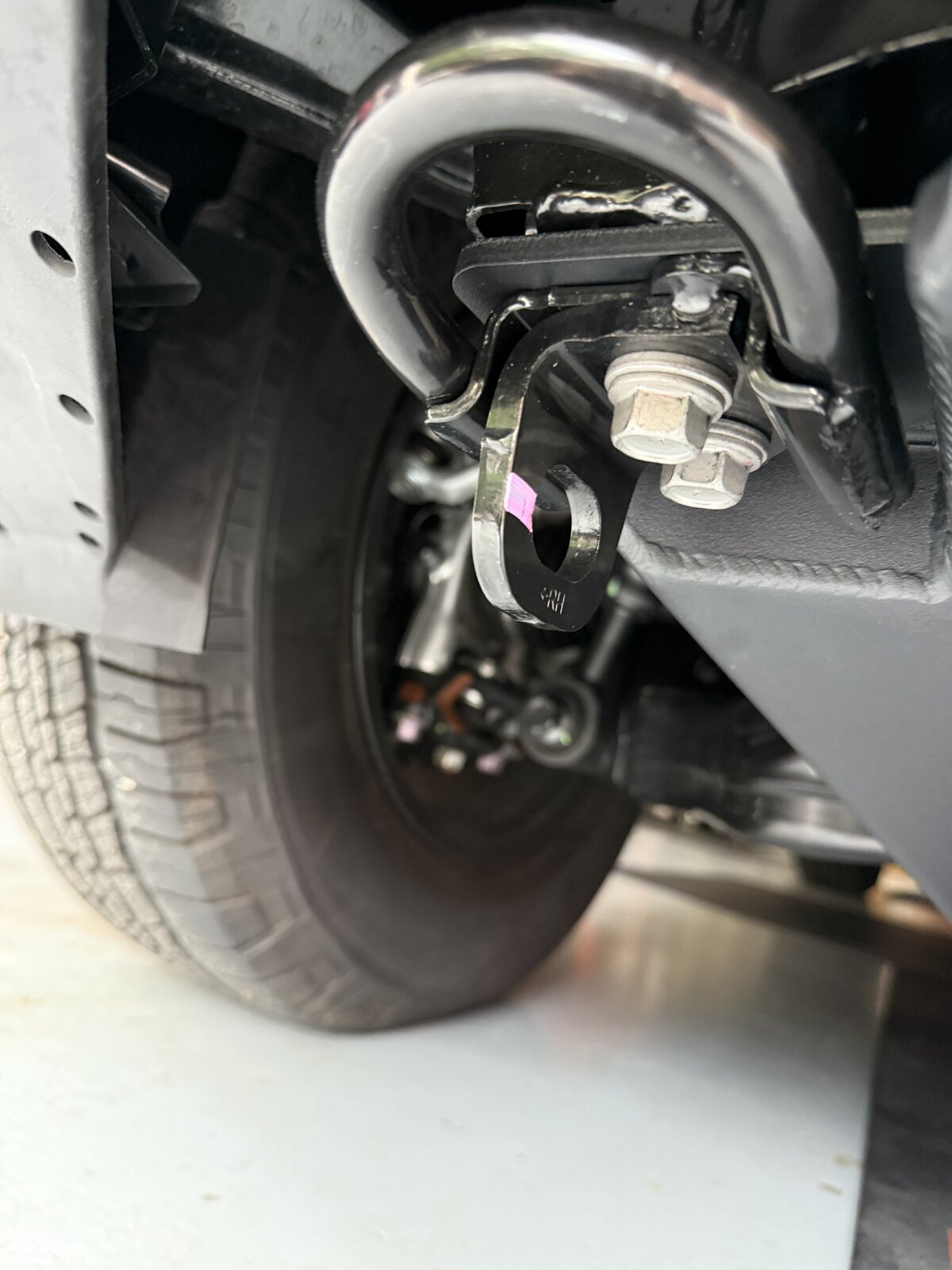

4. I don't know if you were suppose to or not, put the tow hooks back on, but I did.

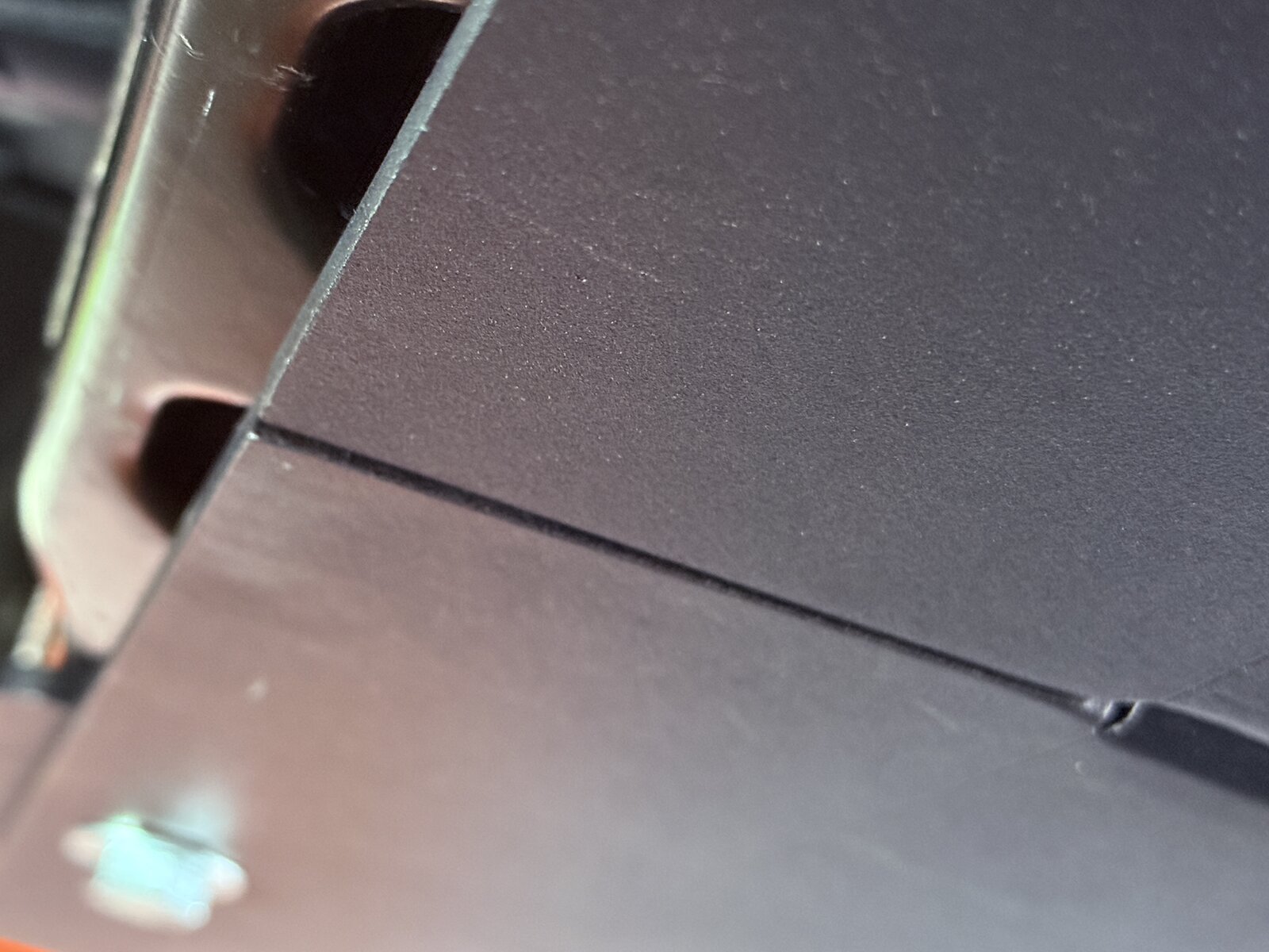

5. Both engine and tranny skid plates should be one piece, both cam as to pieces,
6. If for some reason one takes it to the dealer to have your oil done or tranny fluid changed, you know they are going to charge to remove the tranny skid plate, will charge also if they have to remove the engine skid plate.

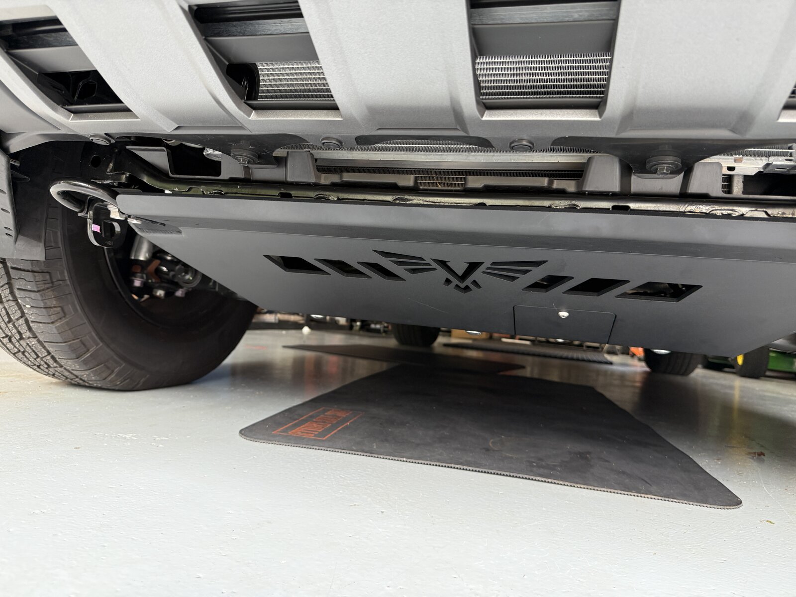

7. There is now nothing keeping rocks or debris from getting to the radiator or cooler.

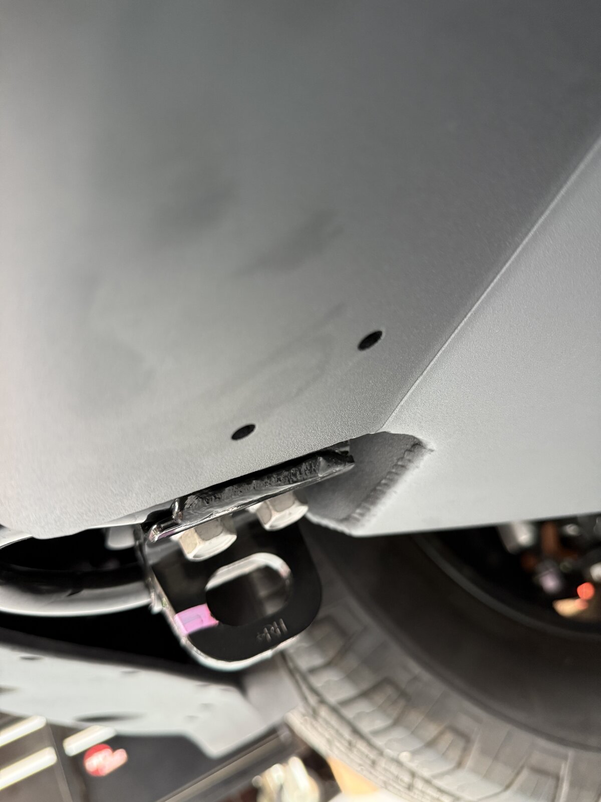

8. Didn't know what the 2 small holes are for on the front of the skid plate.
9. It can be done without jacking up the LC to do it, tight squeeze though.
Looking back, I should have waited on Talons Garage to come out with theirs, but thought I would give Victory a shot, since its also made in AMERICA.

It should work. I might take mine down to a machine shop before my next oil change and see if they can cut the hole larger and install rivnut.
I don't think they thought things through. I know my skid plate for my Tundra had hole large enough to get my had in, and the filter area was rivnutted. They just didn't know when they would get to doing the LC.
I had the same idea. I think I will call Victory tomorrow. What size hole are you thinking?
I'm thinking a 3"-4" hole.
Yeah I gave Victory a call and email about my suggestion on the rivnut, the bigger hole etc.
Told them it wasn't thought out very well on the filter door and hole for the drain plug

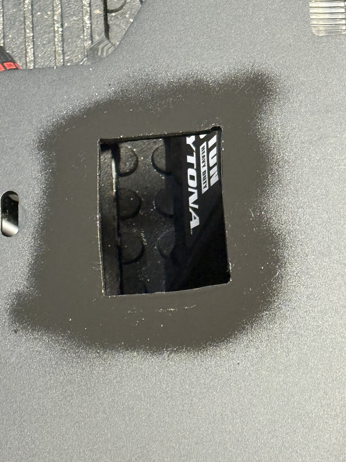

I think a 3 inch square hole may be a good option. I plan on testing the size by cutting a hole in some scrap plywood. If it works, i will pressure Victory to use my skid as a test… This would be a very simple solution.
Question, is the current small square hole centered below the drain plug?
I’d have to recheck
I might do some marking with it installed and then cut a bigger hole in it, shouldn't be difficult, drill and cut.
The other thing I didn't like was the space left open under the radiator/cooler, but I guess they are making bumper and it will have a filler (strip??)

3). Transmission Skid Design: The two-piece design is a mostly due to shipping costs. We prefer to manufacture one piece skid when possible, but the shipping rates were astronomical for this specific vehicle and would have added a couple hundred dollars to the product and likely sustained damage in transit.
4) Tow Hook Reinstallation: Yes, the factory tow hooks can be reinstalled with this skid system.
6) Those smaller holes up front are for our jig when we are manufacturing the bumper to ensure the skid is secured in place during fabrication.
7) We don't currently have a front bash plate that bridges the gap between the front bumper and the engine skid plate but we are in process of designing the front Blitz bumper for the LC250 which should be available in the coming weeks. Generally our bumpers and skids when installed together leave very little gap between them.
I just did it myself, didn’t go any further back, went 1” on each side, 1” on the front. My jigsaw skills are below average, but hey it’s done. They should have done that or did a 3 1/2” hole.
You could get away with 3/4” on the sides and front. I have plenty of room with 1”
