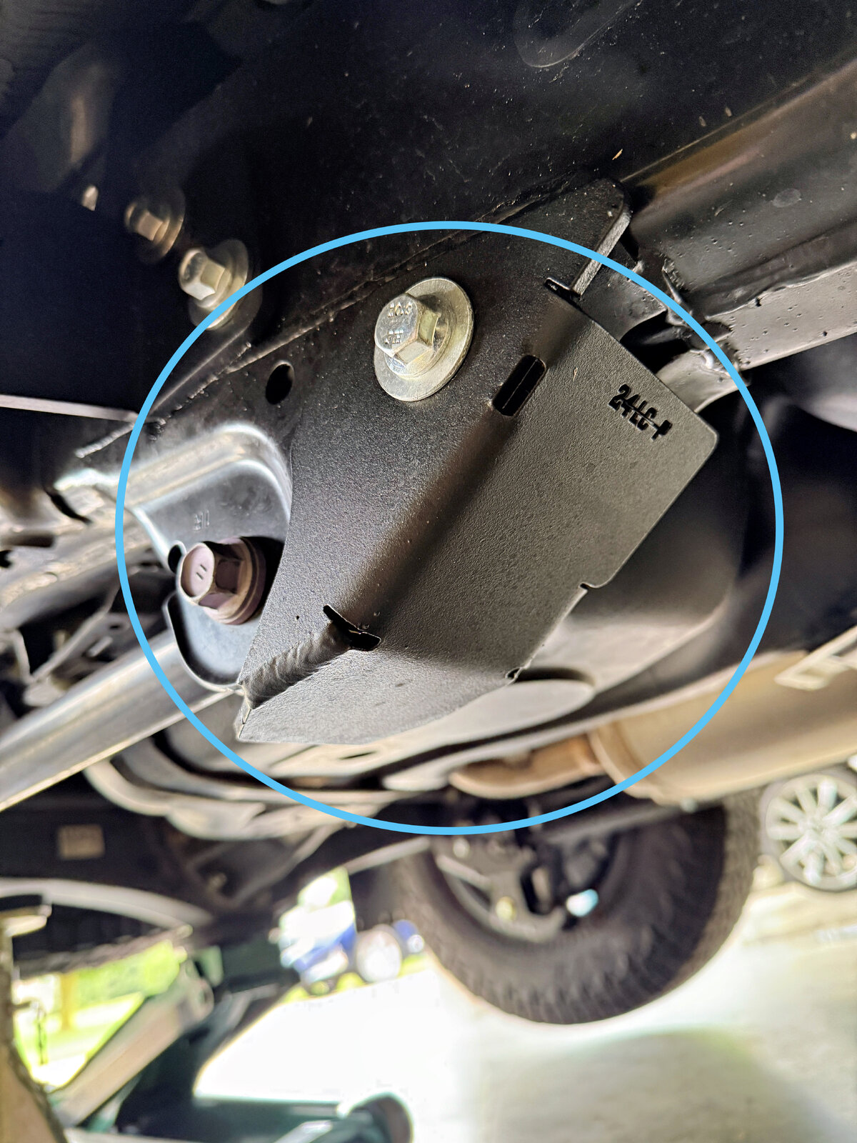

Received the rear shock and front lower link skids yesterday. My initial impression - 3/16" steel makes these skids extra heavy duty. I picked RCI over Victory in part because the steel is 50% thicker. Overkill? Perhaps. On the other hand, the welds on the shock skids must've been made on bring your kid to work day - sloppy at best. I contacted RCI and sent them the pic shown below. I'm not concerned about the integrity of the weld, but the quality of workmanship made me wonder about other RCI parts. I received a nice response from RCI, but I'd still be somewhat leery of ordering something that would be visible (think bumpers and rock sliders.) By comparison, the welding (and grinding) on my Slee Rock Sliders is exceptional. Maybe someone with RCI sliders or roof rack might want to post something?

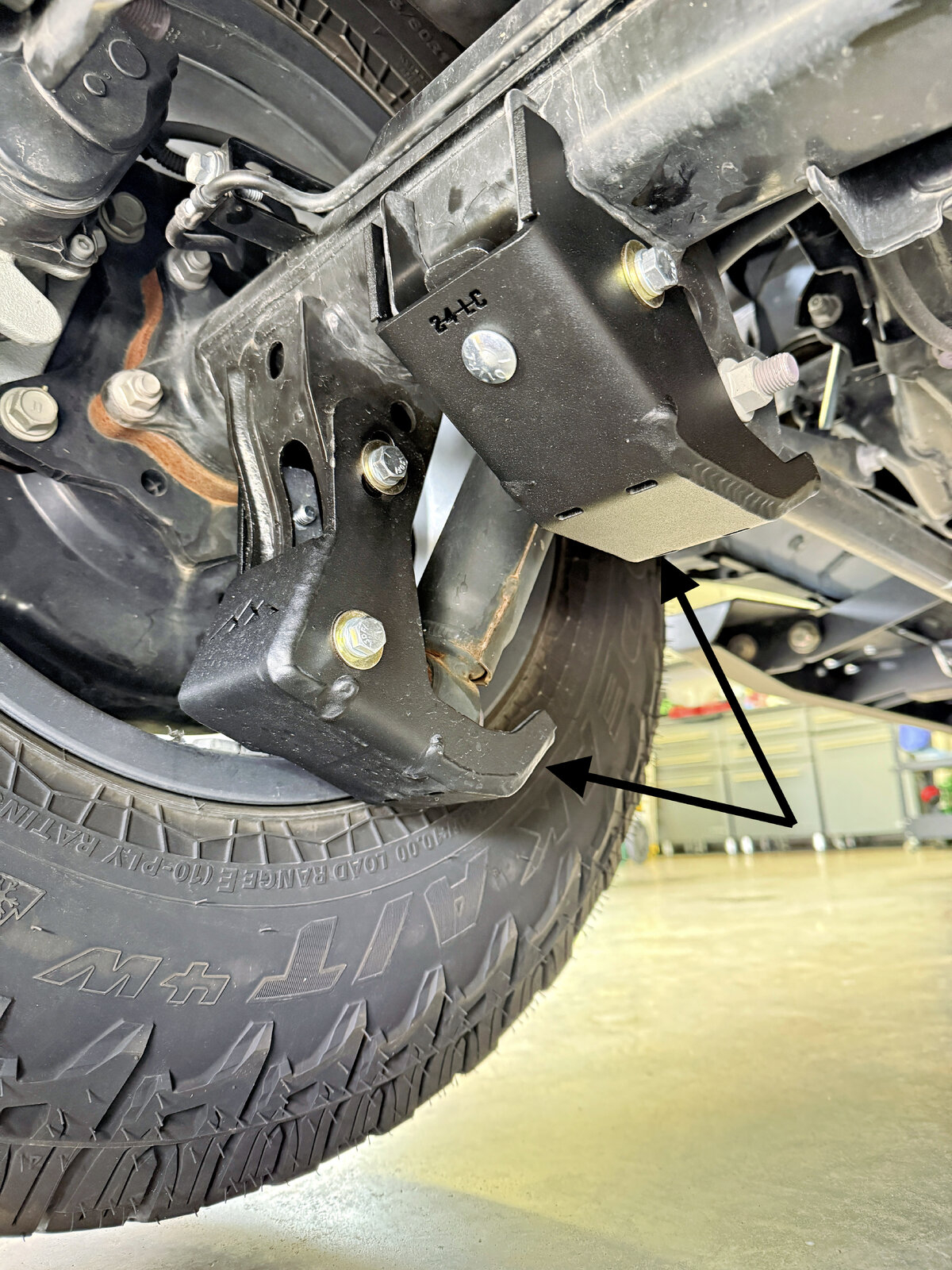

Installed the RCI skids for the front links and rear shocks today (the rear link skids will come in about two weeks.) The installation of the front link skids is super easy and takes almost no time. Just follow the directions and you should have no problems. For the rear shock skids I thought it would be easier to do if I put the rear of the truck up on jack stands and removed the tires - super happy I did this because it makes access so much easier. If you want to punish yourself, leave the tires on and install the rear shock skids. You've been warned!
The rear shock skids were a little more difficult to install only because it is difficult to get the bolts started in the threads on the rectangular nuts. II found the size of the rectangular nuts is just a little too big on the width, so they can't line up with the center of the holes. I'll send some feedback to RCI and see what they say. Mostly, it just took some patience to get the threads started because the access to hold the rectangular nuts in place is limited to about one finger. If you've got big paws, this could be much tougher. On the plus side, no need to remove any bolts to install the rear shock skids.

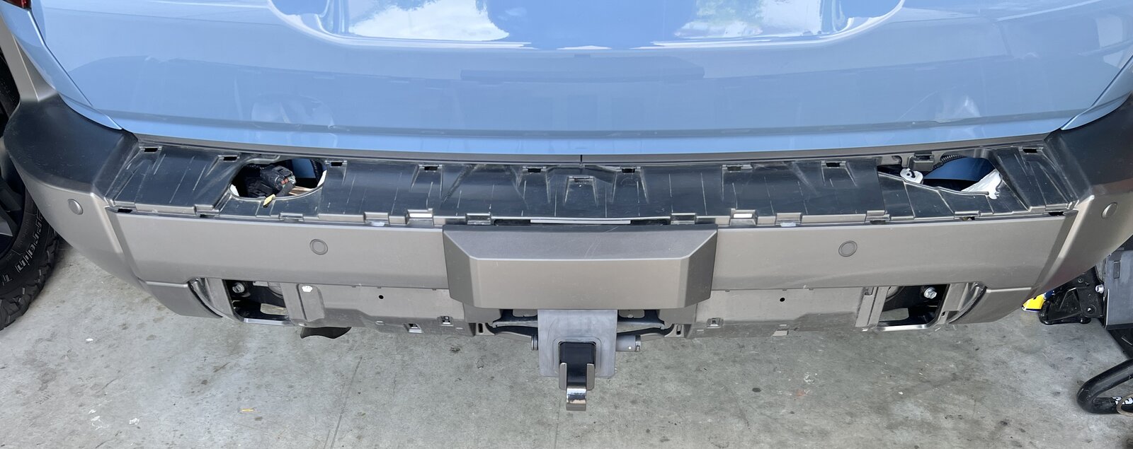

I am in the process to “delete” the “silver panels” on the rear bumper. Black them out to match the entire bumper.
Now waiting for the paint dried out and put them back tomorrow ;)
As usual, photos will be shared to the gang.

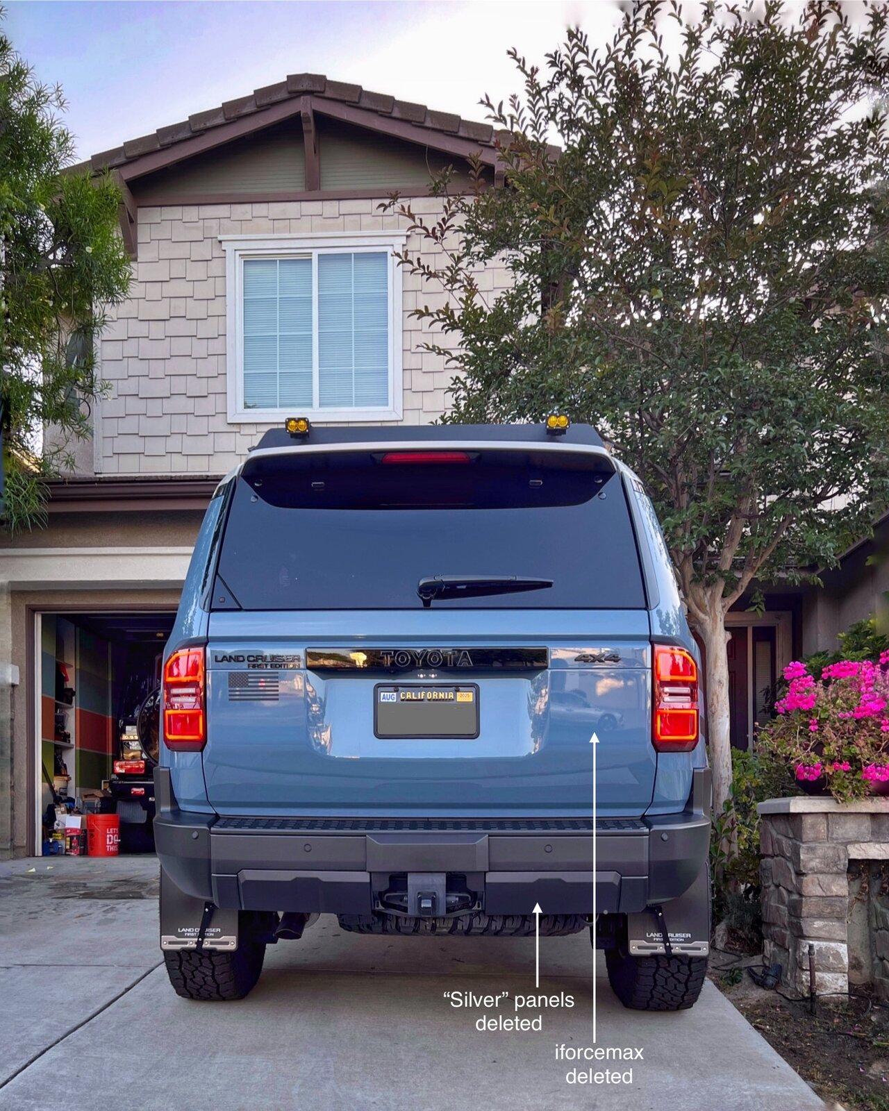

Here it is: the irritating “silver panels” deleted by me 😜 😜
And some photos “behind the scene” ;)
Before 😞

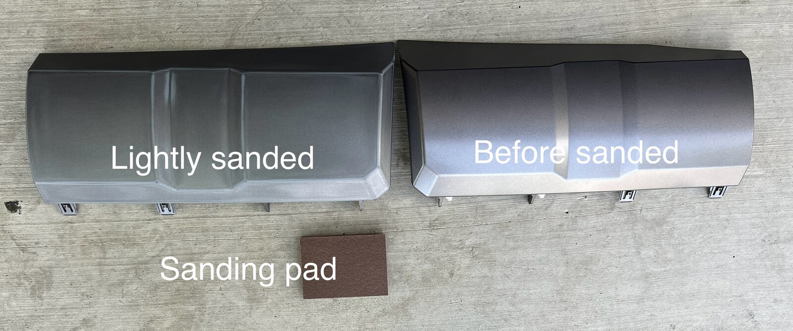

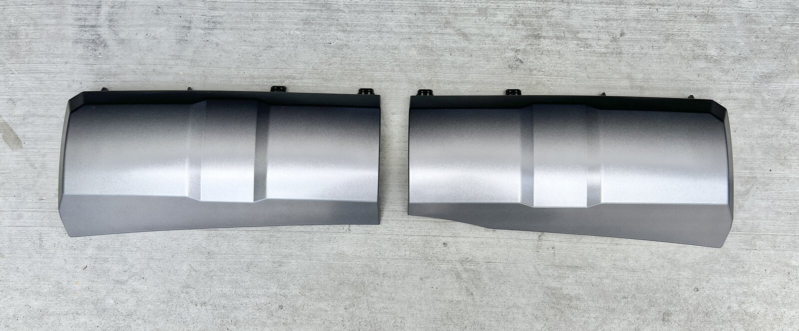

Great - something new to do to mine. What paint did you use?
First 2 coasts “satin”, then next 2 coasts “flat”. Then it matches the bumper color and finish “perfectly” ;)
The silver panels don't really both me. But, I do like the look of your panels in black. Did you use any type of plastic primer before painting?
Yeah.
I no longer had any “silver” panel at front bumper, so the “remain OEM silver panels” at rear are kind of out of the world in my case. Too many color and pieces make distracting and less “aggressive off-road rig” ;)
Pls see other post for the paints I used
Photo of front end vs rear end now

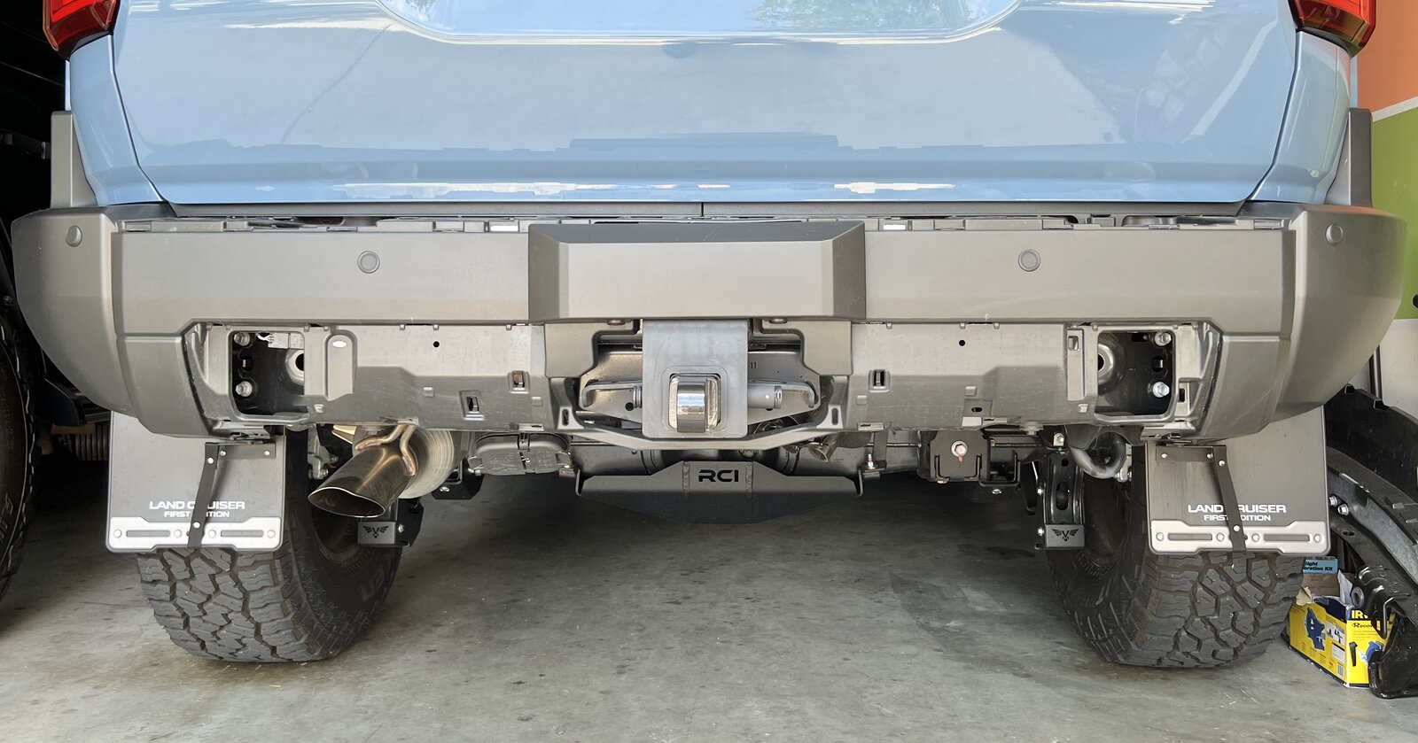

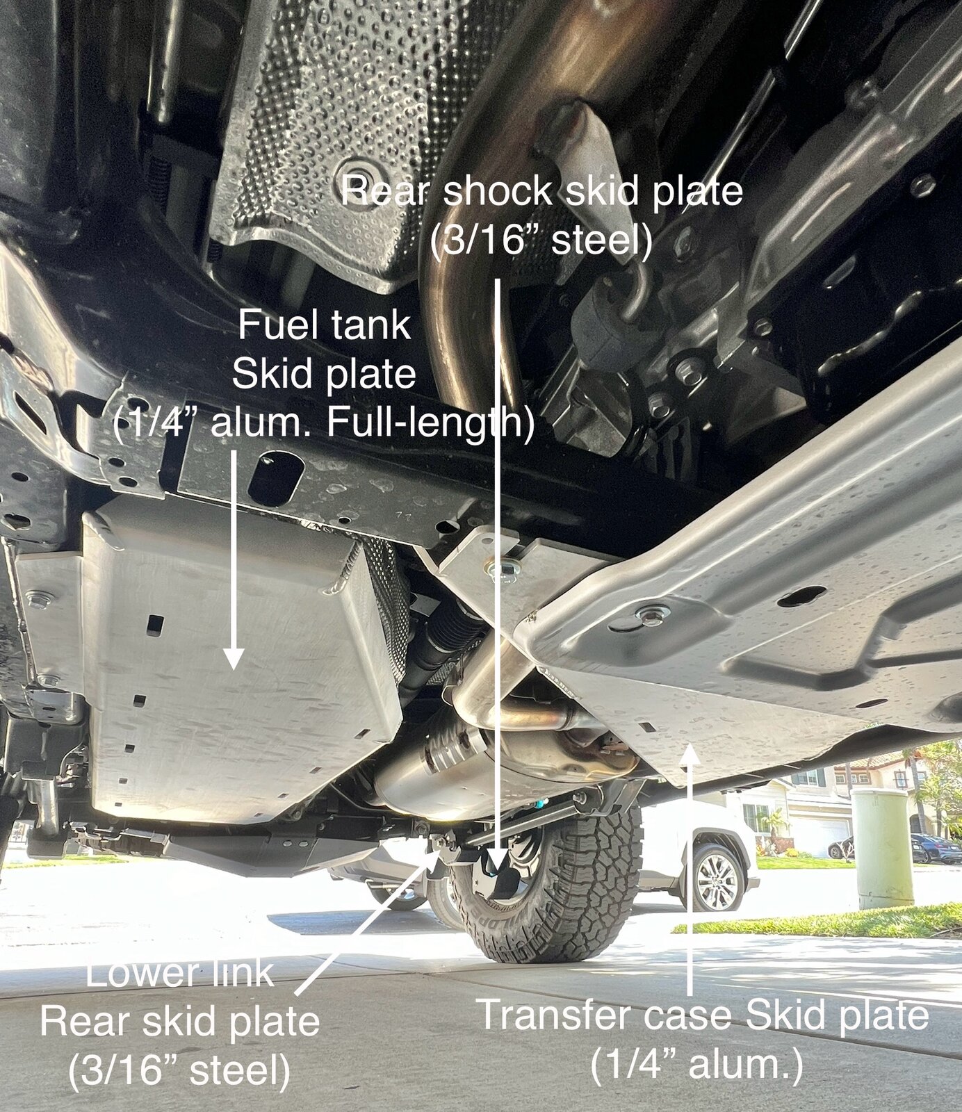

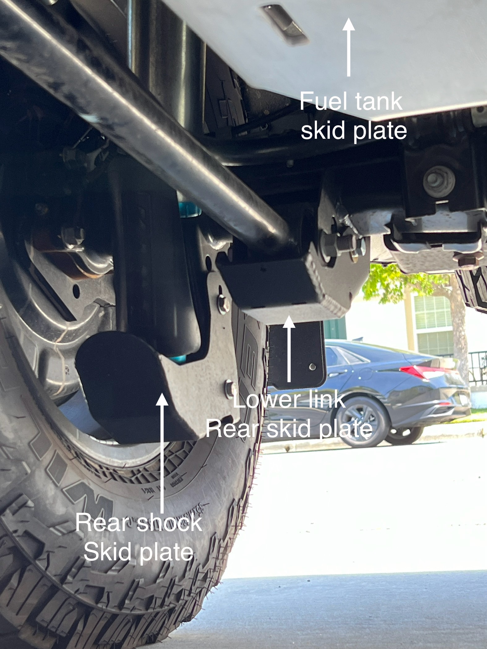

Installed the RCI skid plates for the rear shock mounts and the front and rear mounting points of link arms. I went with RCI because the steel is 3/16" thick which is about 50% thicker than the Victory skids. The overall quality was good and the install was straightforward. I highly recommend removing the rear wheels when installing the rear skids. Here are pics of the installed skid plates:
Pic 1 - Rear shock skid and rear link arm skid
Pic 2 - Front link arm skid

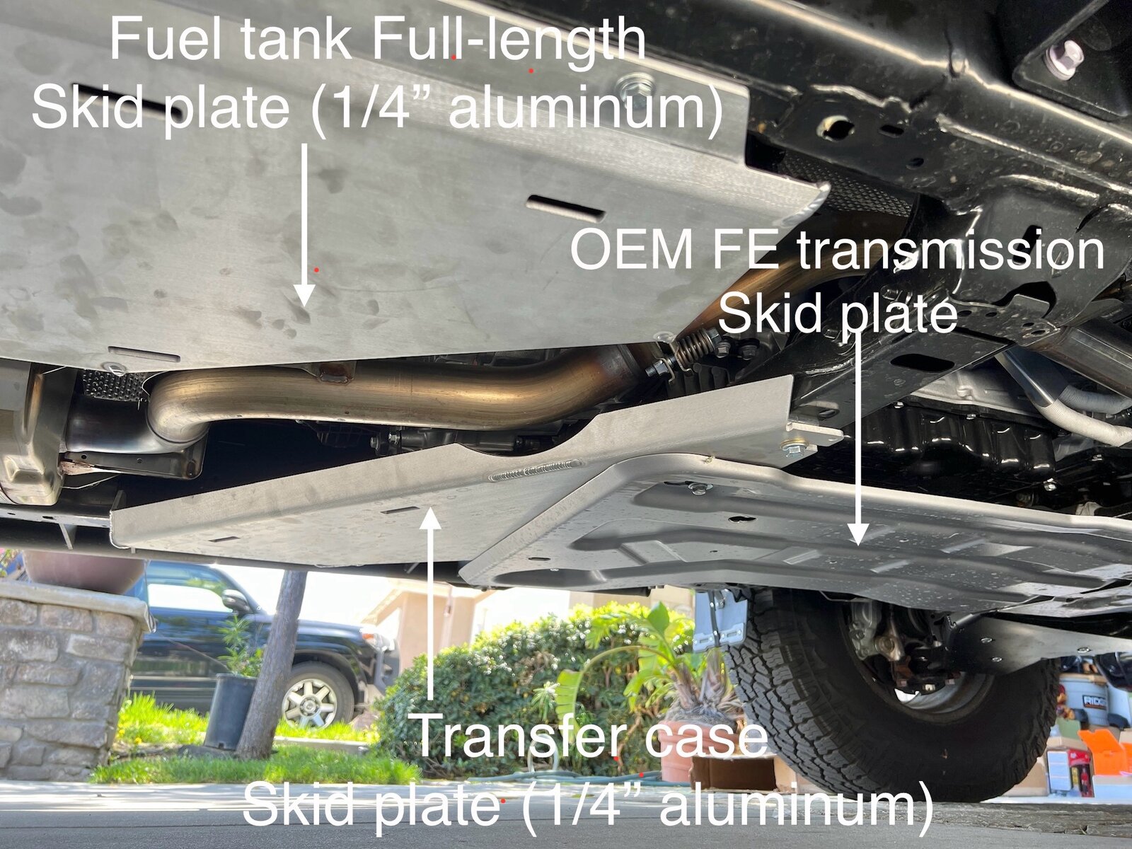

Got all 3 OEM skid plates installed this past week. now looking at these other plate protection
Any one install any of these? wondering if it's worth it.
I ordered and received the DV8 A-Arm skid plates. have not installed yet.
won't be rock climbing or lifting my LC, will mostly be on dirt roads with washboard and some deep ruts.
TIA!
What is the 3rd oem skid plate? I thought there were only two
