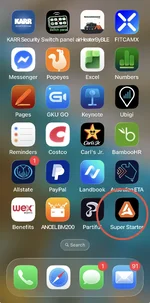

Don’t mean to do free advertising for Amazon products, but share my personal experience. Here is how Super Stater helping me to monitor/alarm when power/charging is in critical. Ideally, it is always ready to start the engine when the 12v is out of the game.
Like I said in beginning of thread that I always have super duty battery jump starter, Jackery with jump starter / cables, and old-school charging cables. However, I kept plugging in and out and when couldn’t start engine ESPECIALLY in no where in woods or desert with no vehicles around (except wife and 2 kids)
Attached are some photos/video of this Super Starter. Soon, I will try to “kill” the battery by open all doors…then see how this device starts the engine (will report later)
Note: I didn’t have time to visit dealer to check the battery health yet. I personally HATE to see those dealer service advisors personally…they try to make $$$ or could cause some more problems then you come back to fix !

Anyway, even the battery is way improved, I still keep the BS200 Super Starter installed to monitor 24/7 through my phone and 100% guarantee engine can start even battery goes down to 5% juice. I still have a big/powerful jump start with me as well ;)
