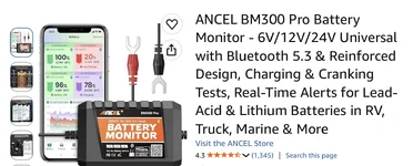

Now, I found couple solutions here which maybe helpful:
1/ battery monitor/ alarm: let us know real-time the status / current of its charging…and alarm us when it is going to die. However, it just help a bit : Ancel BM300 or BM200 Pro Battery Monitor
2/ super starter / permanent mounted/connected to 12v battery: always there and top off capacity and guarantee to supply 700A start assist just in case the 12v battery is weak or died
I will test these products at home garage with opening all the LC doors. I am leaning more about solution 2/
