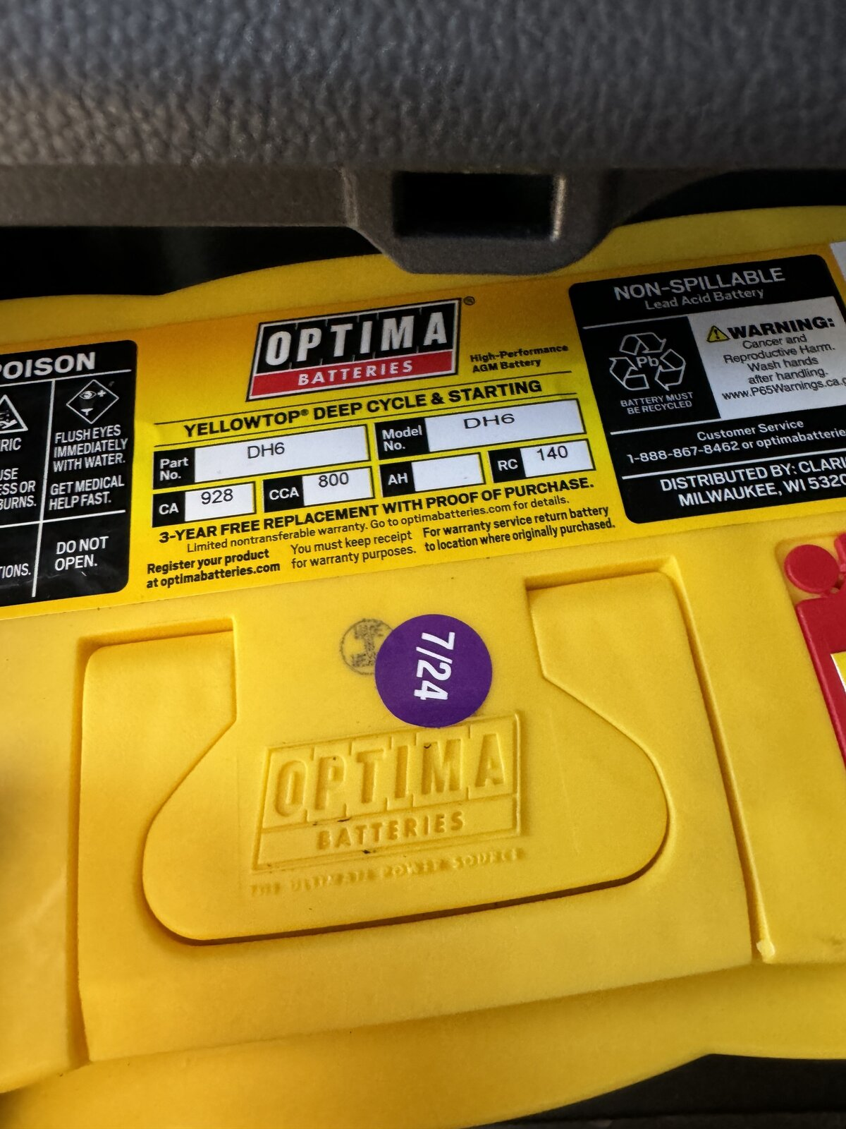

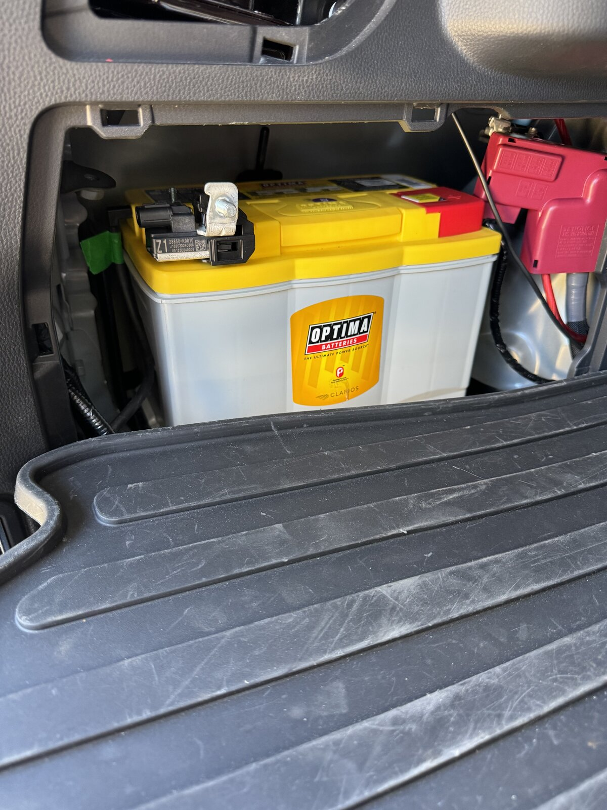

Can't find the photo. Will you be kind enough to email wglevy@gmail.com,
Thanks, Bill
