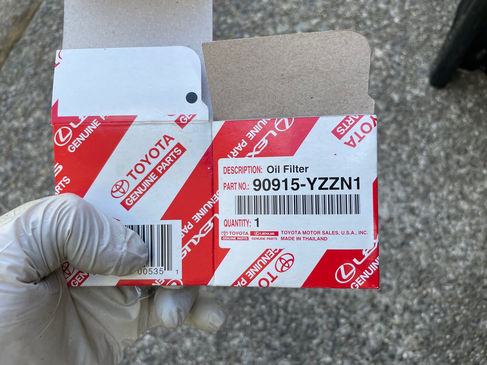

It's been years since I've changed oil in a car, but is this the normal size now for oil filters. Just received my Toyota oil filters from Japan and surprised to see how small they are now or did I get the wrong oil filter.
That's the size

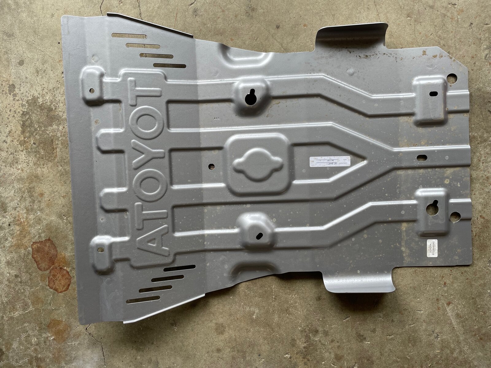

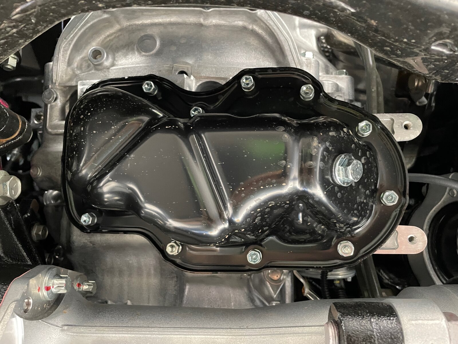

I just did the first oil and filter change after break-in @ 1,000 miles. It is one of the easiest to change. Everything is easy to access. The skid plate has 6 12mm bolts. 2 of the boltholes are key holes so you just loosen them and it will hold the weight for removal/install.
Once you have the skid plate off everything is easily accessed.

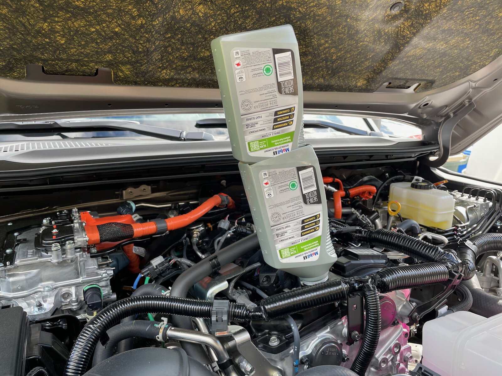

Bonus. The threads on the oil container thread into the oil filler. You just cut the first one's bottom off and you have a funnel.
