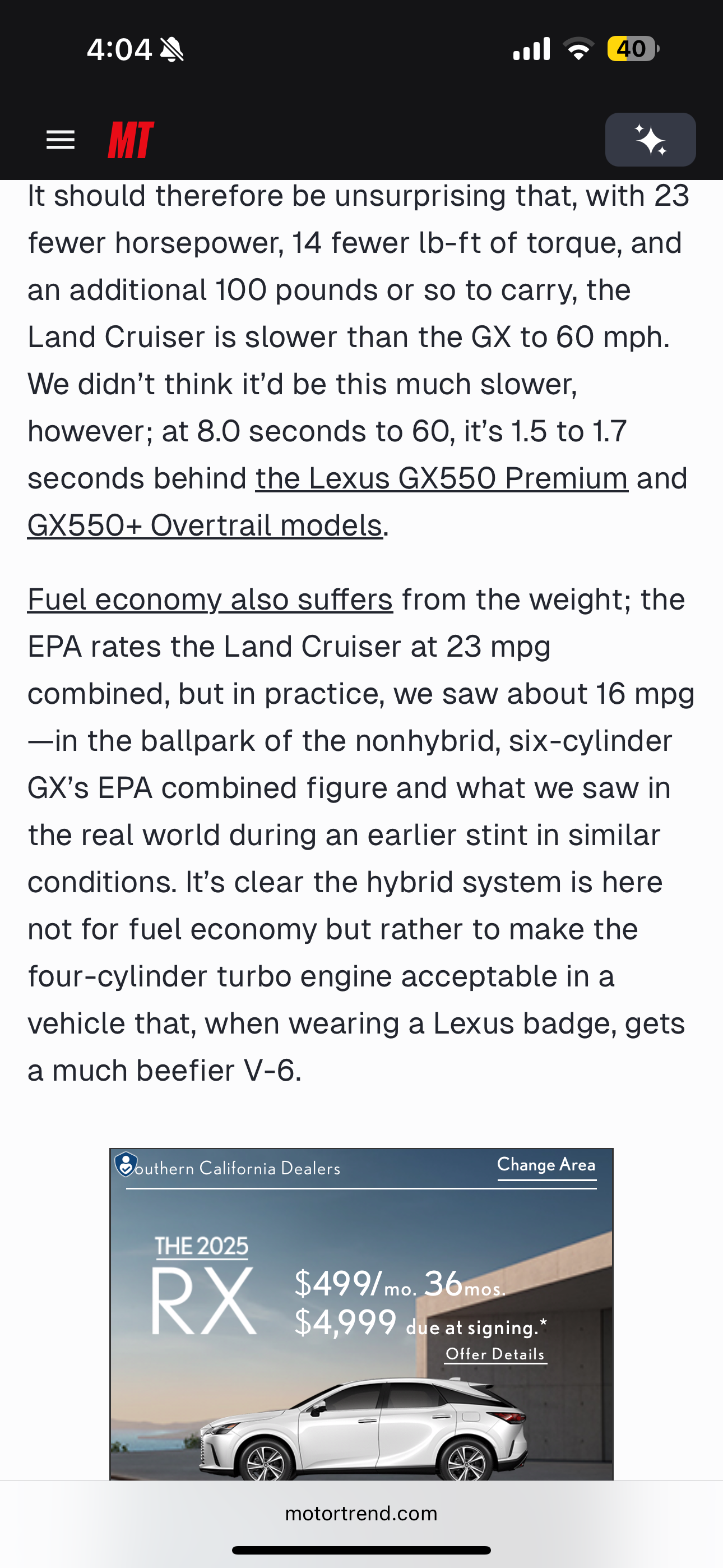

also per C&D, and edmunds test that was shared yesterday between 4runner TRD pro and the Gx the freeway MPGs are identical.

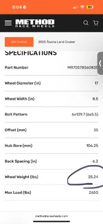

Fully agree, I'm on 255/80R17 52lb tire and 25lb wheel with a total weight of 77lbs (same as the OEM 20" combo I removed) all verified with a certified scale. Contact patch is smaller than OEM setup and my MPG is not affected by a measurable amount with the AT tread which was the goal.

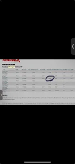

Those Duratracs being discussed are only 34.4" diameter, and Goodyear doesn't publish the weight but various internet sources list anywhere from 63.25 to 59.5lbs. per at that size (per tire rack 61lbs at that size). Method 703s come in at just under 28lbs. Best case almost 90lbs. per corner, sounds fishy to the claims being made here. I'm not sure which Method is being ran but after seeing the bs on the tires being discussed I lost interest to look any further into it.

😂 if you did more searching instead of talking you could have saved yourself the embarrassment of the bolded paragraph
Tire weight 52
Wheel weight 25
Should I do the addition math for you or you are smart enough to figure that out?
