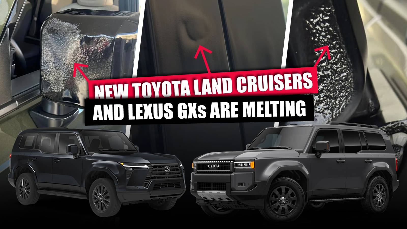

Land Cruisers are melting

I've heard this phenomenon before. It's not unique to LC or Toyota. The common factor is PPF. I'm not sure what brand PPF, or how it was installed, or even if that's been proven, but it seems like a reasonable explanation.
File this under "obvious things that happen to any vehicle if you focus light on a dark surface for long enough".
Yet another unintended consequence of life in the online age. Any kid from the 80's on back would have had first hand experience of playing outdoors with a magnifying glass and the sun, could have figured this out in 2 seconds flat and would have better things to do than churning out a litany of corporate conspiracy theories for "clicks" and "likes".

On my 2007 BMW R1200 GS Adventure, the windscreen would focus light in such a way as to burn/melt small linear lines into the black plastic housing of the instrument cluster when the bikes were parked outside during the daytime hours. It was a widely known problem on that era of bikes. BMW Motorad fixed the problem by charging the type of plastic used in the instrument cluster housing.
This is happening to me. I picked up my 2024 Land Cruiser in September. First, the distributor-applied PPF started warping in late October and was replaced by the dealer. Then, both side mirrors began warping/melting in late November, and the dealership replaced them. Now, one of the new mirrors is warping again and so is the PPF on the front end.
I’ve had two different Lexus models and a Tesla parked in the same driveway with no issues. This is pretty disappointing for a five-month-old vehicle I’ve never experienced anything like this. I’m in Austin, and it’s been cold; I can’t imagine what will happen in the summer.
Does anyone have any solutions? Thank you in advance.

This is a PPF issue. Either cheap PPF or some issue with the installation.
The mirrors have no PPF. The mirrors are melting as stated in this article.
If it is both PPF and mirror, you either parked somewhere where sunlight was lensed, or someone with a heat gun vandalized your vehicle. Some type of defect would not only damage mirrors, and after market PPF.
Looking at your pictures, mirror didn’t even get painted damaged. Plastic on it literally melted.

I do not believe I was vandalized and I have parked in the same driveway with many other cars. I guess I will not longer park in my driveway.

Are damaged side on both mirror and PPF on the same side? You may be able to figure out where the light is being lensed from if the damage on different parts are facing the same direction.
Tall glass buildings are notorious for lensing sun light. If you parked on the street near one, it may have caused it.

I'm just confused and looking for a solution.

Do you know if you have reflective PPF, I am wondering if PPF itself is lensing the sunlight from the hood to the mirrors? If that is the case, wheel well may have self lensing due to concave shape.
I have the PPF that was put on by the Gulf Distributorship (I didn't chose this). I've never had PPF, should I just have it taken off? I've never had an issue like this with a vehicle. Thank you.
