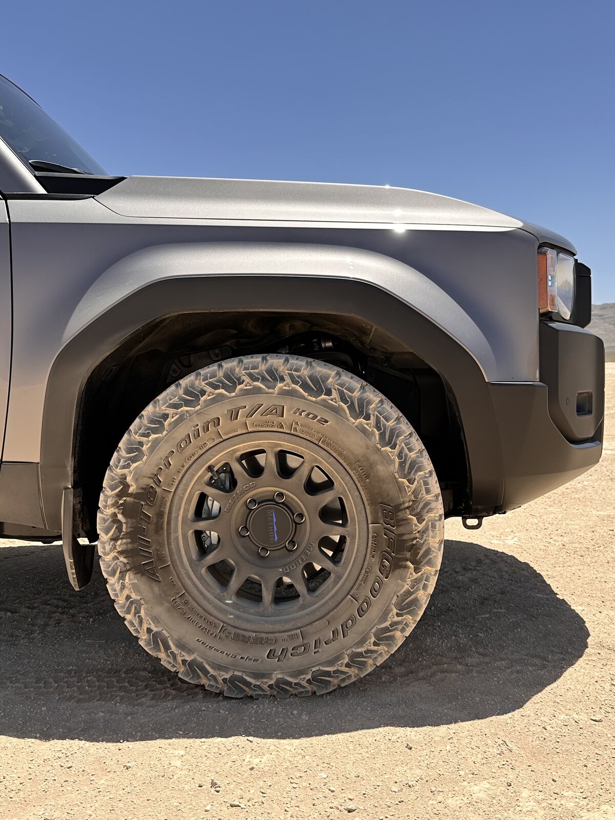

Yes, absolutely no rub.
I've upgraded to 305/65/18 right now, also no rub, did some offroad as well, went smooth.

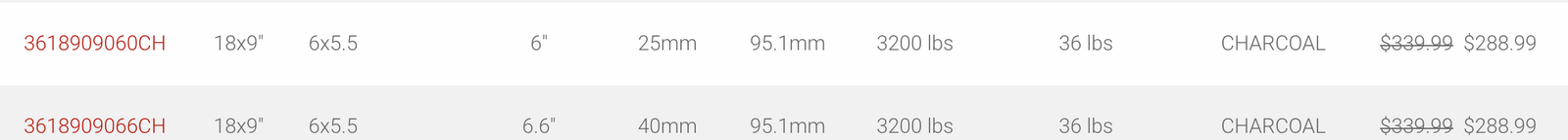

OK, many thanks for the info .... and do you think it will fit also with a +25mm offset rim, same model: ICON Recon SLX 18x9, bore: 95.1mm, on 33x12.5 R18, with NO rub ??

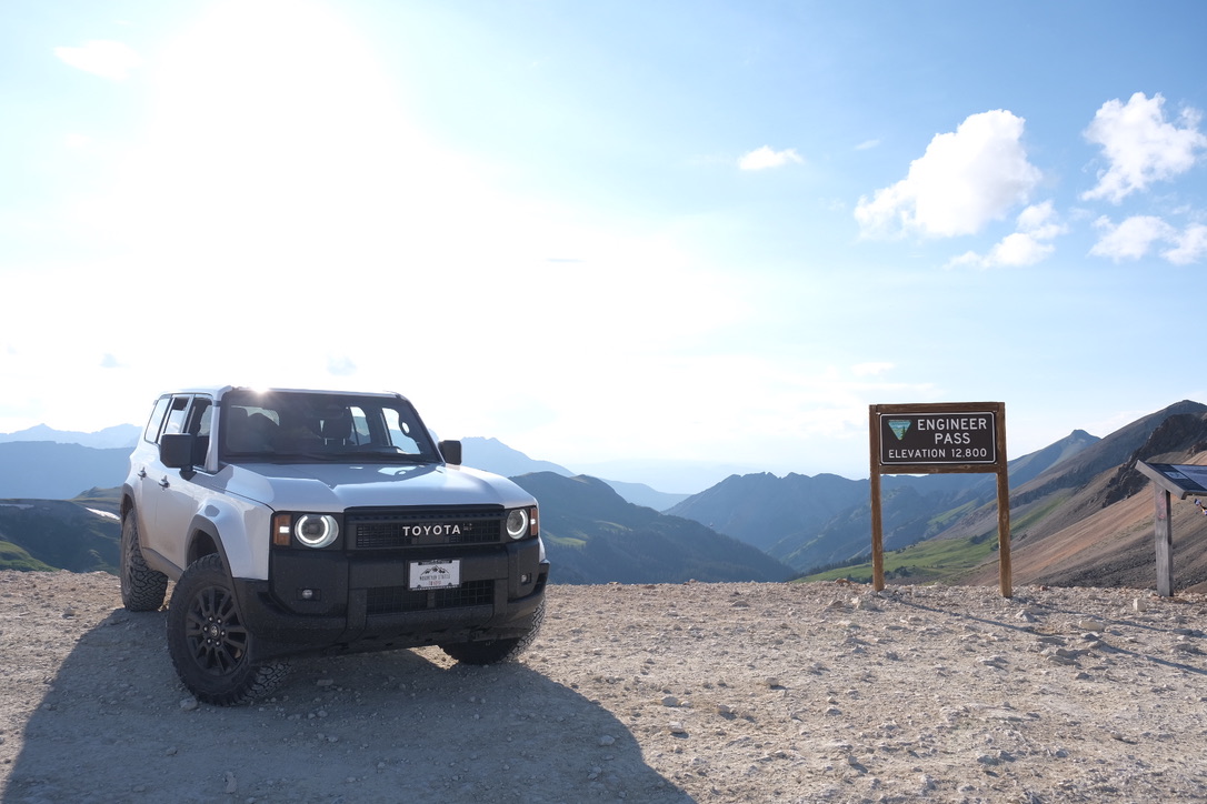

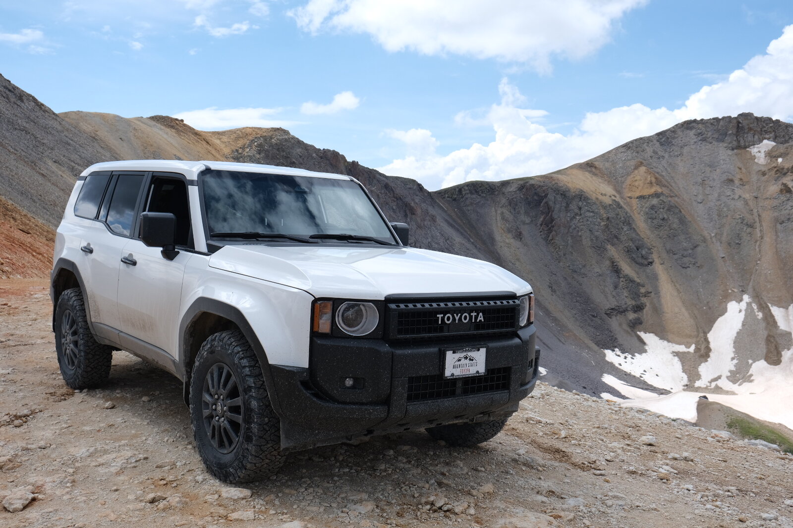

After entirely too much research (including staring at a lot of photos in this thread for a combined total of several hours) I picked up my 1958 this week and immediately put on the 275/70R18 KO3s that my dealer was kind enough to price match Tire Rack on.
The Les Schwab I visited for install didn't want to mount the spare claiming it wouldn't fit. The indie shop I visited the next morning said the same, but I talked them into doing it anyway. It just barely made it in, and it feels like it's maybe a half inch too big to fit in cleanly because it's catching on the two stays in the front keeping the tire from making contact with the panhard rod and it's touching the rear frame rail. I still need to do some adjusting, and maybe I'll just have to store it aired down a little, but wanted to share my experience since it wasn't smooth sailing. Worth it though!

Check those ... 17" or 18", and above all: 95.1mm hub bore which fits with Land Cruiser 250 series .... and then let them be painted same color of your LC ....

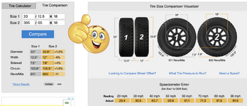

OK, very interesting .... on same wheel rim ?
  • Comparation 33%22 : 305.webp

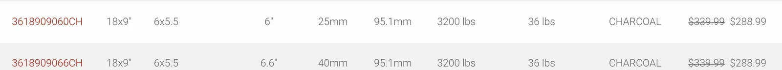

I was debating between 18s and 17s for a long time, and it wasn't easy to decide.
Almost same poke as 33"x12.5" R18 on 18"x9" ET:+40mm wheel rim ...
  • Comparatif 285 : 33%22.webp

Did airing down the spare help the fitment?

That's interesting, you're not the first to put these on and say they just barely fit in the spare location. I'm wondering if they are running larger than the official specs say? What PSI do you have in them?
it looks like the K03 your installing for a spare is 33.2 inches in diameter. I wanted to install 5 Mickey Thompsons Baja Boss’s that measure 33.4. That’s not looking good for me. Might have to switch to a different tire that measures at 33 inch max. Really wanted to do all 5 if I have a flat and can do the rotation.
