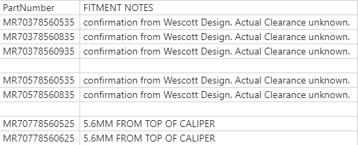

Do we have confirmation that the 17" 705s fit the wheels adequately?
Method's site lists the 705's in 17 and 18 in options as "vehicle verified" for the 2024 LC, but that's all I'm going off of
The 705's are my favorite too. If they came in 18" with an offset near 40, that's what I would do.
Below is what I got from Method on the 17" wheels. All of them look like a pretty tight fit.
Yeeesh, that is a squeeze. I think I will keep the stock 18s and Ridge Grapplers for a year or two, then see what aftermarket options have become available. Someone is bound to make an LC-specific 17" rim.
