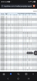

That's potentially damaging your tires etc. but i hear you loud and clear, you dont like driving with a mouth guard in.
I run our E rated KO2s 315/70 R17 at 35psi on our jeep (same reason as you), but jeep weighs 1000 pounds less than LC. I raise them to 38 when i tow (1500lbs). Check the chart if you havent already, just for peace of mind.

For sure if I was towing or carrying substantial weight I would run them higher, but my tires have always lasted me due to 5k rotations. Very impressed with the new KO3’s and Falken Wild Peaks.
