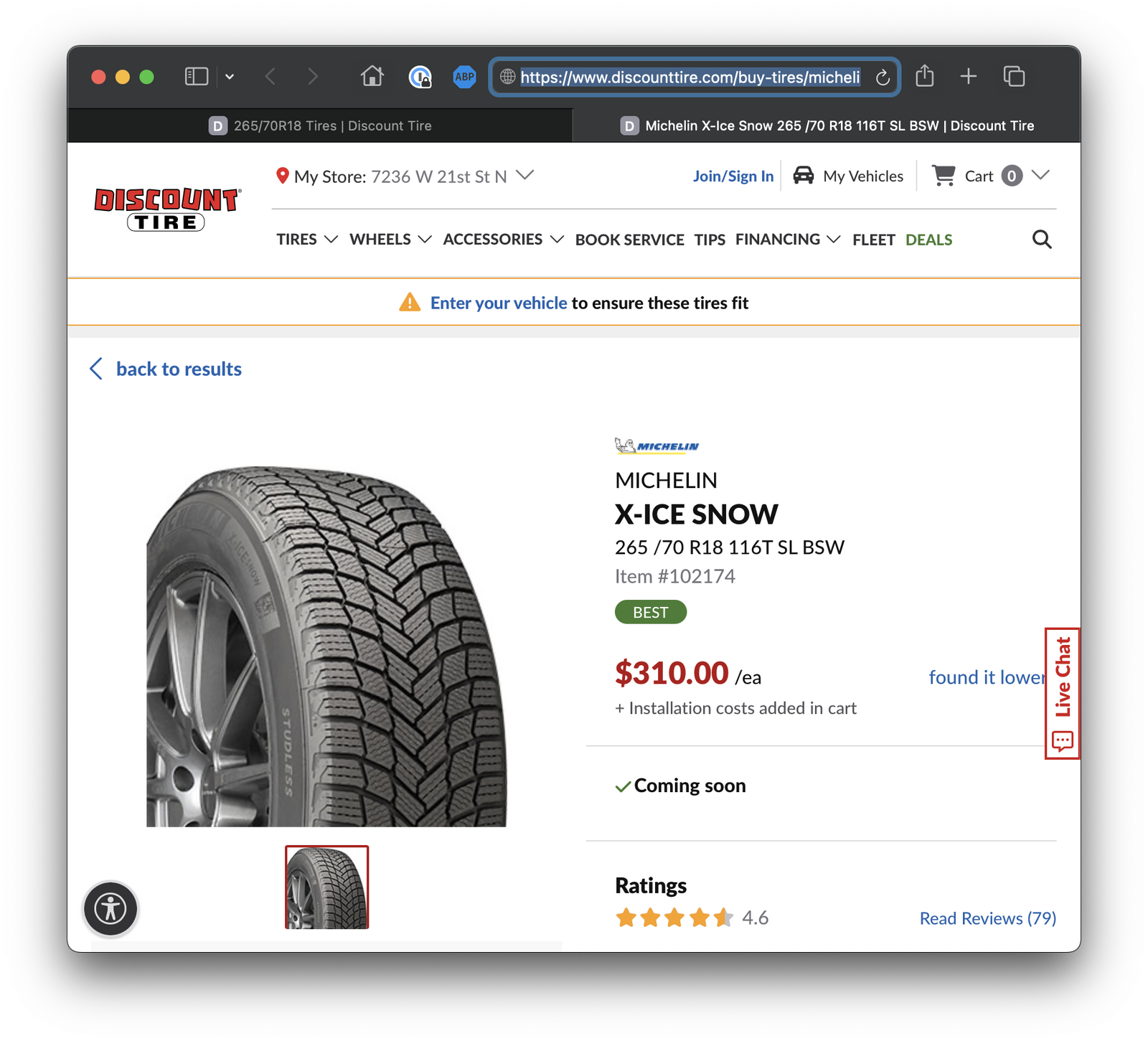

After a quick check, in 18" the Michelin X-Ice Snow and the Hankook Winter i Pike X are the only two winter tires I've come across that are standard load. I added them and a few other winter options to the spreadsheet.
I checked multiple sources including the Michelin website and the X-Ice SNOW is NOT offered in 265/70R-18. Can you confirm where you are getting your info? I do see the Hankook tire on their website (so I agree with that one).
Let's see if this link works:
Discount Tire | Tires and Wheels for Sale | Online & In-Person
Edit to add you're right, I can't find it on the Michelin web site. Hmm.
I have confirmed with my Michelin contact that these winter tires (X-Ice Snow, 265/70R-18) will be released in late 2024 (current ETA is 12/4/24). Those are the winter tires I plan to run on my LC grade. I just need to decide on a set of 18" winter wheels. I'm hoping someone makes a set of silver 18" steel wheels that will fit. We'll see.
