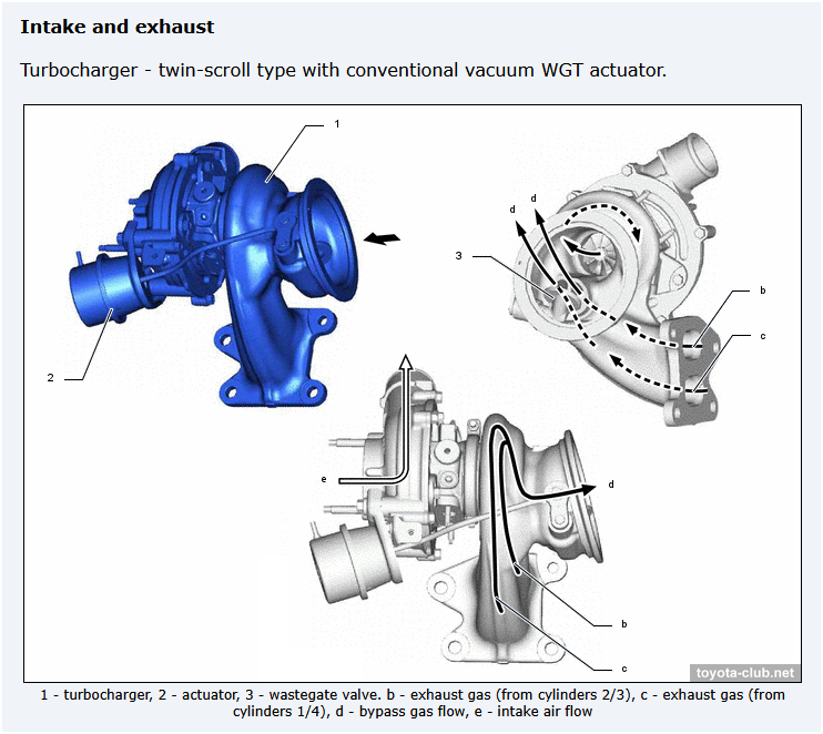

Not if the bypass is open
Re: electric pump

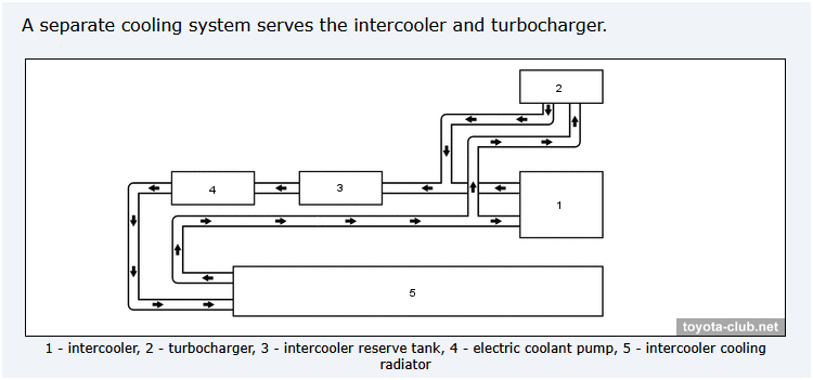

That isn’t the correct version of the T24A-FTS used in Toyota truck applications. We don’t have an air to liquid intercooler, ours are air to air.
That isn’t to say that the turbo isn’t on a dedicated cooling loop, but I don’t see a separate reservoir for one under hood like in say a Tundra.
Correct it’s always spinning even at idle. Turbine wheels are pretty sensitive to gas flow over the blades, and obviously something capable of spinning at 80,000 to 100,000 RPM has pretty low resistance to rotation.
Not to worry though everyone, if the engine is running oil and coolant are flowing through the appropriate passages and doing their thing in the turbo whether it’s under boost or not.
Last I checked the turbo runs on it's own electric coolant pump, aka cooling post-shutdown.
I thought I read, or heard that, somewhere… I guess I can put those worry beads back on the shelf.
Appreciate the correction and discussion.
I would like to see a detailed schematic breakdown of the truck application T24A-FTS. I am guessing it’s getting coolant pumped to it as well.
