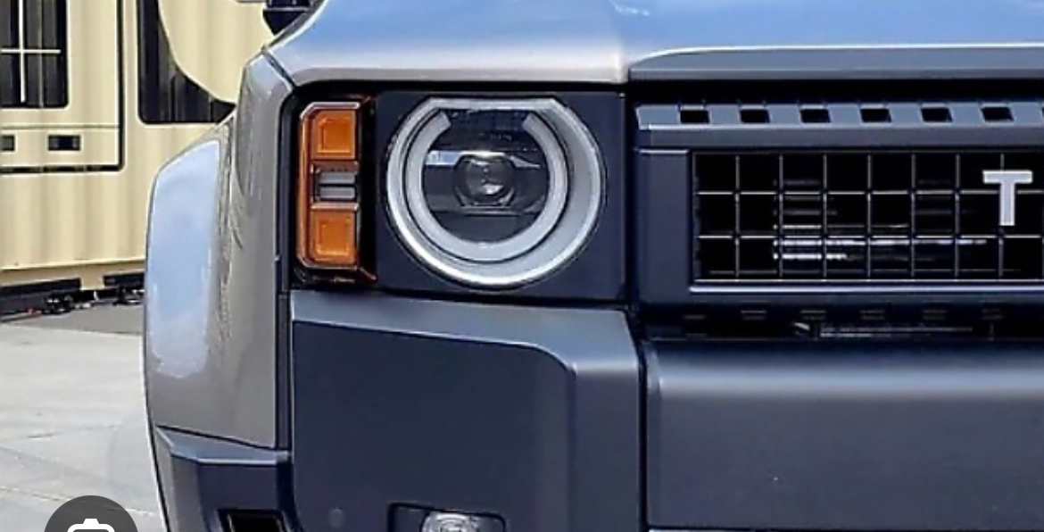

The person just phrased it as too dim but that could be too short of distance as well. If you look at the design of the round headlight, the LED does not go in a full circle and the top of the light is flat which is what is causing the pattern mentioned above. View attachment 4239
The only part of the light doing any work is the lens for the projector. Everything around it is just cosmetic fluff. It does have a cutoff built into the lens though.
