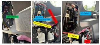

Having the battery in the back makes it really simple to add a 12v plug there. I drilled mine int he battery cover so I can easily remove it and replace the cheaper plastic bit if I want to erase the evidence later.
No idea, but I'm sure it isn't 20a. A 20a circuit is going to need some 12-14ga wire depending on the length of the run. I would guess it's setup for charging phones and ipads, maybe a paddleboard air pump, but not a compressor.
Do you have some pictures of that install? How much slack did you leave on the inside for when you remove the now-tethered plastic panel?
No pictures handy, but I used a 4' kit from Amazon., that was the shortest I could find.
You just need to drill a hole with a unibit to stick it through (I don't remember the exact size, but it was around 25mm/1").
I placed mine to the left, upper edge of the panel so it wouldn't collide with the battery and roughly mirrors the 120V outlet on the other side.
There was an empty terminal on the positive battery connector so the whole install maybe took 5 minutes and didn't require me disconnecting the battery. ymmv

If your not opposed to drill a hole...... I did notice that under the un-need third row arm rest, very near the 12v battery, on the underside, would be a good place to through mount a 12v outlet. Plenty of access from the rear to tighten the jam nut and a very short run to the battery. It would be hidden and out of the way when not in use.

If you take the lid off the pass side under hood fuse box there's a red cover, flip it up and that's the pos connection point for jumper cables.
You can purchase a "battery tender" pig tail from Amazon that you could hook directly to the battery and just leave it loose in the jack storage area.
If you gain access to the 12V battery you will see a hard plastic terminal/post cover, if you remove that cover there is an unused stud leading to the battery via a 100amp fuse (I think it's 100 amp) I think it's a M8 thread.
They sell on amazon short connectors that'll connect to the tender pig tail. They come in an 8" loop and you cut off and discard they end you don't need. I would cut the clips off the ViAir (leaving enough wire to splice on a new end (on the compressor side and clip side) that way you could reconnect the clips should you ever need to use it on another vehicle and the LC could be plugged directly into the compressor etc......... If you have any other 12 items you could add the connector etc......

Best I can do... You don't have to have a circuit breaker if you use an inline fuse.
