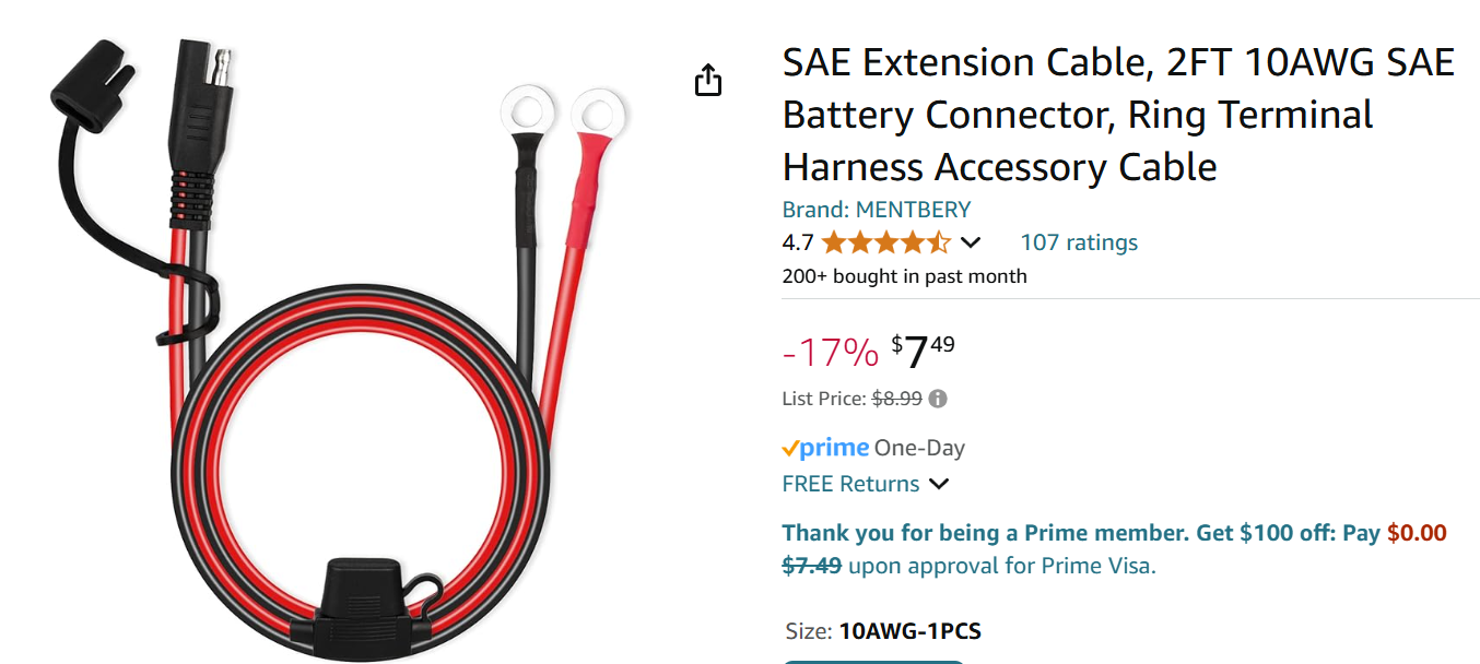

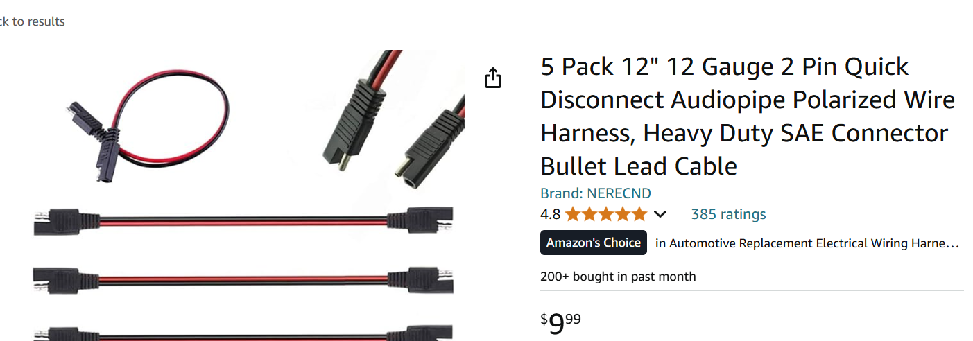

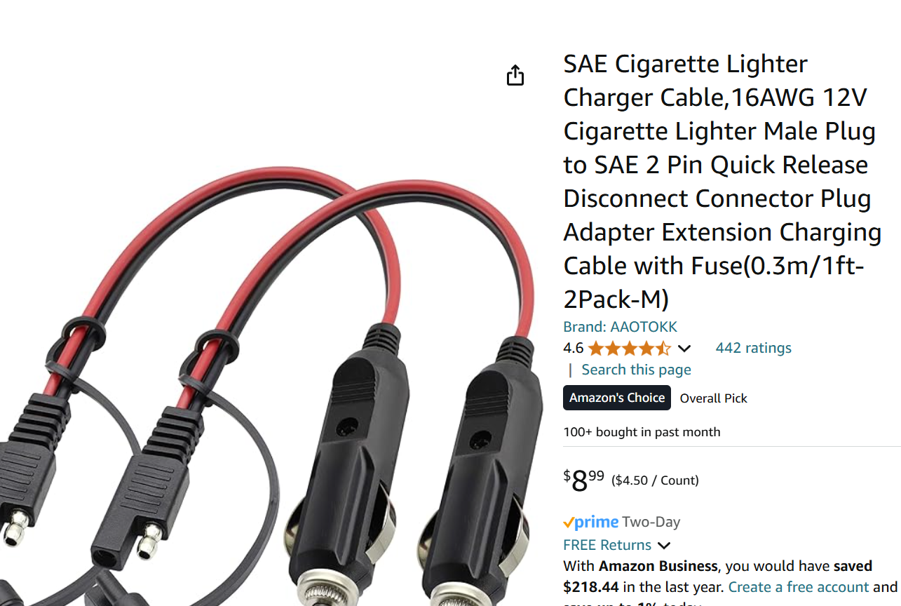

You might think about changing the plug on the fridge to something below. and with a battery tender lead, the fuse holder and ring terminals are already installed and with the 12v outlet plug you retain the versatility but the tender 2 pin connector will not shake out etc.... .
