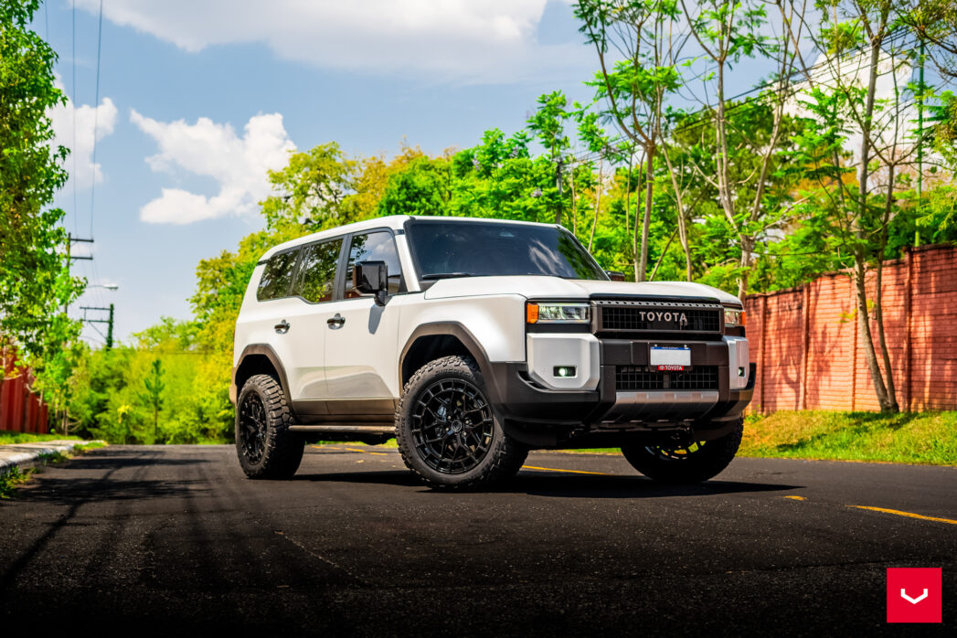

The LC comes with pretty conservative wheel offsets, and could definitely benefit from something a bit more aggressive.
Anyone else planning to swap out wheels once their LC shows up?
These are the first aftermarket wheels I’ve seen installed so far.
Vossen HFX-1 20x9.5 +15
Cooper Discoverer Rugged Trek 275/55/20

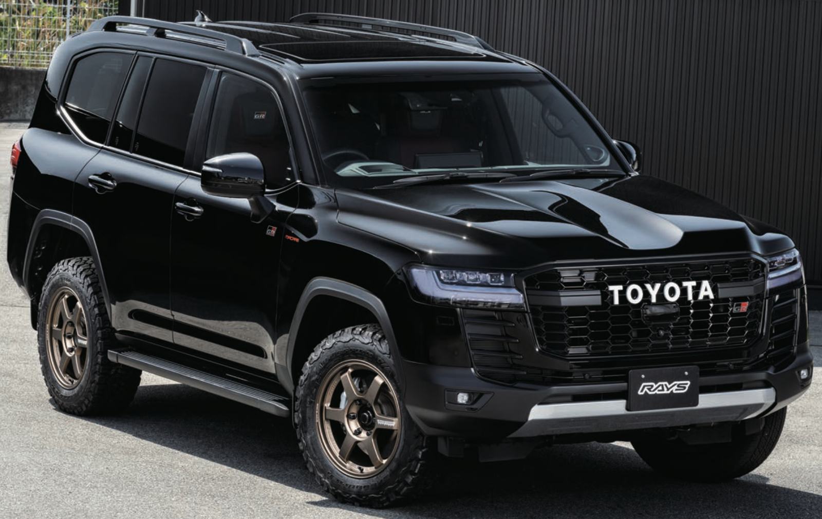

pretty much we can copy those 4th gen Tacoma aftermarket wheels, except those 17" because they don't clear Land Cruiser and Hybrid Tacoma brakes.
I agree the +60 offset on stock wheels is too conservative, I also don't want to poke out the fender, so I'll first play with spacers and determine the exact offset I want, and depending on that result maybe I'll get these in +45 size and tweak it with extended studs and spacers, or +20 without spacers if the poke is not ridiculous

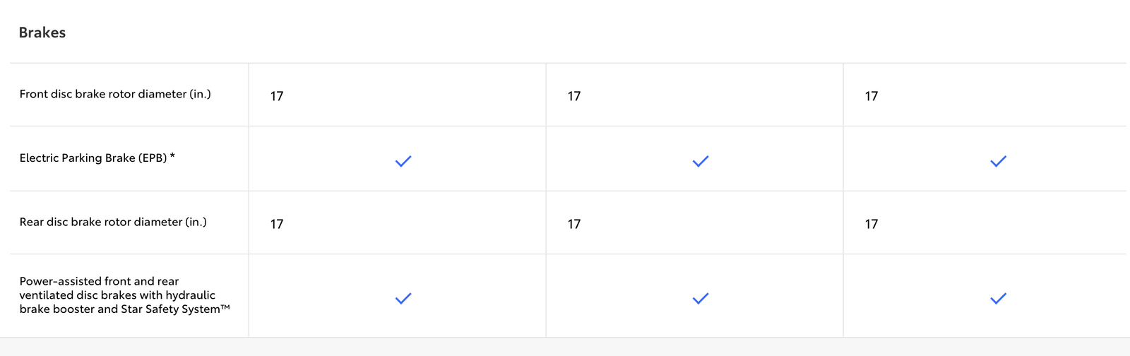

Already a few GX's posted with 17" wheels on them. I know some media outlets report 17" brake rotor, but thats wrong. GX550 has 13.9", we arent getting 3" bigger.
at 2:36
they spoke to Toyota and they are saying Tacoma hybrid and Land Cruiser can't use 17" because hybrids have larger rotors.
Toyota does in fact list the brake rotor diameter as 17", but they must be referring to the size of the entire assembly...or maybe it's just a typo.
A 17" rotor is massive and would be on par with something like the Lamborghini Urus. At this point we are talking 21-22" wheels and not 18s.
Agreed, no way a 17" rotor plus caliper plus added clearance would fit under an 18" wheel.

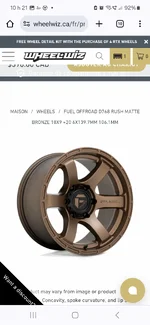

I really hope it fits well with 20 offset. I want to put 275 70 18 on those fuel.

That is a lot of poke for +15.
Any thoughts on desired offset to order to achieve just a little wider than fender if not in line?
It's also a 9.5" wide wheel whereas stock is 8", so overall this pushes the edge out 64mm compared to stock.
For comparison.
9" wide +15 would be 6mm less
8" wide +15 would be 19mm less
Vossen also has a 20x9 +18 version of this wheel which would be 9mm less. I don't think the 17 or 18" options they have with +0 offsets would be a good choice.
Yeah....no way these have 17 inch rotors. Urus and Audi RS6 have 17.6 inch rotor and those are the largest fitted to any production vehicle. They probably mean that the minimum clearance is 17 inches for the entire assembly.
