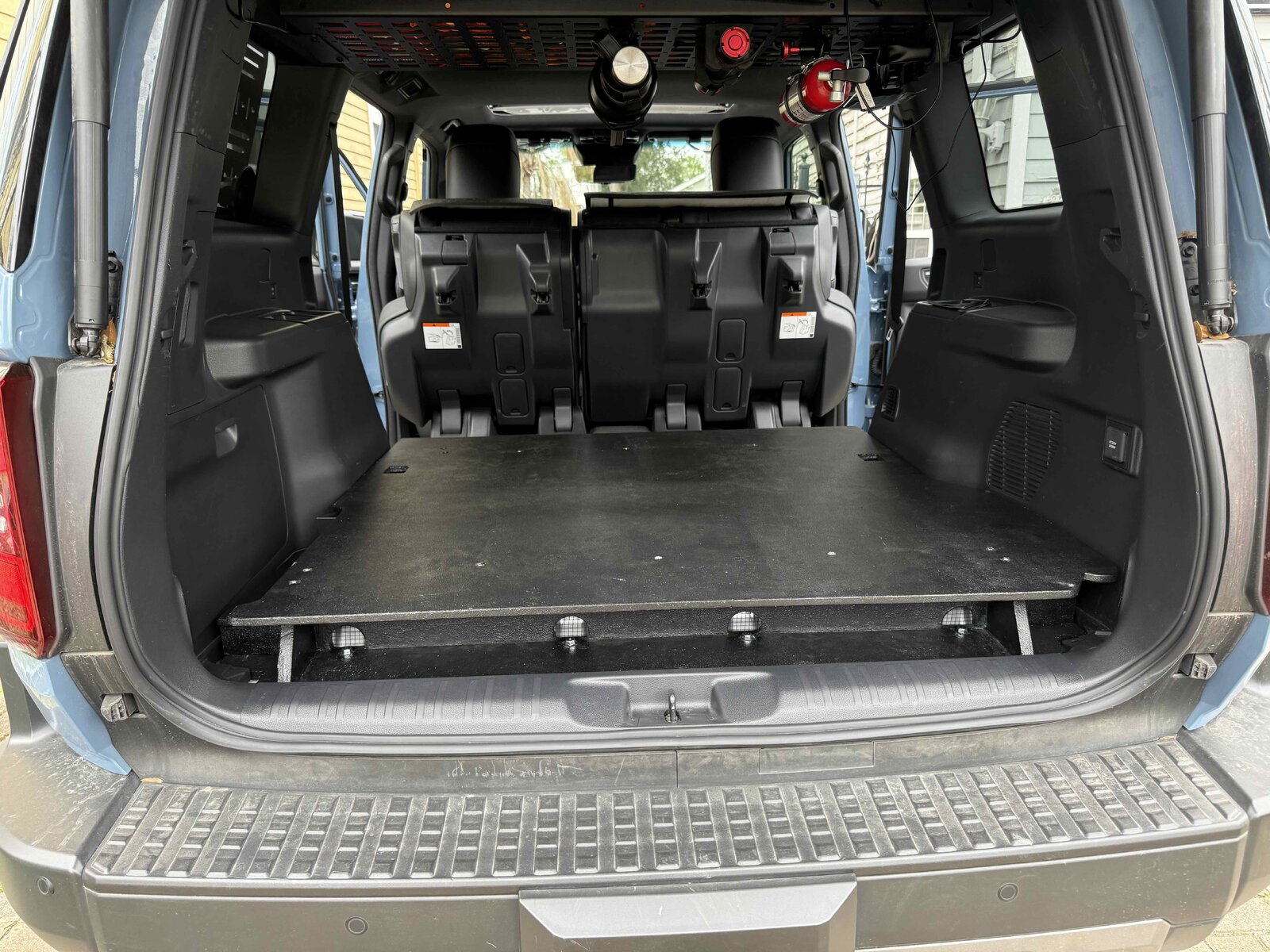

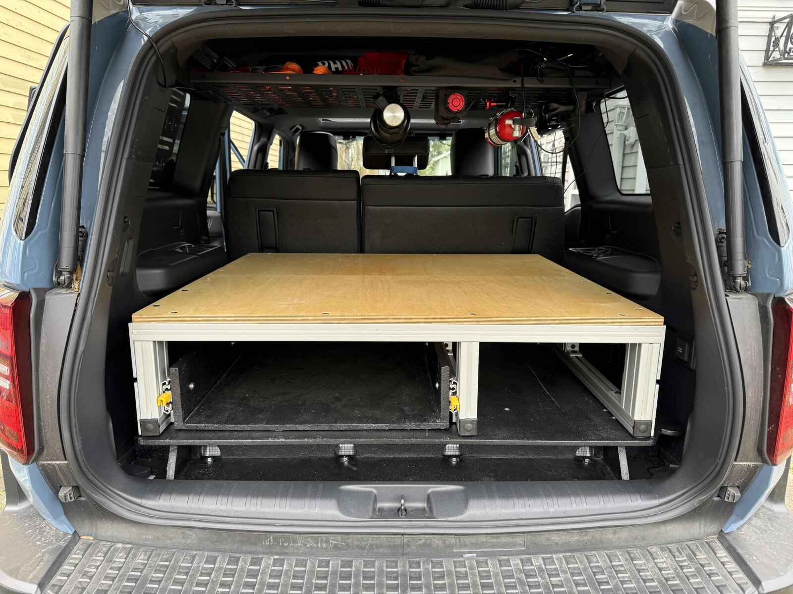

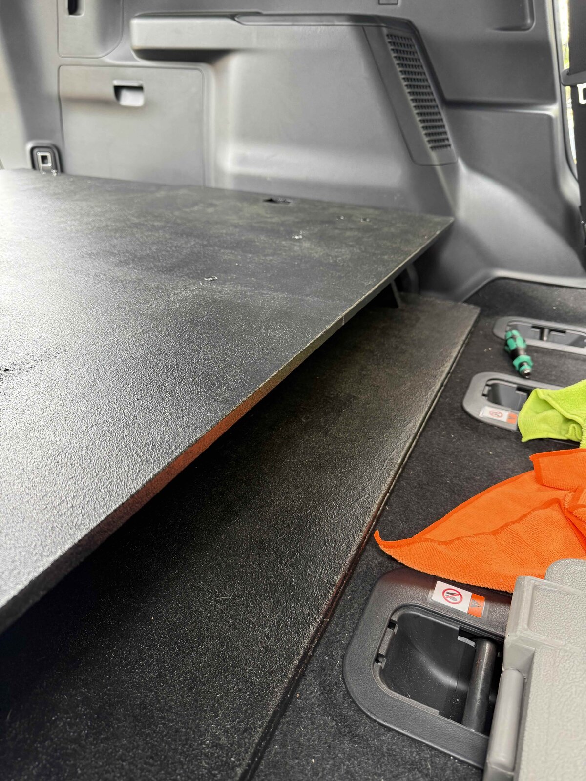

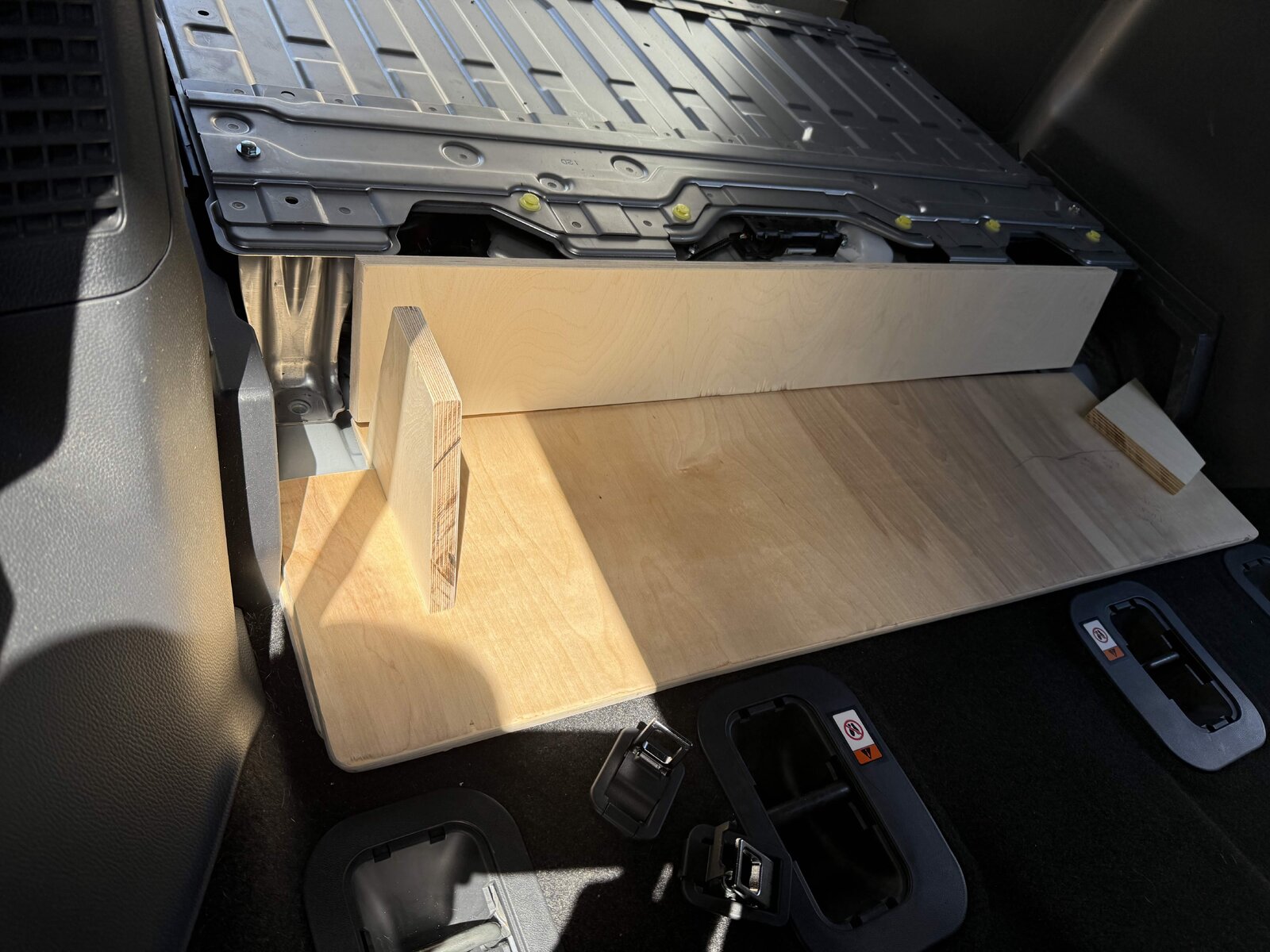

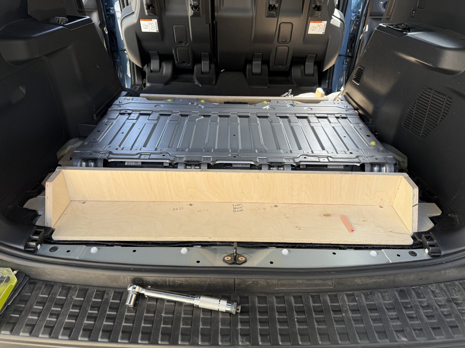

Measurements of the platform you fabricated?
For the factory floor replacement: I literally used the cargo mat as a template for the top (cargo floor) with one adjustment: a cut out 2 in deep and 16.75 in long in front of the battery compartment to allow for access. That mat is 43 in wide in the front, 50 in wide in the rear and 41 in deep with cotours starting as the wheel wells ending towards the rear. The front base (nearest the second row) is 43 long x 9.5 wide and the rear base (nearest the tailgate) is 43 long and 7 in wide. The two supports (front and Back) are 36 in long x 4.25 in tall. This boxes the hybrid battery in perfectly and leaves a floor gap on each side in the rear (below the battery compartment and opposite side) and for those I used foam core board to create templates and cut the wood accordingly.
For the actual cargo/sleep platform its 42 in wide by 38 in deep and 10.5 tall. This leaves the same gaps on the sides as the factory floor replacement but I wanted these as extra storage, otherwise I would've used the cargo mat as a template again for the plywood top. The wheel-well/cupholders are 11 in but rather than make it flush (since i wasn't contouring around the cupholders) I shave off a half inch to give my a tiny bit more vertical room since its also a sleep system. Thats also why its 38 in deep - I could've made it 39.5 (not the 41 in of the mat because the seats are angled and will hit the cargo platform after about 4 in of height) but I needed that 1.5 inches for supports to hold the sleep platform up to the 10.5 inch cargo platform. The front of the sleep platform rests on the folded seats and it levels because the 8020 extrusion, spacers, and 3/4 inch plywood equal the difference between the seat back when folded and the 10.5 in cargo platform.
If I were to do it again I would probably use 10 series 8020 extrusions rather than 15 series - save a little weight and add extra drawer space - because the 15 series is overkill - super strong but probably unnecessary to hold two people and a dog lying down.
