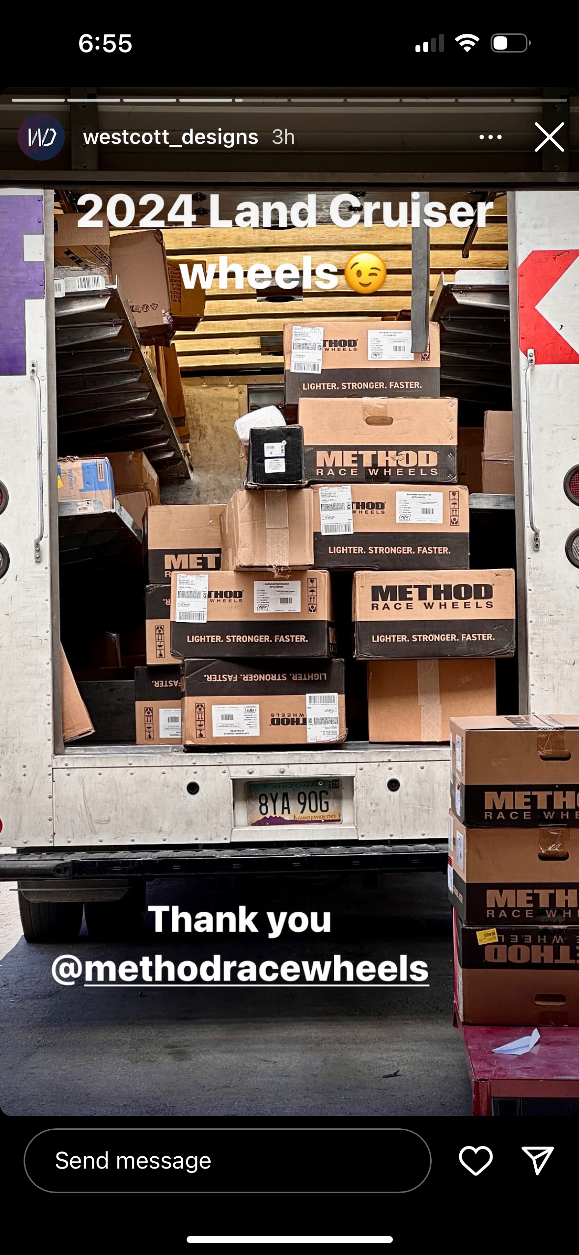

Westcott seems to be putting the 703s on all the Land Cruisers they are doing. I sent them a note on IG and this is what I got back.
I donโ€™t have the exact measurement but it has enough to clear the wheel weights. We had done at least 20 of them with the 17x8.5 methods and no problem
