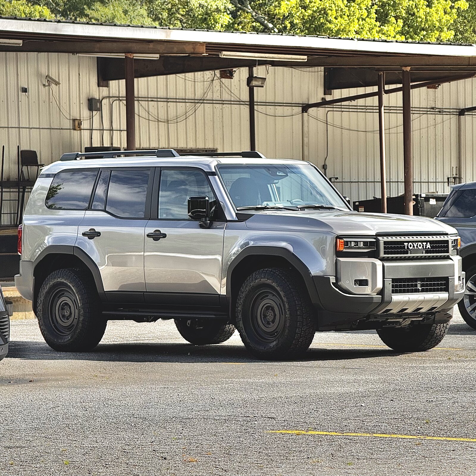

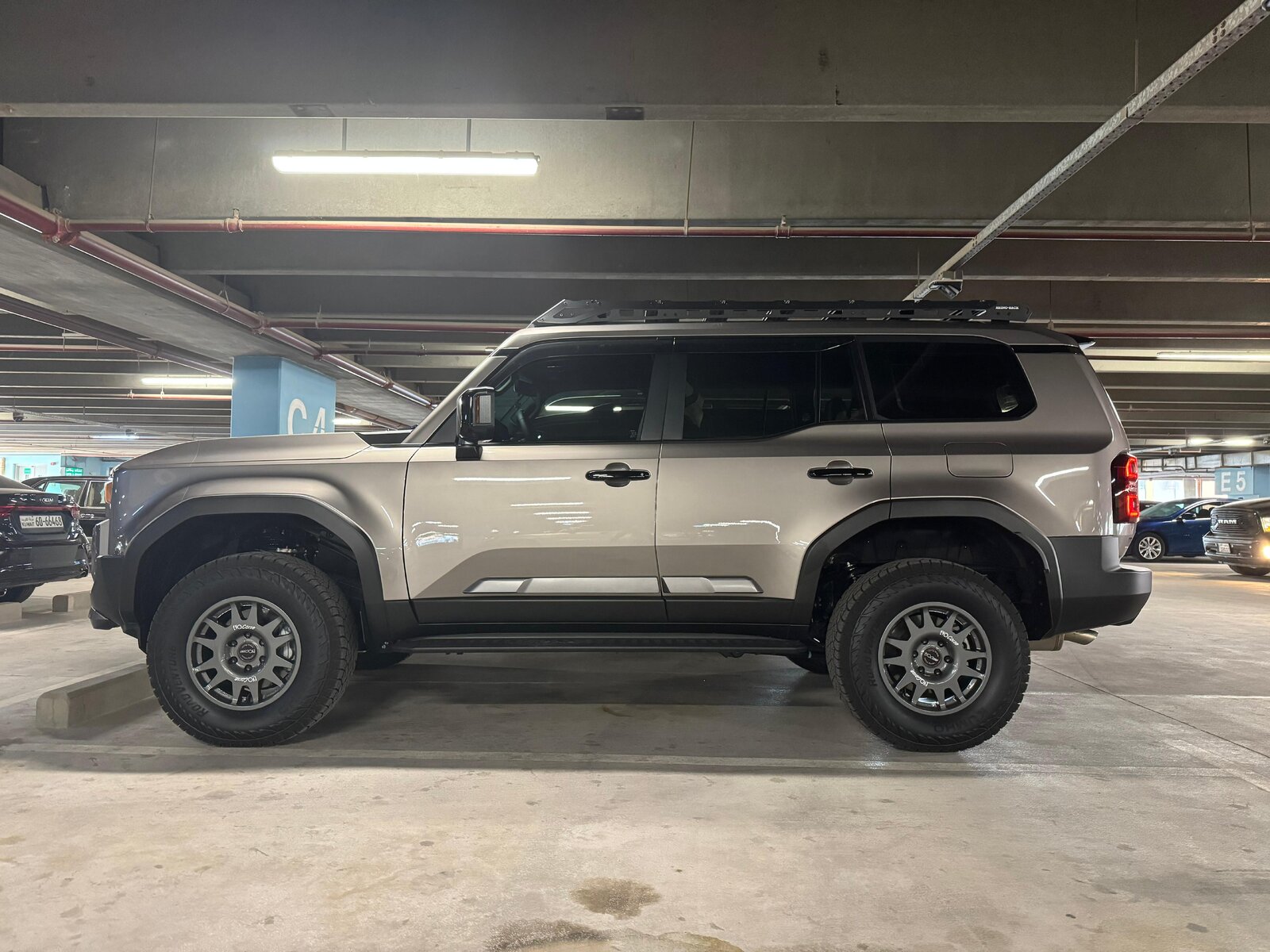

I am running the Mickey Thompson Baja standard,tires at 285/70/17. Method 304 wheels.They are 32.8 inches in diameter and drive like a dream since they are not LT rated. No lift necessary no rubbing issues.

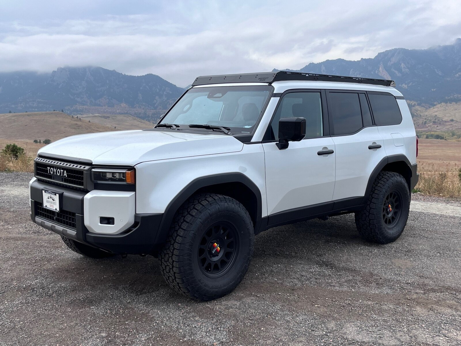

We are running Toyo Open Country RT Trail 35x12.5 on 17 inch Black Rhino AWOL Wheels. They are badass, we love em!! But they are E-Load so combined with the wheel they are heavier than stock and it does affect MPG. Capability wise, blows stock tires out the water. And I'd say surprisingly well manered/quite on road.

Those look great! but.. those center caps gotta go ;)
What did you do about the offset? Love your set up.
Completely stock suspension. Works great off-road as I get full articulation and no scrub. Mileage is averaging around 21.5. Wish it was C load but the extra sidewall gives a little relief. Way better than the E load stock size KO3s I had.
