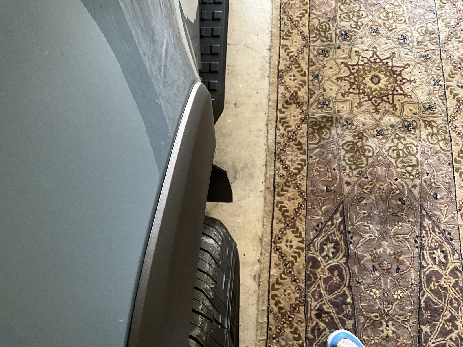

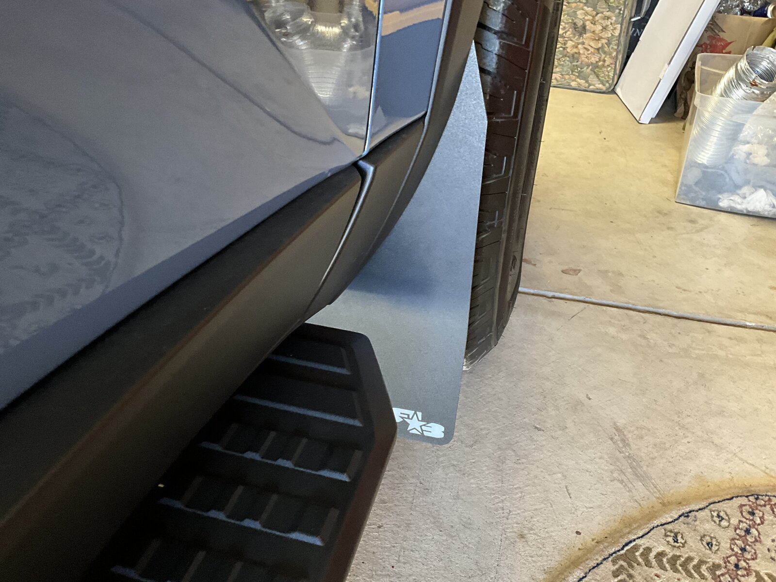

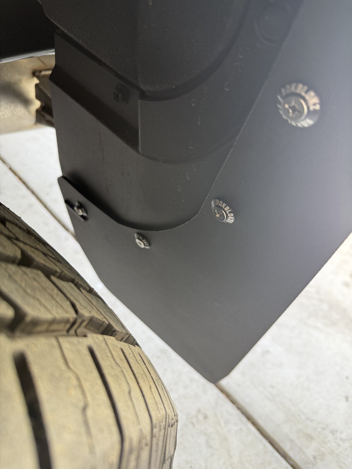

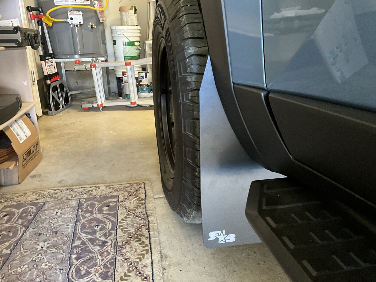

I installed Rokblokz XL mudflaps. Just on the front for now cause my back is jacked. After I recover, I’ll install the rears.
I’ll do a mini write up but they are fairly easy to install and the screw washers they use look really nicely finished with their name.
They are just wide enough for my +18 offset wheels/tires.

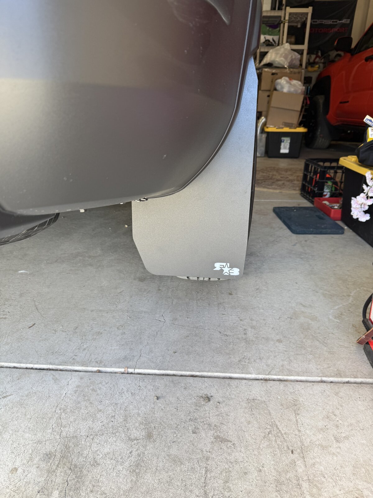

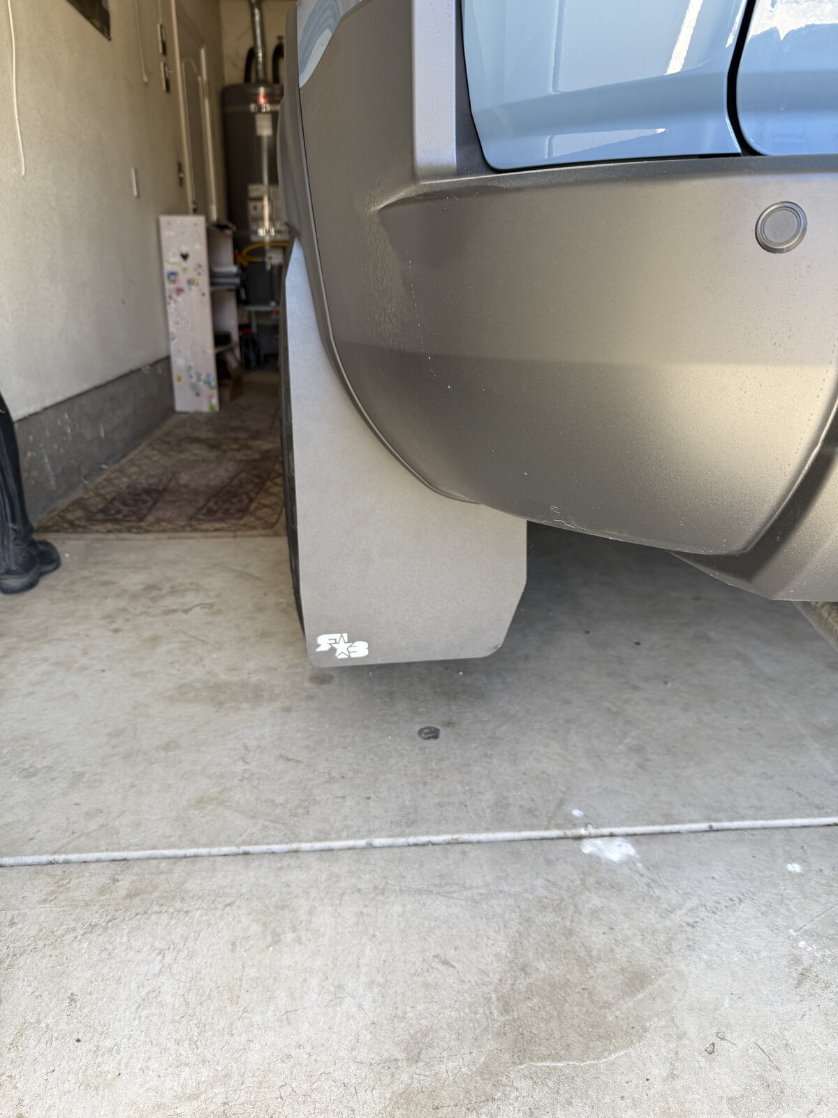

I decided to finish the Rokblokz install with the help of advil and flexeril.
Back are easier than the front by far.

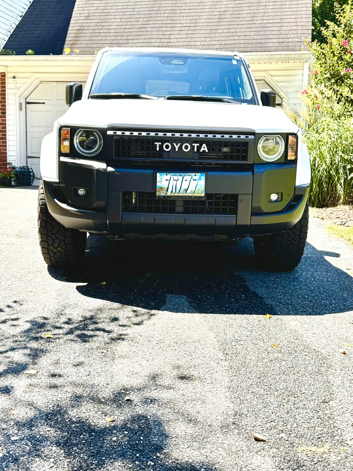

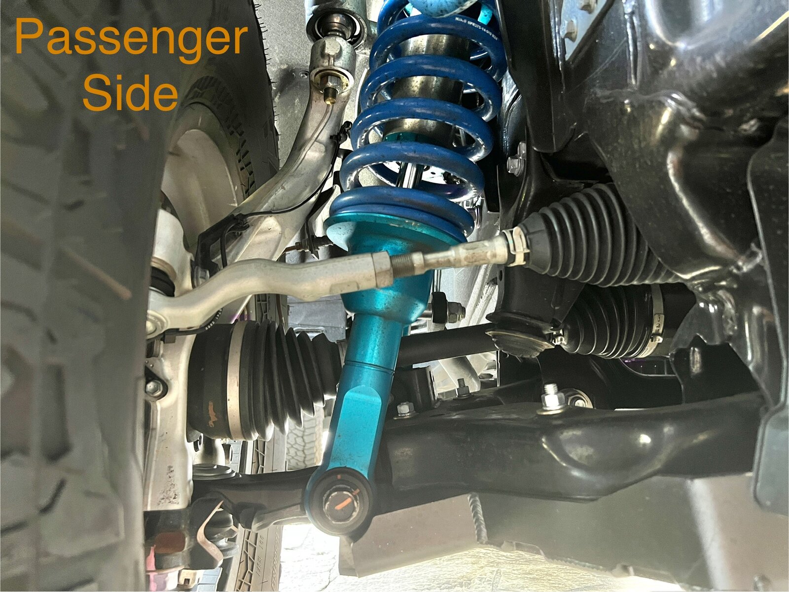

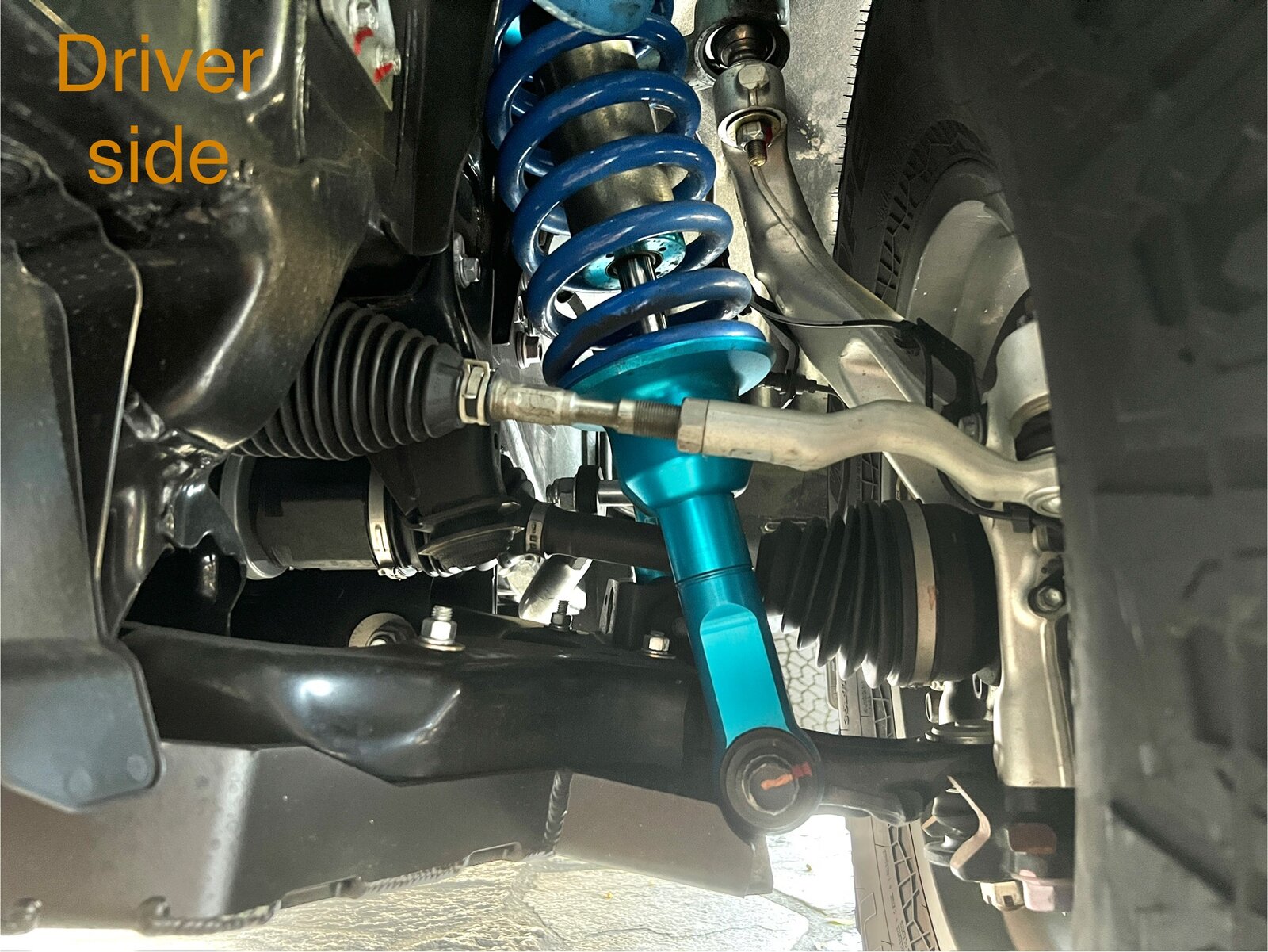

This is mine without diff drop (see photos)
2” rear lifted King Shocks+Dobinsons Springs (accommodated permanent up to 170lbs load)
front King Shocks+Total Chaos UCA: leveled to rear (probably 2.5-2.75” raised ?)

That looks like ride height, right?
What does it look like at full droop?
