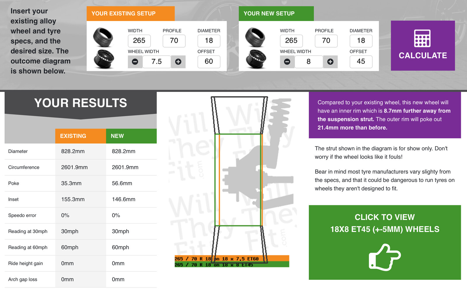

It’s about 4/5ths of an inch more poke than the Land Cruiser trim wheels (60 offset 7.5” vs. 45 offset 8”). Very close to the 50 offset wheels Toyota puts on the Lexus 550GX.
