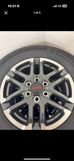

Any info on this set of wheels. Buddy of mine took them off his 2025 Tacoma. Figure they would look sweet on the LC but wasn’t looking for gross offset.
The 2025 Toyota Tacoma TRD Off-Road wheels have a +55 mm offset. This offset is for the 7.5-inch wide wheels that come standard on the TRD Off-Road trim.
Which is great if you are not looking for any poke. I have the TRD OffRoad wheels on mine with 34/10.5R17 Toyo AT3s and I am very happy with them. +50 offset would be perfect like the GX550 Overtrail wheels but the +55 offset is great because the inner side wall distance to control arm with the 285 metric width tire is the exact same as the 275 with the stock FE wheel so no worries about scrub. Here is what the +55 looks like with the 34/10.5R17 tires.
Sorry man, to dumb it down, I could run these wheels with 265/70/18 tires and not have any issue with rub?
Will the Tacoma TRD wheels fit the spare tire chain mount under the trunk?
It will fit depending on the tire size you run on your rig. If you are going to use the 265/70R18 tire that is stock size and will fit as intended. I have run 285/65R18 and they fit but the width makes the tire sit lower. People have run 275/70R18 and they work as well just barely but anything bigger will sit wonky.
