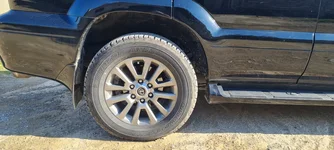

I have 18" rims from my previous vehicle Toyota Prado 150 with Dunlop tires on. I am willing to use them on my new Prado 250 . Feature a 6x139.7 mm bolt pattern, 7.5J rim width, and a +25mm to +30mm offset (ET) against +60 of stock rims. Will they fit?
