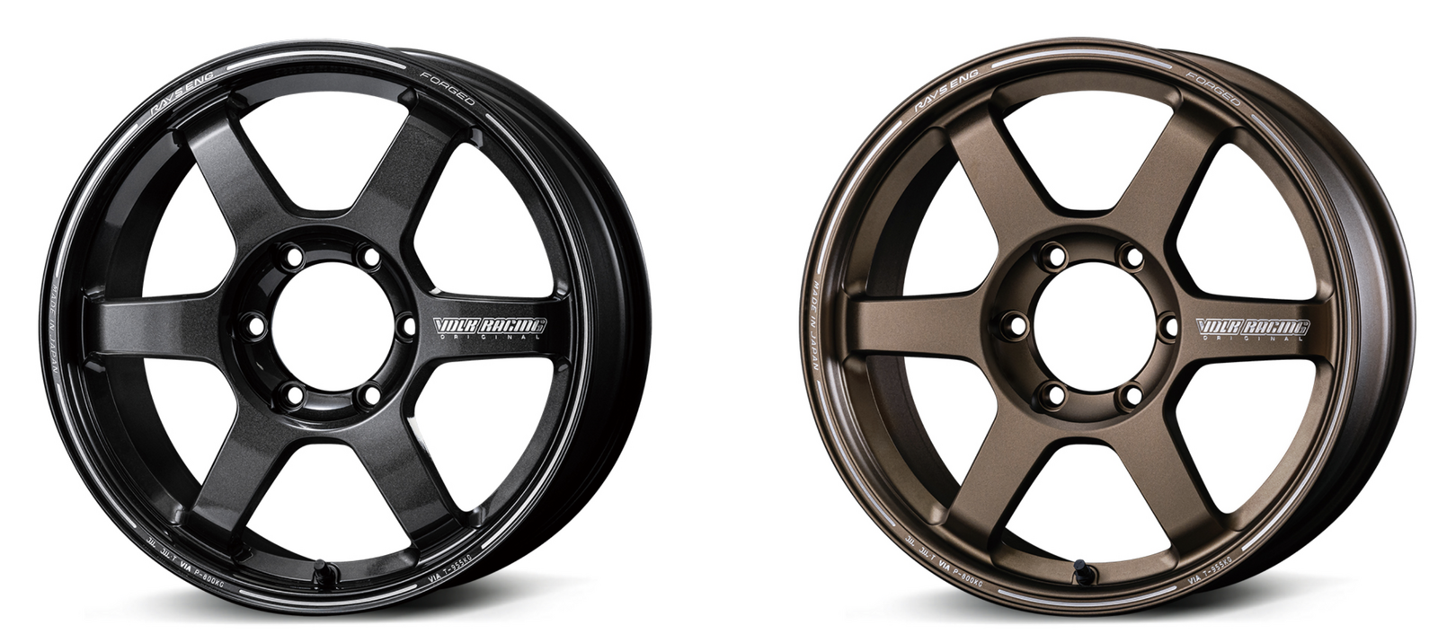

Totally agree with that, even the forged wheels on Morizo and Circuit Edition GR Corolla are still too heavy. I might just go with these at some point with the land cruiser after I figure out the best offset, I want them to be flush with the fender.
Not sure the Volks come in an offset that wont poke out... most are 0et
Canโ€™t go wrong with TE37s. I put a forged Apex VS-5RS on my GRC.
