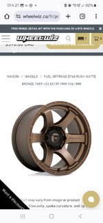

I like the wheels, i want to put those similar fuel wheels with 275 70 r18 but i'd like to see if they poke out too much with a 20mm offset.

Something like this from Fuel:
