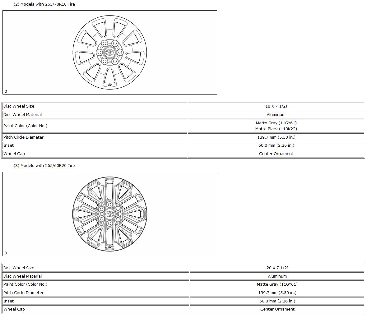

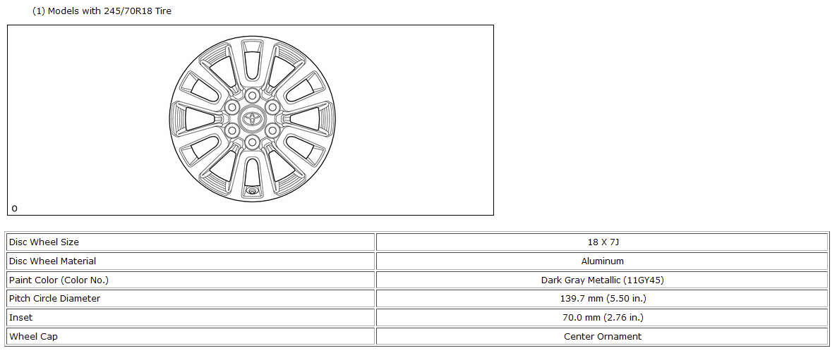

Stock Wheel offsets and tire sizes -

I believe listed in the images posted in Post #31, above.
I'm not seeing it, am I missing something?
I donโ€™t see it either. I purchased some 18โ€™s off a lc or fe from ebay and the part# wasnโ€™t listed there either. It may be a few more months before part #โ€™s are released.
Although itโ€™s probably stamped on the inside of the rim, donโ€™t know if you can order any yet.
Lookup Wheel, Disc ie......4261A-50073 (lexus wheel)
Is there any chance you know the weight of the 18" & 20" wheels shown above?
Indirectly we know the First Edition/Mid-trim 18" is about 27.3 lbs based on the Car and Driver flex test video where he weighed the tire & wheel, using the tire weight. I'd really like to know what the 20" weighs!

So if stock is 60 offset and I went with a method wheel with 25 offset, then the wheel would push the tire outwards by 45mm 35mm?
I dont want poke and Iโ€™d prefer to stay as close to stock size as possible but no one makes a wheel with a 60 offset from what i can seeโ€ฆ at least not method, fuel or black rhino โ€ฆ they are mostly in the 10-25 range.
Whats a safe offset if i wanted to keep the tire as much under the fender as possible?
So if stock is 60 offset and I went with a method wheel with 25 offset, then the wheel would push the tire outwards by 45mm?
40-45
Your poke will also increase by any additional width compared to stock
I assume you meant 35mm outwards (60-25 = 35), and yes, that is correct. As @thomez has pointed out, any additional width of your new wheel (stock are 7 and 7.5" wide) and new tires could push the tires out a bit more as well.
Icon has some that are 40MM offset. If you search the Discount Tire site by offset, you can find many wheels that have an offset of 50MM or greater. I can't speak to the quality or whether they are appropriate for an offroad SUV but they are there.
Icon Suspension made a tire fit video for the new LC.
Thatโ€™s really helpful. If you go to a 40mm offset wheel a 285/70R18 fits fine (except for in the spare location). If you push to 25mm offset, youโ€™ll have problems.
