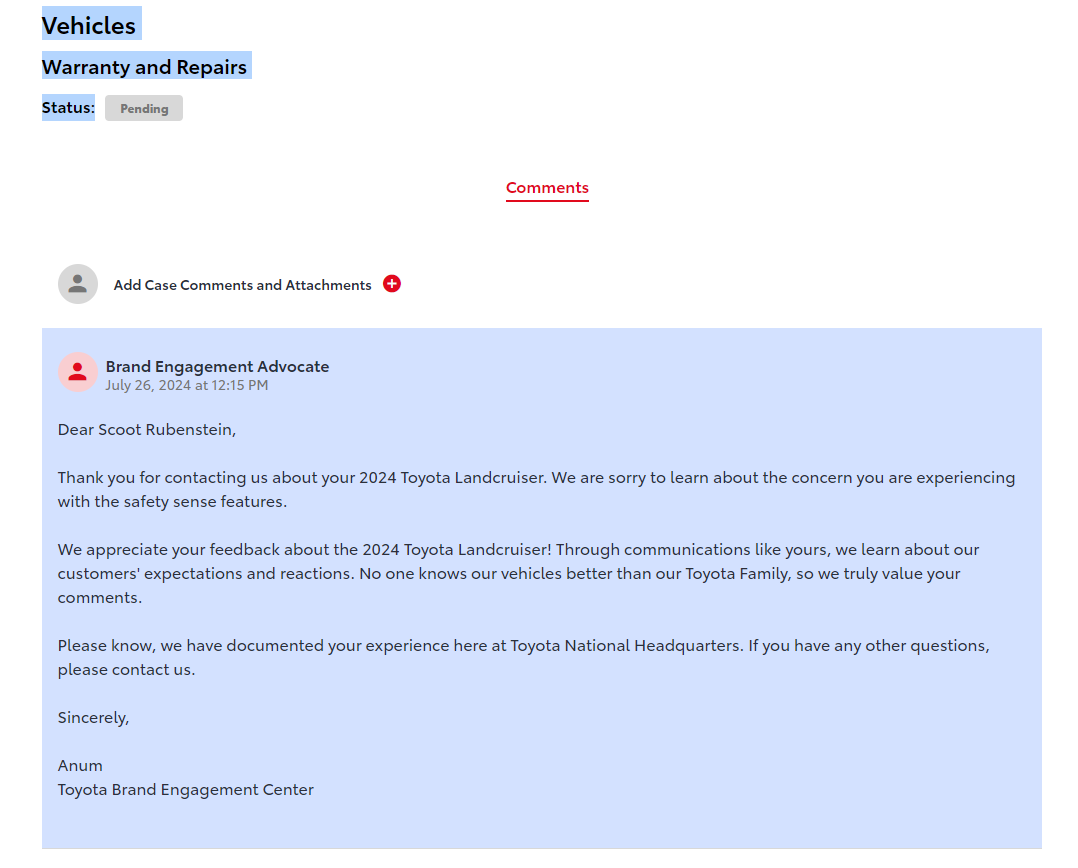

FYI - sent a note to Toyota and this is response I got:
