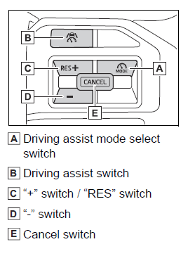

In my 1st days of ownership, I had something similar happen. I don't know if yours is the same .............
While messing with the Steering wheel cruise control buttons, I didn't notice that I had inadvertently changed the Cruise/PDA/something settings. Figured out what I did and played with the settings till it all started working again....... If I remember correctly, it was the "A" or "B" switches. When you press them the "Cruise" icon changes etc...... It was not the "following" distance. I apologize for the confusing post, but I truly don't remember what buttons I pushed/changed. All I remember that when I pressed the "A" button (I think) the cruise icon on the dash display, changed (like it subtracted part of the icon).
