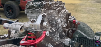

This pic shows the new Tacoma non hybrid iForce I4 has a spin on vs cartridge oil filter. Will be interesting to see if it’s the same on LC iForce Max hybrid.

I expect the oil filter will be in the same location on the LC250. We'll get the sepentine belt driven water pump as well. Hopefully we will get the back-up 12v starter like the Tundra hybrid; I have not been able to confirm yet.

How do we feel about the filter mounted directly on the oil cooler? Haven’t seen this on a Toyota or any other car for that matter. I’m loving the simple yet nifty little molded in “funnel” that routes filter oil drainage without it running through a labyrinth of passage ways! Looking at you Bronco 2.3…
It seems the benefit may be keeping the oil cooler as clean as possible without periodic flushing. I like the funnel as well. I can't think of a similar application of an oil filter installation on the oil cooler.
