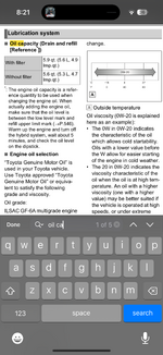

Oil capacity is 5.9q or 5.6L when changing the filter.

I noticed the oil level from factory was a bit high than the max on the stick
anyone else noticed it ?
The oil filter wrench/socket thing is the last part I'm waiting to arrive before I do the oil change.
Mine was right at the high mark, if not a little above from factory.
Didn’t check close when I got it, but I bet it was a touch high. Post first oil change, I “think” I am reading a bit high on the stick. Probably due to trying to gauge that exact 0.9 quarts when I poured in the 6th bottle.
