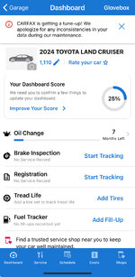

If you do these yourself at any point save your receipt and log ur mileage on it and keep in ur car- u would want to show maintenance done- either for a future buyer that’s wanting service records and they can’t find them, if u decide to sell or more importantly perhaps not voiding the warranty-
** obviously the reciept that shows ur oil and filter purchase
I keep all receipts, and a log book.. just in case it has to hold up in court someday. The Magnuson-Moss Act protects us.
That’s rt, gotta keep the receipts and log to protect/prove ur car care
