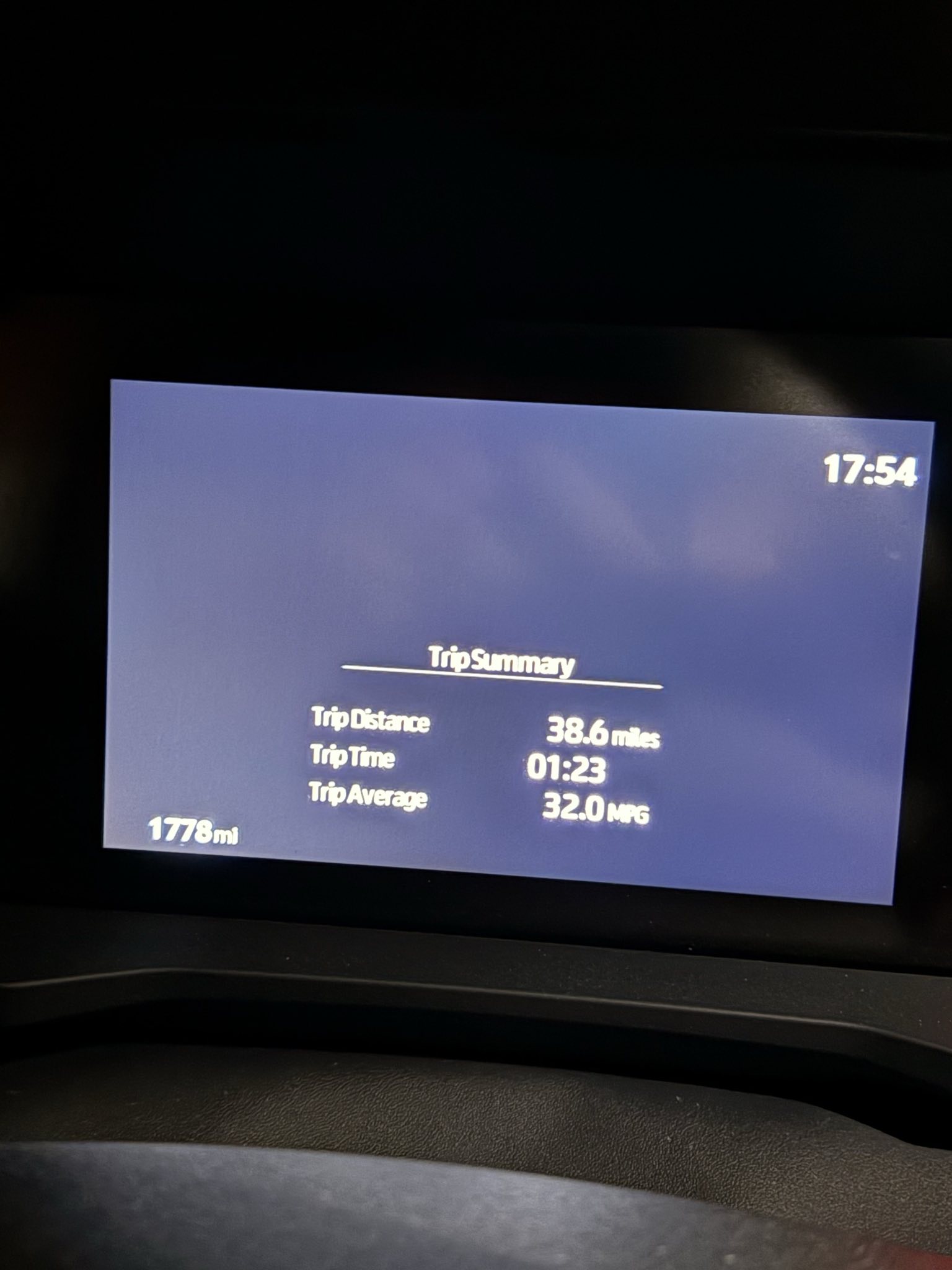

Not buying it from car and driver. I can get 29 MPG highway cruising at 65 MPH. Doubt the GX can do it.
The LC iforce max hybrid is a fantastic drive train if you know how to use it. Then you can just take the GX MPG and add +8 MPG.
There are many sources in this forum and beyond that discuss how to achieve it.
