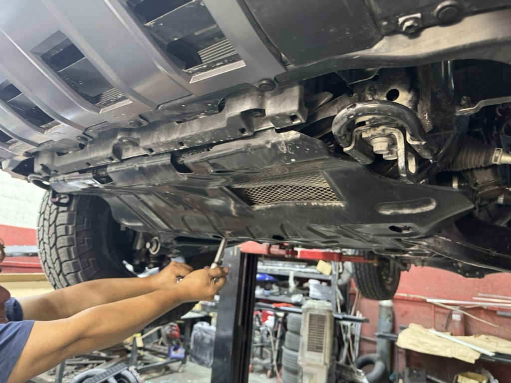

Nice. Let me know if you're interested in skid plates. Can DM you details. Got a local garage to design me custom 8mm aluminum engine + transmission skids, with steel reinforcement for the vulnerable radiator bracket. Getting them installed next week. Been on edge about busting up the radiator every time I've been on the dunes. She's held up well so far but stock "skid" has been trashed :) Can't believe they put that soda can on the top trim for us.

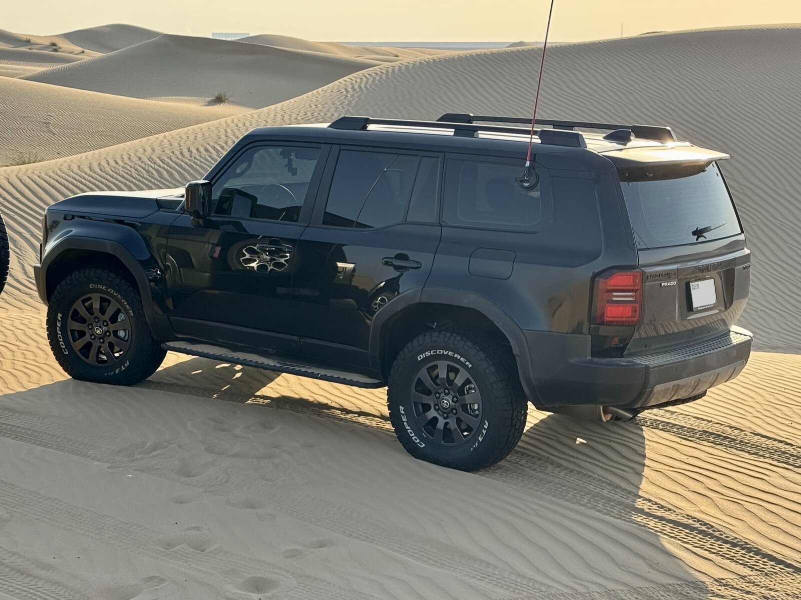

Can I ask about that antenna and mount? Is it for a a handheld radio and if so, where did you get it?
That's a flag, for safety and visibility while out on the dunes. I was temporarily using this suction mount, but have since replaced it with a permanent mount point attached to the roof rails.
That’s very cool and makes perfect sense if you’re out playing in the dunes. Thanks for the reply!
