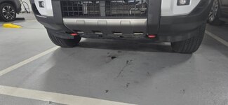

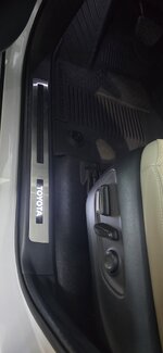

I had a problem with the way the car looked from the back. I got and exhaust from NYTOP made from titanium, the sound is amazing and removed the spare tyre. Also installed the gas struts for the bonnet. Light door sils and rubber floor mats. Red recovery hooks. If you are interested... let me know

Nice. Let me know if you're interested in skid plates. Can DM you details. Got a local garage to design me custom 8mm aluminum engine + transmission skids, with steel reinforcement for the vulnerable radiator bracket. Getting them installed next week. Been on edge about busting up the radiator every time I've been on the dunes. She's held up well so far but stock "skid" has been trashed :) Can't believe they put that soda can on the top trim for us.

The mats are original/ OEM Toyota from the states, eBay.
Here is the link: Security Measure
I already bought this one also from NYTOP 2024-Current Toyota Land Cruiser Skid Plate Assembly — NYTOP | Not Your Typical Original Parts
These are the door sills: NEW OEM 2024 TOYOTA LANDCRUISER HV ILLUMINATED STAINLESS STEEL DOOR SILLS 4PC | eBay
There's a part number for a front skid plates, OEM Toyota, not 100% sure it fits the Prado PT228-60242

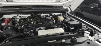

are the lc250 in uae hybrid like in usa? if it is will that snorkle work, im also interested
The UAE versions are 2.4 Turbo, non hybrid. The engine is the same one. I just ordered one snorkel from Australia and I should get by the end of the month. The air filter feeds into the right wing over the wheel arch. I will have to take those parts off the vehicle and cut the body panel. The Australian version is the only one that I saw for now that comes with a precut panel covered by black plastic cap (sold by Chinese suppliers as a glue on ornament).
How did you order it in Australia? I contacted them already and they won't ship to USA. I like to have one but not sure if it will work on hybrid engine.
I guarantee that it is going to be (90%) a similar installation to any of the last generation Prado (ASIA & MENA)
Your air filter is in the same position (all petrol/gas models), hybrid and non-hybrid.
I will film the installation once I get the part from Australia.
  • toyota-prado-250-hybrid-2-4l-engine-model-year-2024-color-black-1727633846.webp
