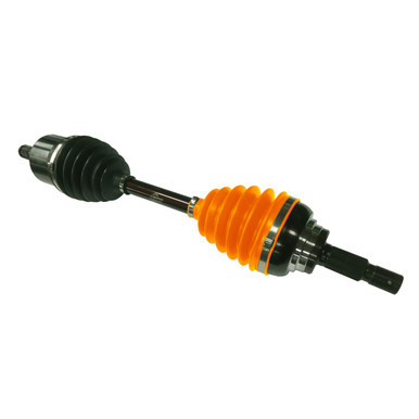

RCV axle set ~$2500
CVJIFS-TOY10

RCV Ultimate IFS CV Axles for Toyota Tundra are the Ultimate solution for those needing increased strength and higher angles for lifted suspensions. Using the same technology as our desert racing IFS use, these axles are designed to handle any type of abuse.
